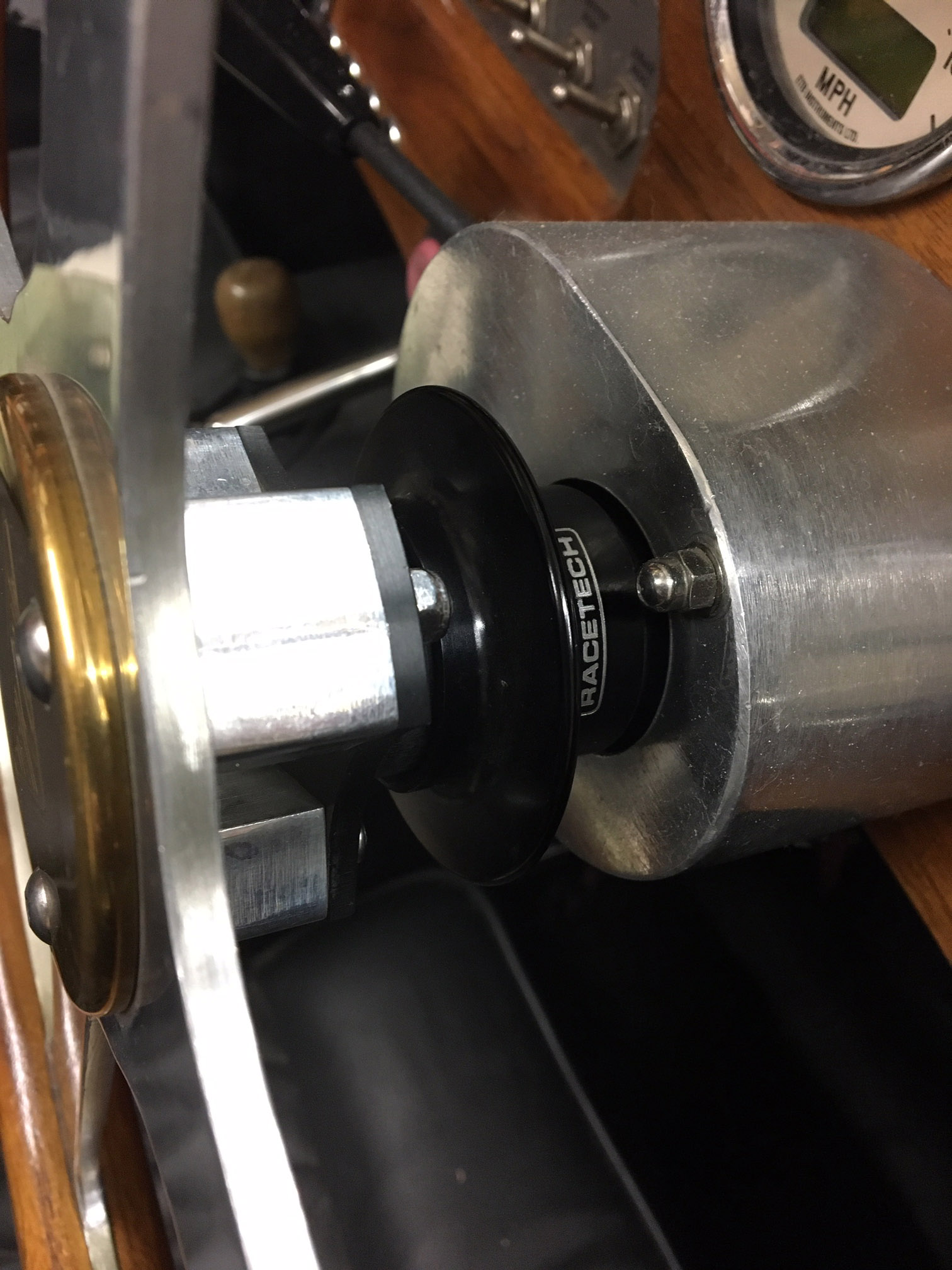

Mine, supplied by Al, has 1mm of play measured on the wheel rim. Nowt wrong with that.
With the standard flat steering wheel, I did find my gloved hands were too close to switches and cockpit roll so made up some 20mm ally spacers. Kept the indicator switch in the original position.
