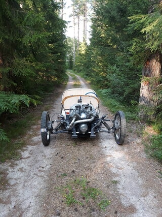

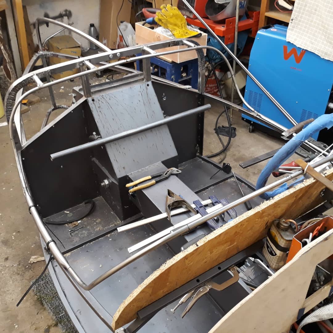

A small step forvard and one backward. Took some electrical tubes and made a sketch of how the frame could be made.
It definetly needs some adjustments before i am satisfied with the lines but it feels like a good start.
I could not resist a little test drive. Lets say the gravel road at home is not optimal, all wheels loose grip all the time. :D
There is sadly a terrible knocking from the engine, probably the valves. Anybody got similar noices?
https://youtu.be/hVNXQ0ppOL4
(The 2x45 -> 48 mm exhaust gives a really nice sound but i think i will have to soften it a bit more to pass inspection and keep whats left of my hearing)

Posts: 90
Re: Build tread (kind of)
Post by Spaniard » Fri Aug 06, 2021 5:13 pm
I did watch your Youtube video but its hard to tell from there. It seems the louder knocking that is present is not engine RPM based and more ground speed based. Moto Guzzi do have some valve noise but nothing like what is heard in the video. Sounds like its maybe a driveshaft u-joint rubbing somewhere.
Berglind
Posts: 56
Location: Vaxjo, Sweden
Post by Berglind » Sat Aug 07, 2021 2:44 pm
Thank you!
There was a rubbing between the drive shaft and a piece of alu sheet that has been fixed. The knocking from the engine sounds completely different in real life. I have ordered a valve recall kit since it seems like most guzzi-knowers recommend it to be fixed. It would be a bit of a bummer of the engine fails when i finally can start driving it. :?

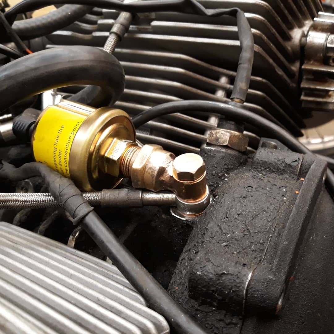

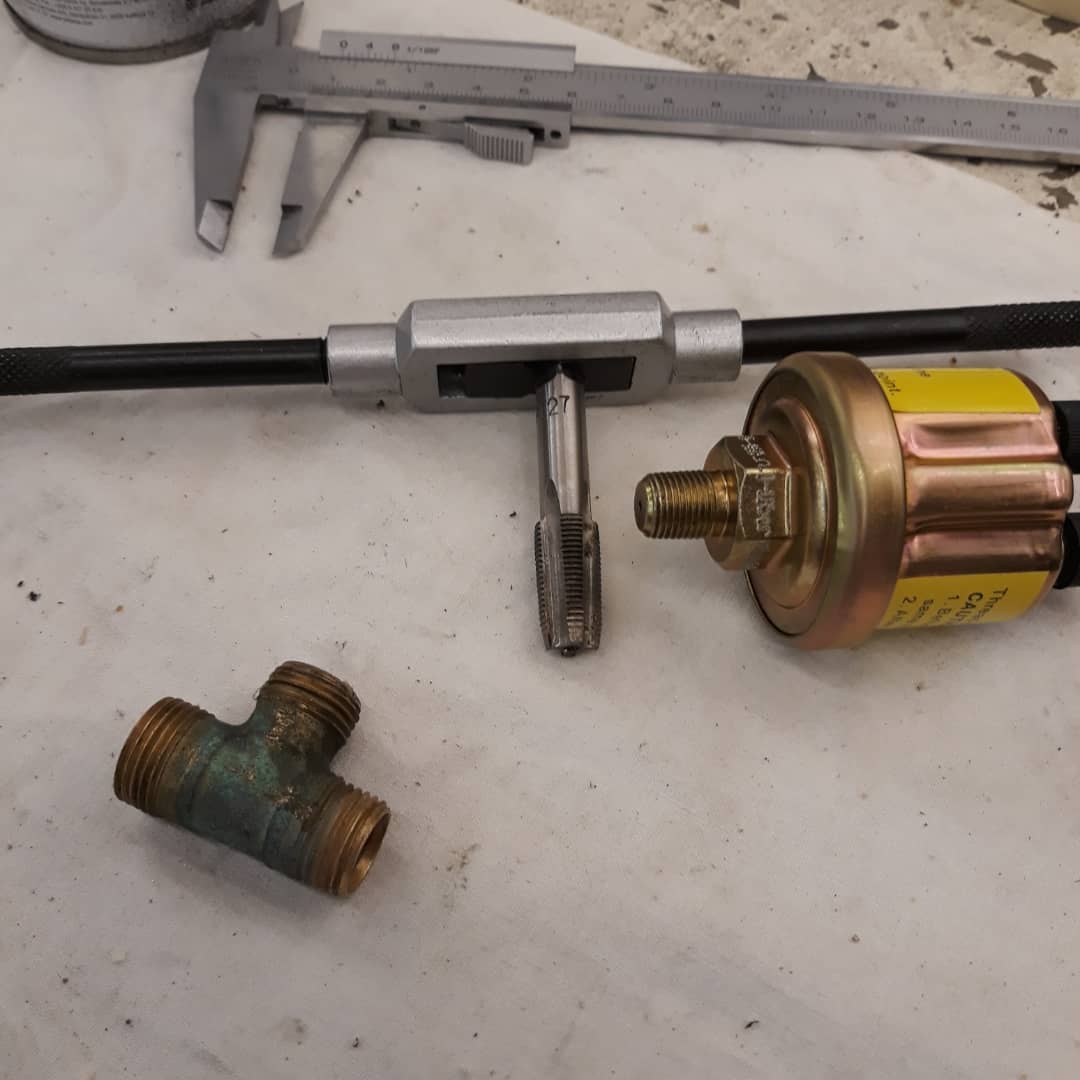

Post by Berglind » Sun Aug 08, 2021 11:16 am
I wanted a oil pressure meter but i'm too cheap to buy the kit from Stein dinse (14 e! for a banjo bolt) so i made my own as usual. Started with a left over coupling, brazed on a bit and threaded with 1/8 npt.
Fitted.
And then covered it all up.
I finally took curage to open up the oil sump but there was none of the glitter of sadness that i feared. Will change the oil filter even if it looked new and has ordered a recall kit that will come in a month.

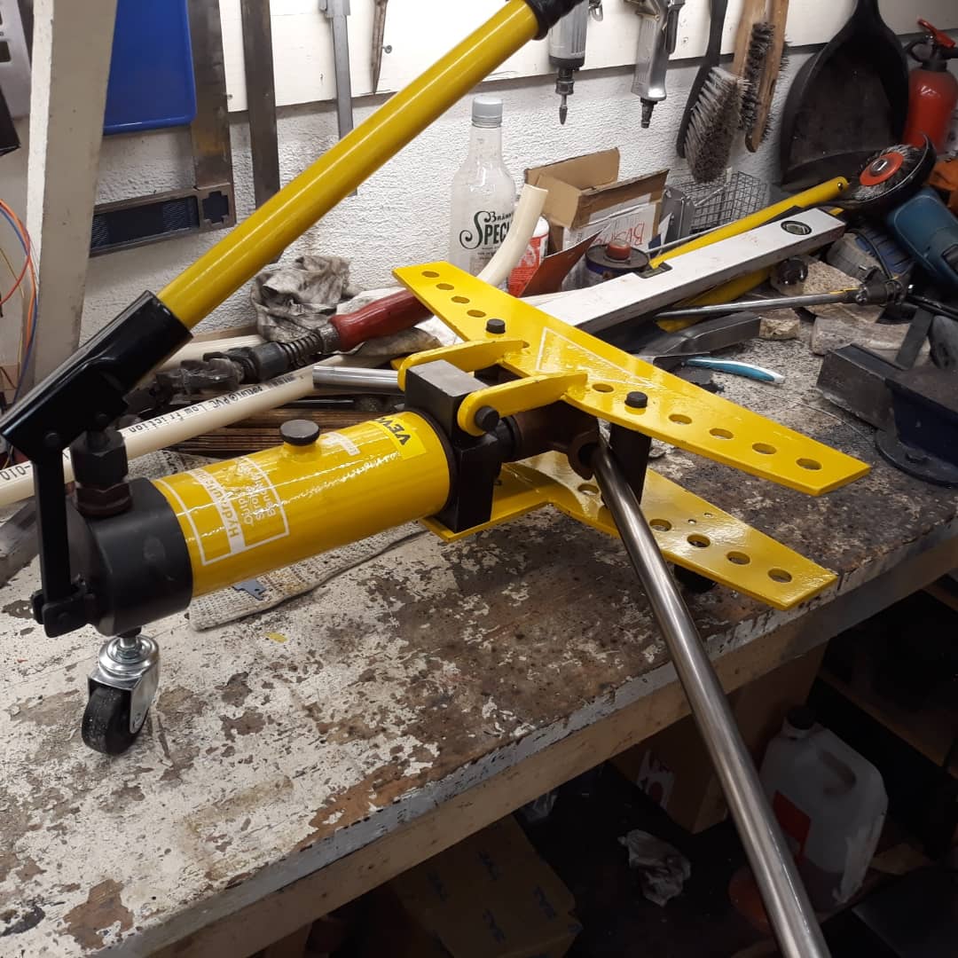

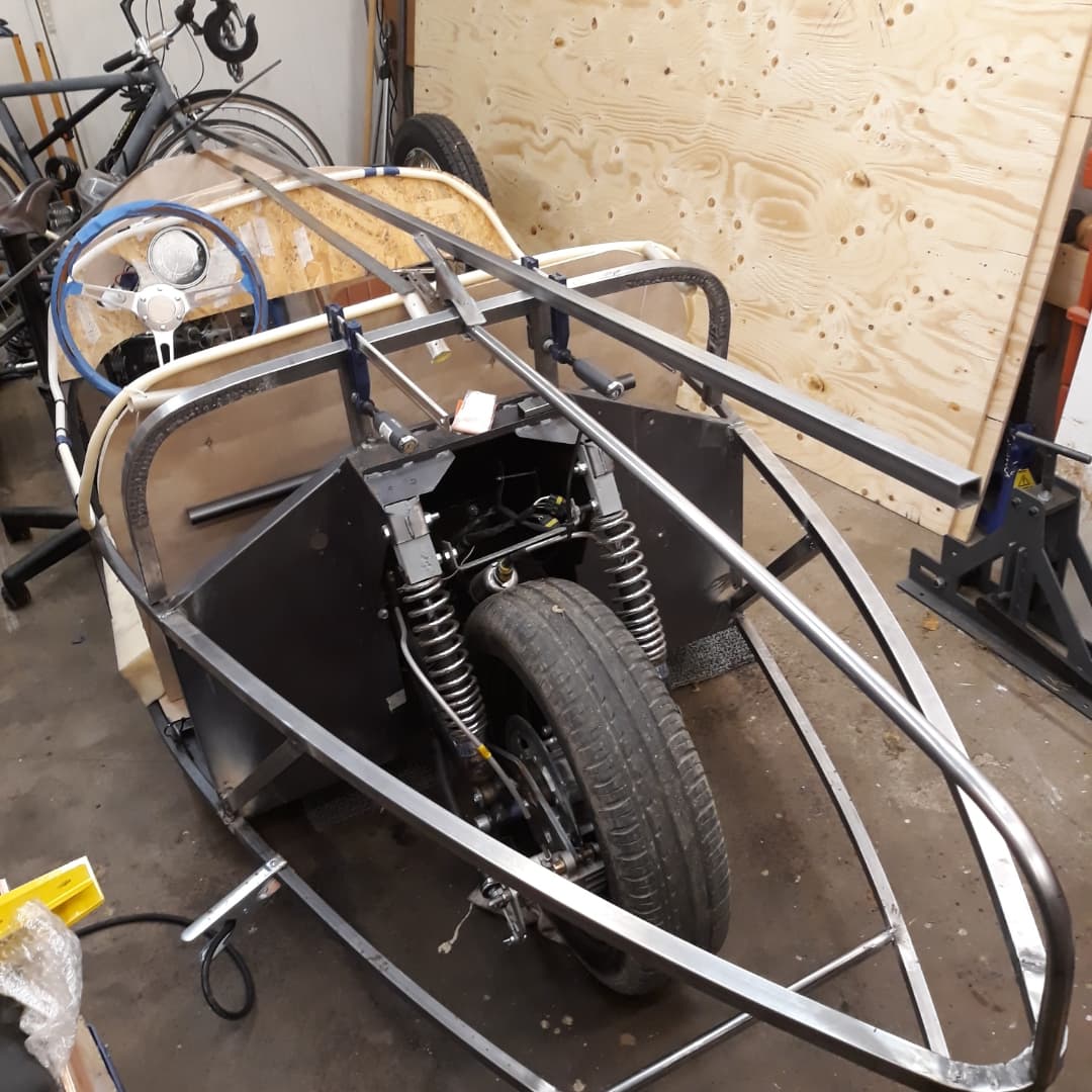

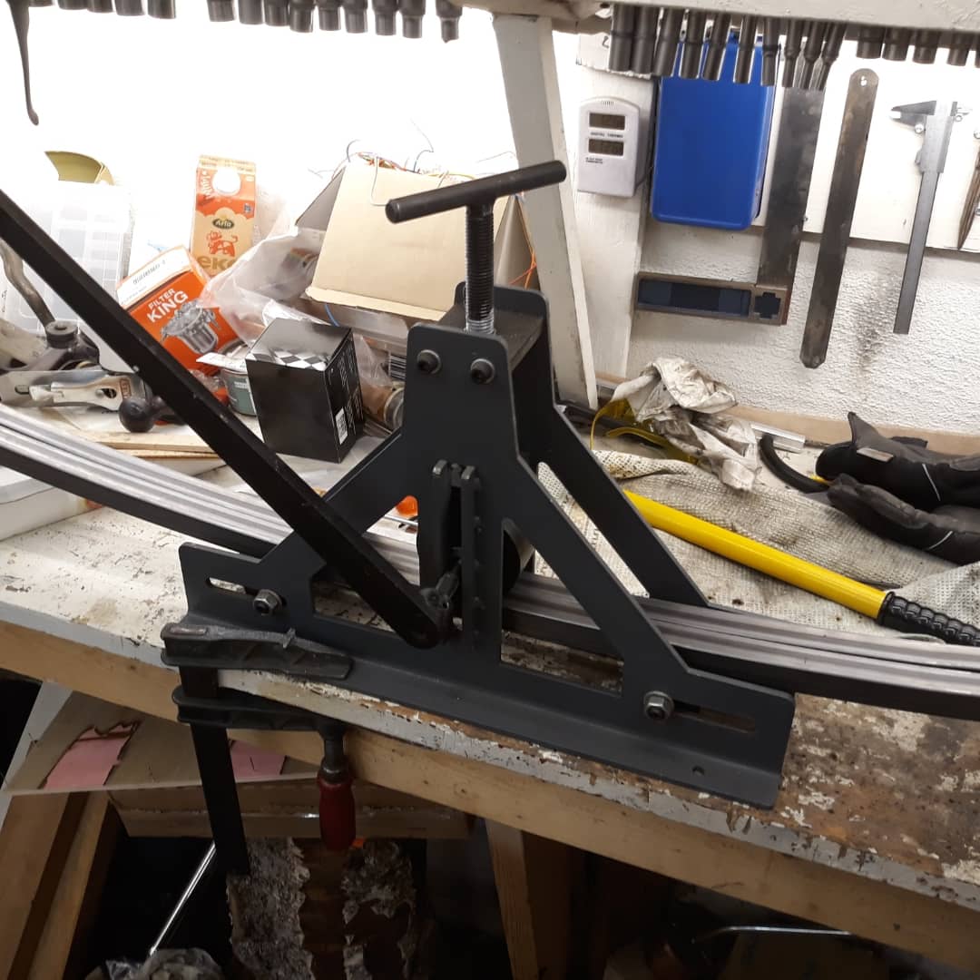

Got two new favorite tools. And a new welder too.
And has finally started replacing the electrical piping with proper steel. A lot of measuring, cutting and some words i wont translate :D but at least its going in the right direction again.
