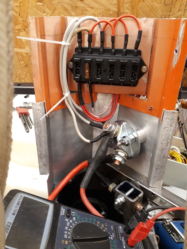

Main switch, relays and fuses connected. Got the ingition key working, now the engine part of the electrical system is ready i can get on with the lights, horn and other stuff.

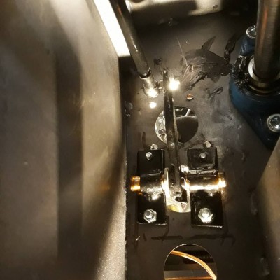

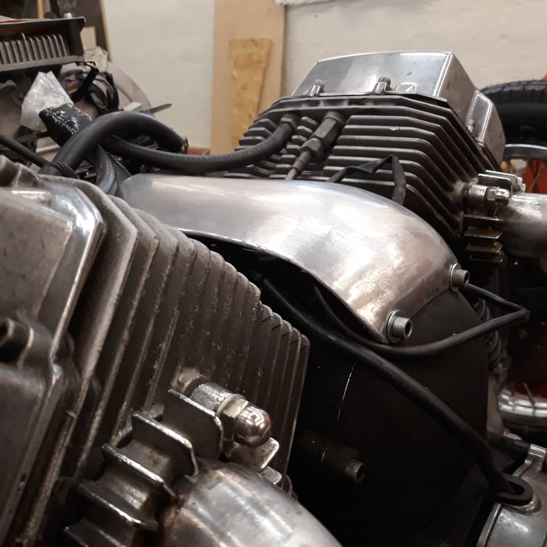

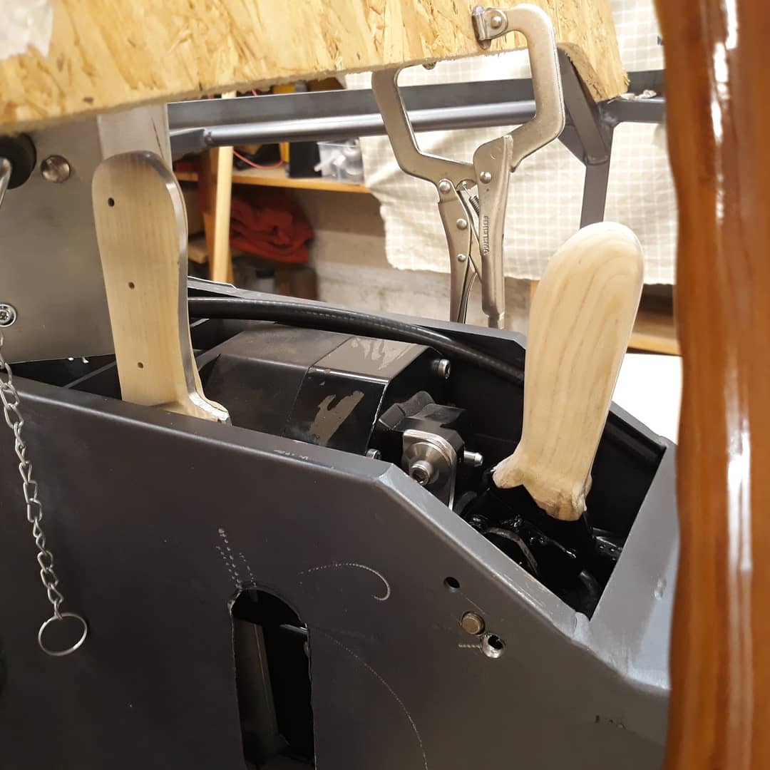

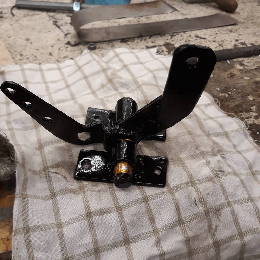

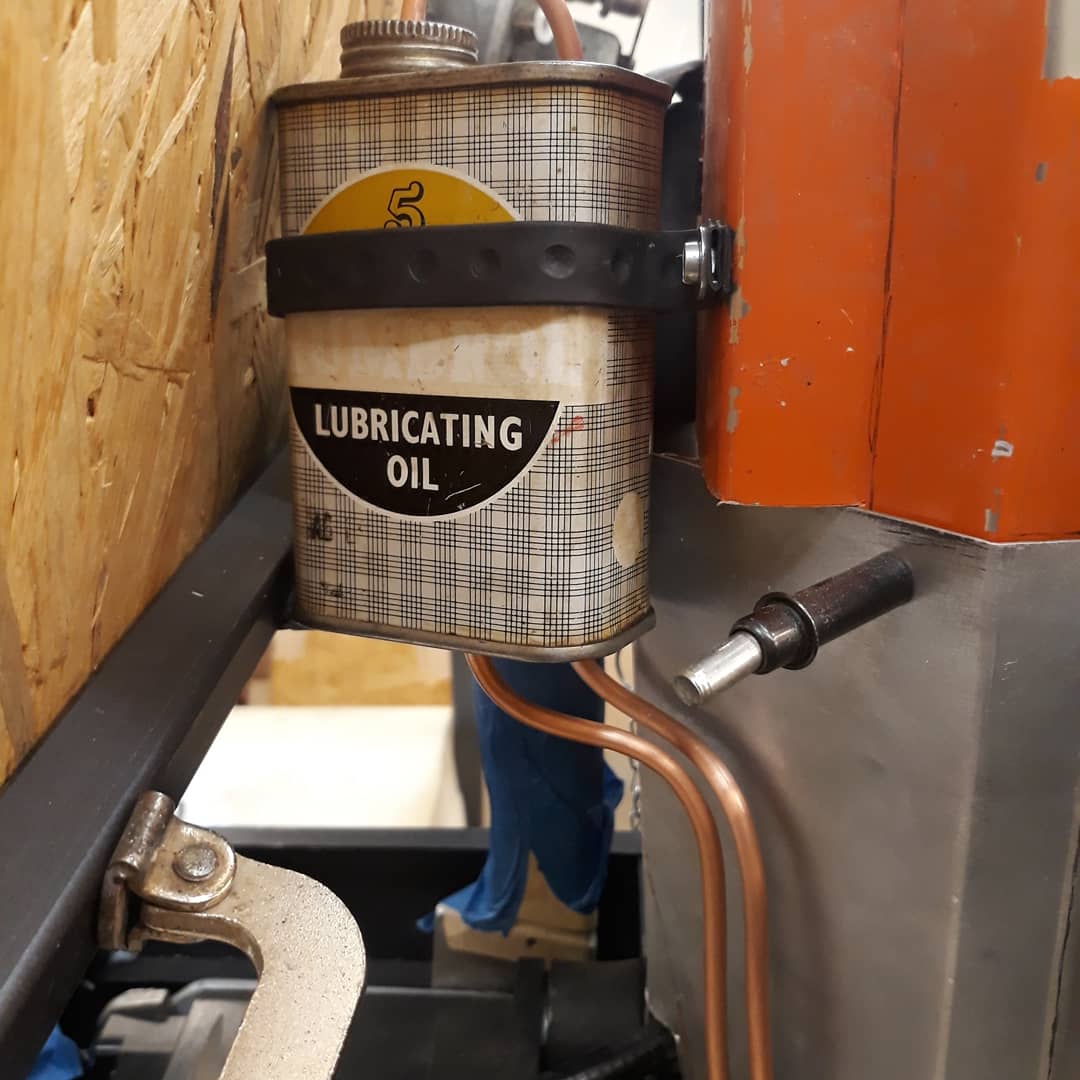

I found a light weight catch tank for the reverse gear box. Just added some pipes and fittings. A temporary fuel tank has been set up for test drive, maybe even this weekend if i get all some other things done first. I tried the little english wheel on a cover for the engine. It was fun to make but i consider it a test piece. All the linkage for the gear levers is finally connected and works smoothly at last. Just need to find a good coating for the handles so they wont get dirty at once.

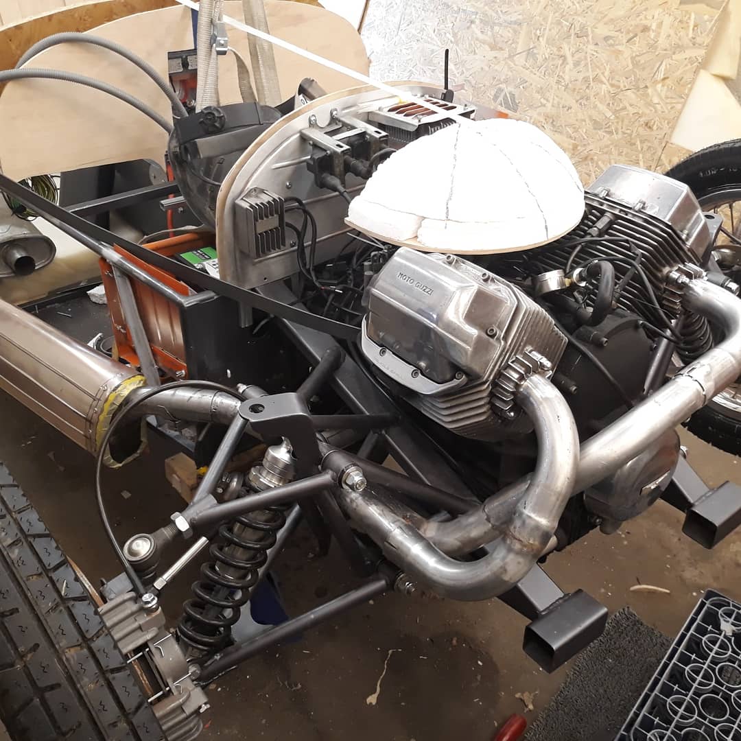

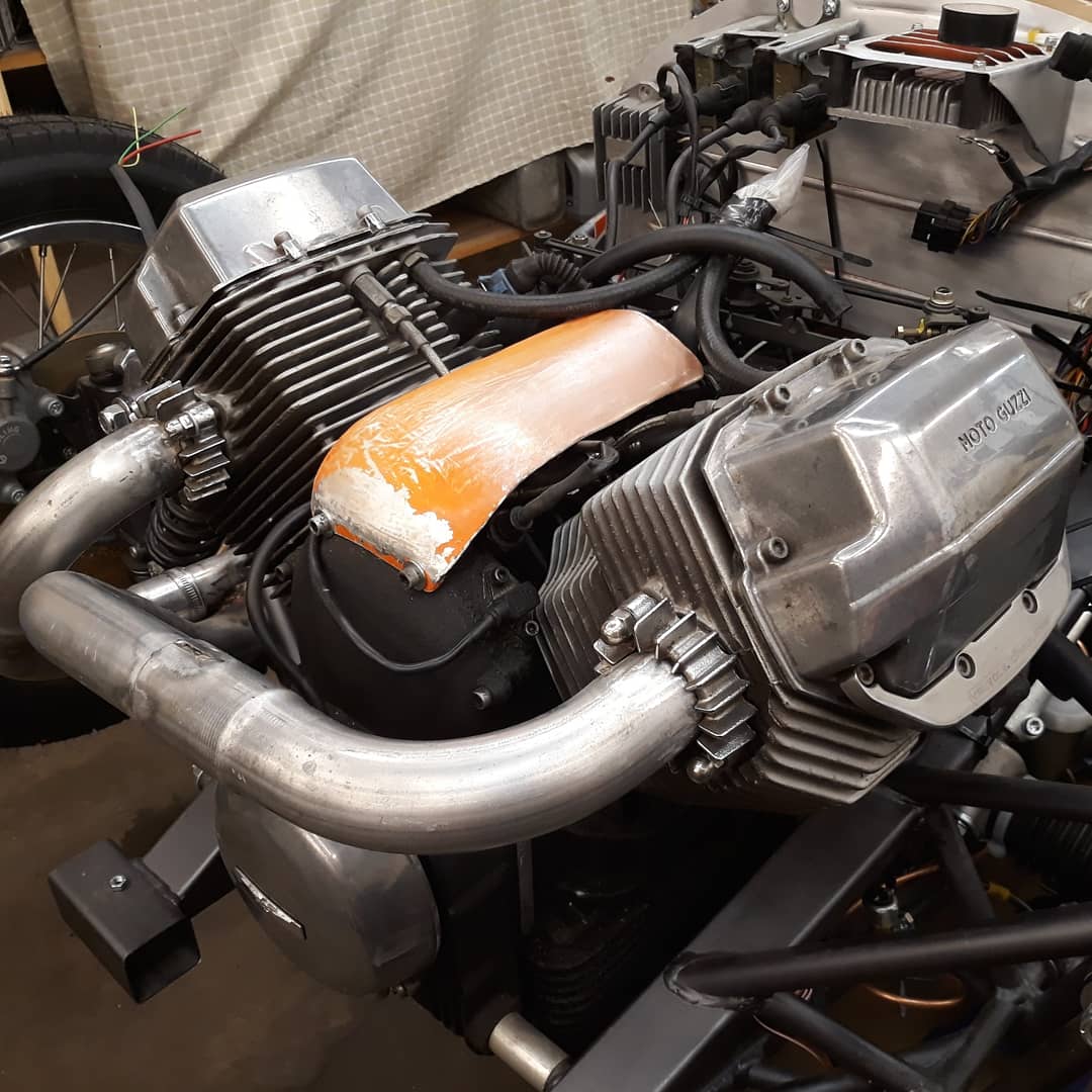

I also mocked up an exhaust system. Instead of the usual way of using the original Moto Guzzi exhaust i made one myself that ends up on the passenger side. The finned exhaust flange are from some other Guzzi, the bolts fitted but the pipe diameter is 48mm now so some pursuation was needed.

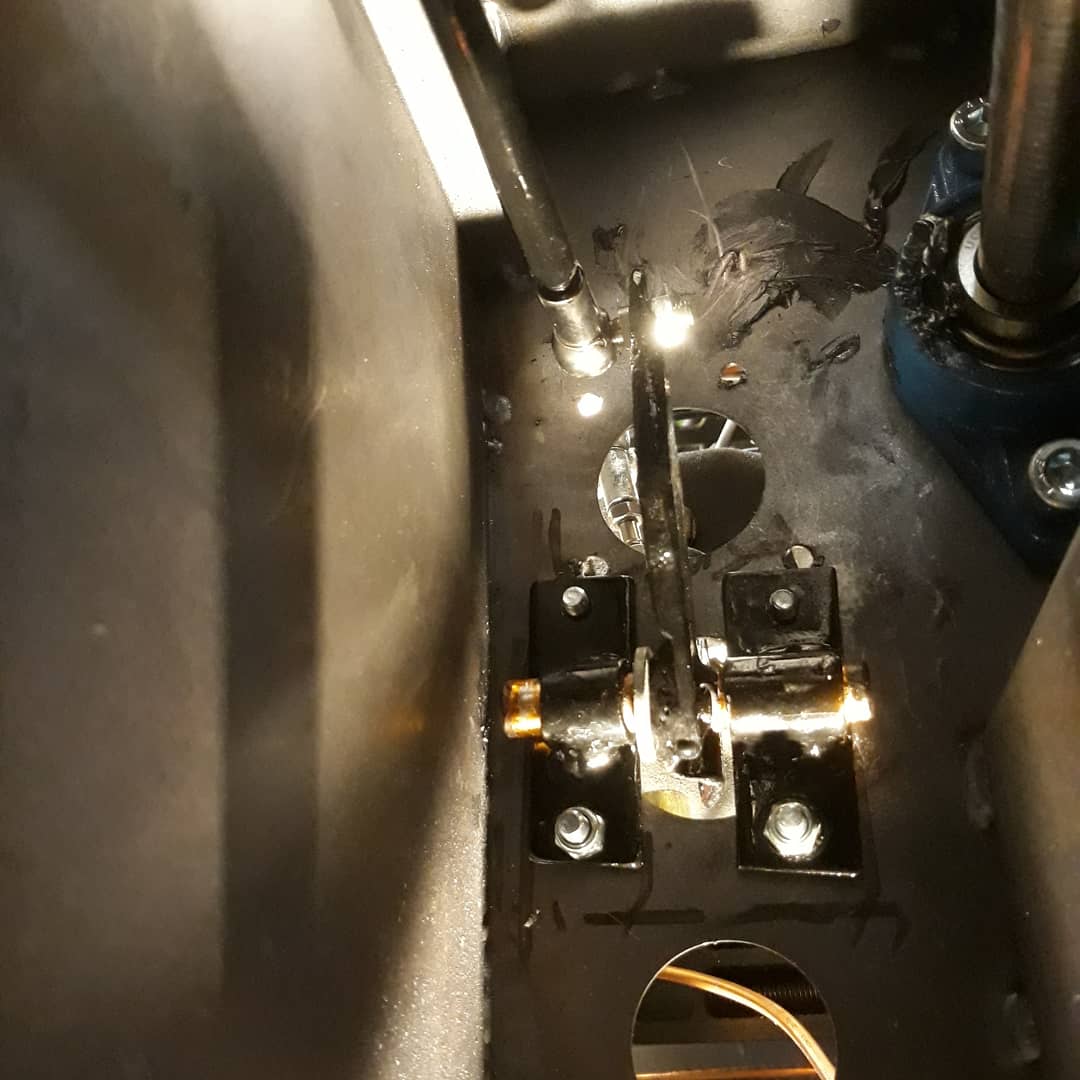

Not as beautiful bends as i had hoped for but it works for now and will all be wrapped in exhaust bandage. Heres the linkage for the gears, all hidden in the tunnel to make more room for packing above.

Nice work, original ideas loving it. Well done.
Re: Build tread (kind of)
Great to see your progress and ingenuity.
Nice siamese pipes.
Good move to use a temporary petrol tank, just in case you need to modify the angle of the filler neck on the final one to match body angle.

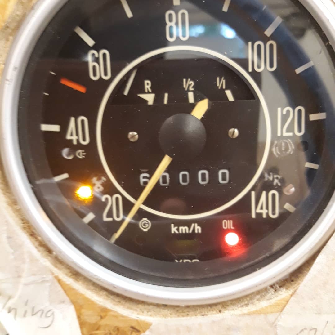

The speedometer was reset to nearest even number wirh a drill. And then it's just a matter of connecting all the little lights in the meter. Some of the functions i can reuse and some have to change. A indicator for Neutral / Reverse gear vill be a red/greed Led. A new meter front will be printed once i got it all figured out.
Can the charge indicator lamp be a led or must it be a glow lamp of a certan wattage? (Or a led with a resistor)
Is it a positive or negative signal?

The charge indicator lamp is a current limiting device to provide small power supply to the charging circuit prior to start up. So best stick with a filament lamp.
Interesting to note that in the model rail world, they use a filament lamp in circuits to minimise power consumption in the event of derailment/dead short. Hmmm.
