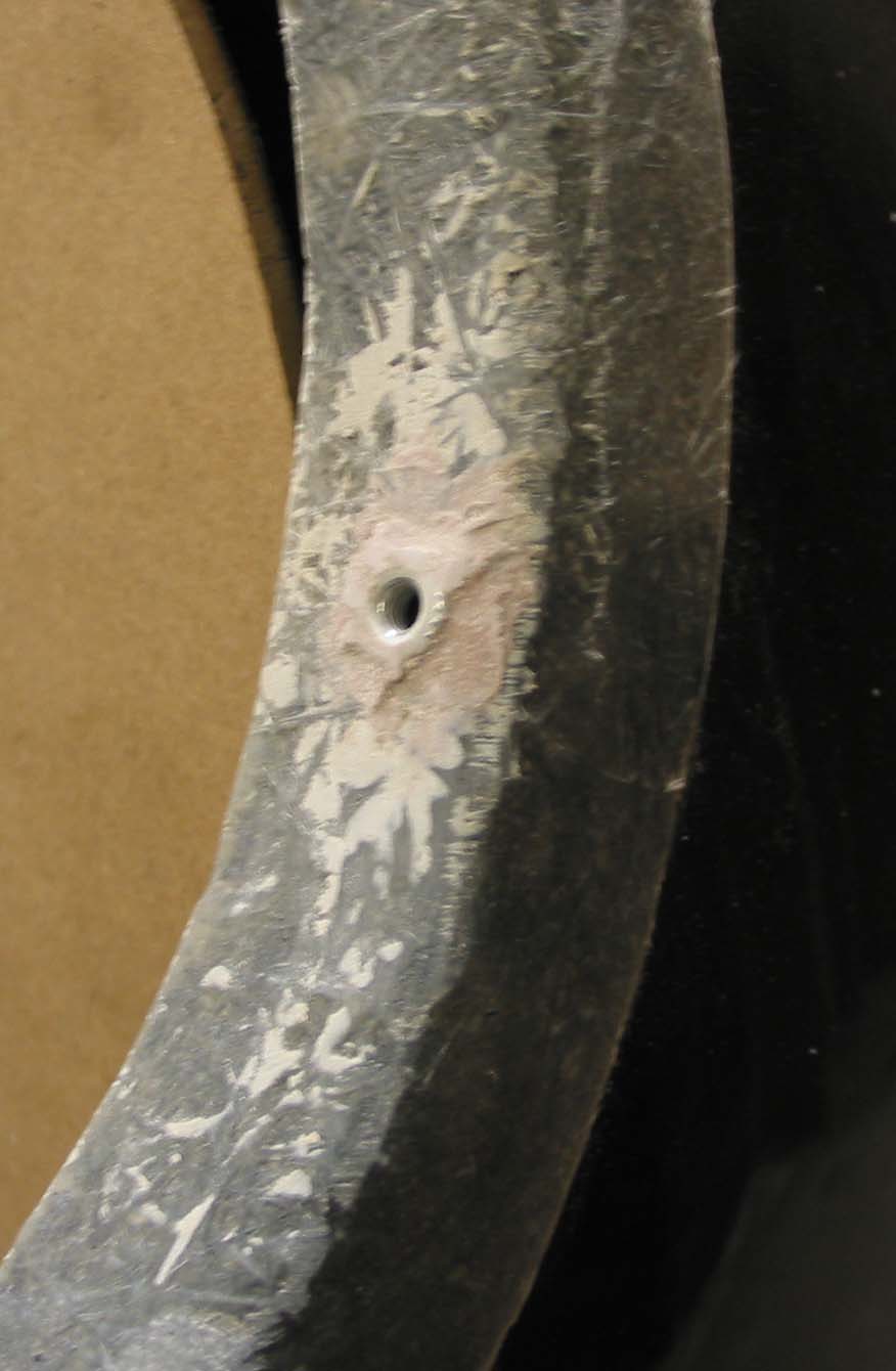

I didn't stick my cockpit roll on to the body, I bolted it with captive bolts laminated to the g/f roll before upholstering.

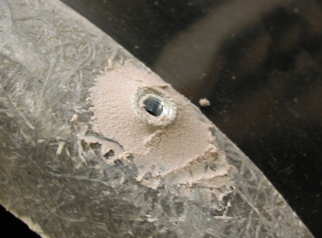

On the first car I built, I bonded nuts to the g/f and used bolts correct length from the underside.

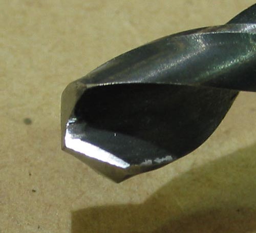

I did have better results on the second car (Edith) using M4 bolts with a metal T welded to them, laminated in position, nuts & washers underneath. Holes needed to be drilled through both the roll and the body before upholstery, in accessible positions to get nuts on, even through the chassis rail on the low sides. Some of the bolts needed to be at an angle to enable the whole assembly to be fed into final position. When drilling through gel coat finish, don't forget to put a negative rake on the drill bit to prevent damage.

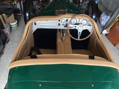

Build nearing completion. Have glued the vinyl to the f/glass cockpit roll but have not yet fixed roll to body, probably will glue in place. Took 2 days to get satisfactory result stretching vinyl over roll and minimising creases on corners, end result acceptable but not perfect.
Could not resist fitting rest of upholstery to see what it looks like, and I think it looks absolutely frigging gorgeous. The colours go together really well - thanks to Nicki for help and quality workmanship.
Just got carpets to sort out, then have to wait to book MSVA.

Looking the Dog's biscuits Tony.
Well done.
Well done.
- Posts: 288
Re: Build progress
Looks great, Tony - the green and tan go really well together !

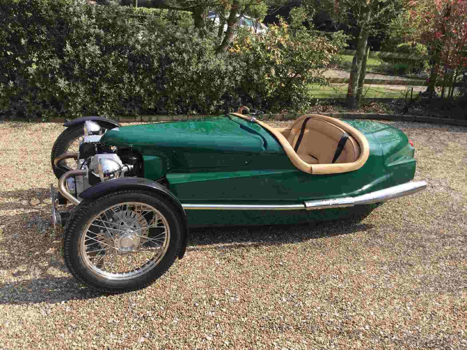

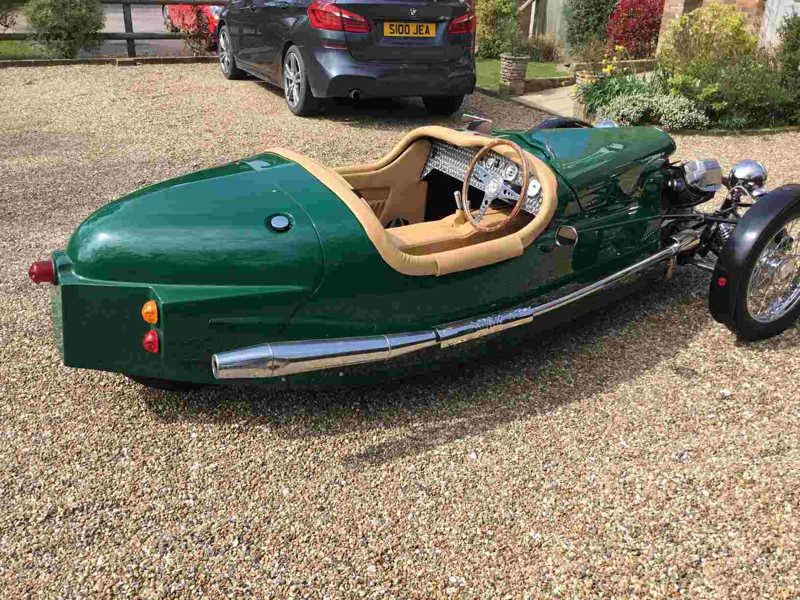

Thanks for your kind comments. Can’t wait to get it on the road once current virus problems are over. Have spent most of afternoon driving up and down my short shingle drive, getting used to reverse g/box which does seem to be bedding in as can now get forwards more easily. Have now got to go out and sweep shingle back over wheelspin marks.
