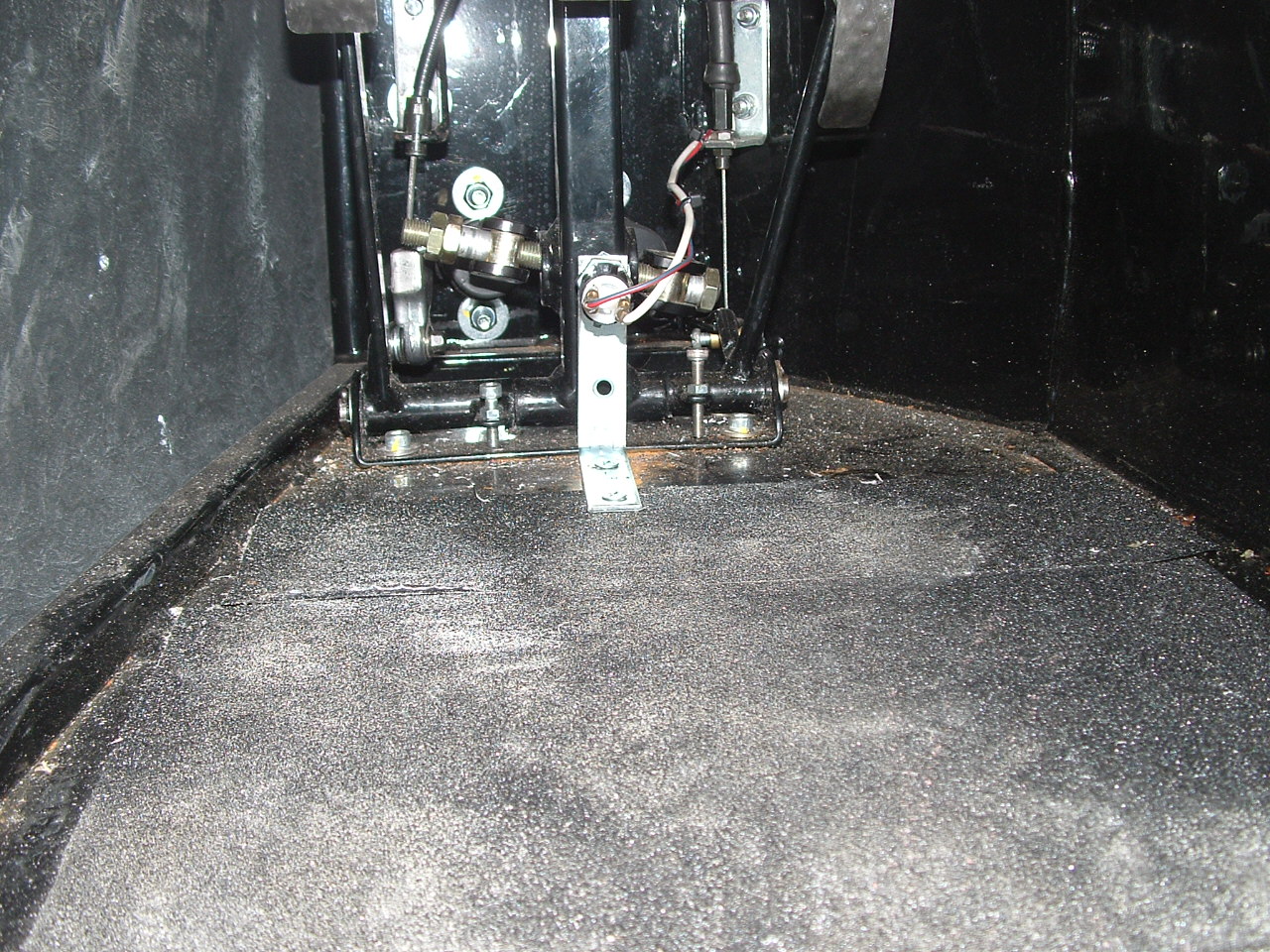

1) I tested the hydraulic brake light switch in isolation. It does work, but takes a lot of pressure on the pedal to activate it (more than I was trying yesterday). Light braking will not activate the switch.
2) I put a temporary manual switch in place of the hydraulic switch and tested the rest of the wiring (after tracing to make sure all was wired correctly). The brake lights worked fine. It turned out the low intensity (running light) filament of the left taillight had gone out - again. It had done that when I first picked it up and was getting the demo drive. I put a fresh 1157 bulb in and it all worked fine.
3) I noted the ground tabs in the tailight sockets are not anchored to the socket base, which might explain why the left rear running light keeps going out.
Next plan:
1) I am going to work out converting from the hydraulic brake switch to a pedal activated mechanical switch. I want the brake lights to work with light braking as well as heavy braking.
2) I have ordered a replacement flasher unit for using with LED turn signal bulbs. I have also ordered LED equivalents for the 1157 brake/running light bulbs.
3) I am going to dig through my assortment of screws and find the size appropriate to properly anchor all of the ground tabs in the taillights.

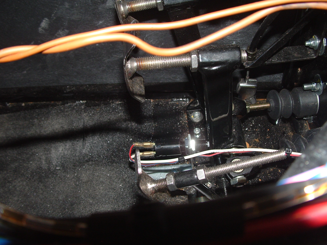

I got #1 and #3 from yesterday's "plan" accomplished.
The new switch works very nicely - light braking turns on the brake lights and the pedal return turns them off. The new switch seems vulnerable to being hit by the bottom of my foot, but it actually is not. My normal foot angle leaves lots of clearance.
I am just waiting for the bulbs and flasher unit to arrive to take care of #2. They are scheduled to arrive Monday.
