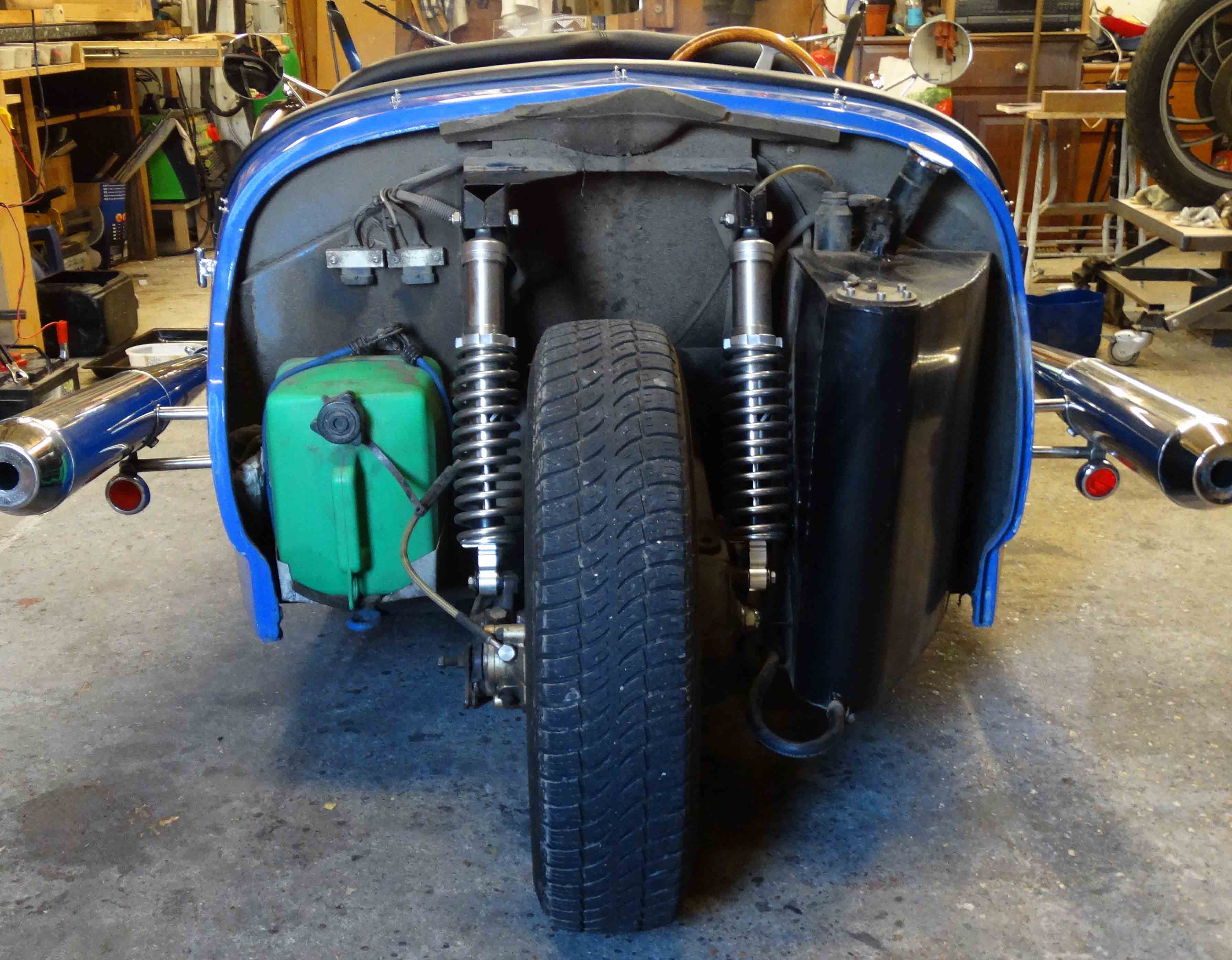

On the subject of suspension comfort I notice Hagon make these rear adjustable shocks for the California (and other Moto Guzzi models). Any thoughts or experience of how they work on the Triking rear? They are adjustable but I can't tell whether they are conventional or gas filled shockers...

My rears are the Hagon Nitro. 400mm so nice long stroke to soak up the bumps.
Gas filled, micro adjustment on pre-load and fully adjustable damping.
Very satisfied, the rear now matches the superb front arrangement.
No more spine jarring!

This thread has come along in timely manner as the next job on my list is to improve the too-low and jarring rear suspension on my Type 1. Currently it has a rather manky pair of original Spada shocks which are underdamped, undersprung and underlong.
Having the Convert rr caliper my choice of shock is restricted by the diameter of the lower portion which can fit; this has eliminated the Harley gas shocks which were first choice. Triumph owners seem to frequently upgrade rear suspension, so there are plenty of very low mileage units for sale which will fit with bush inserts, however, I've been very impressed with Hagon products over the years so those Nitros look good to me.
Richard, you're using 400mm length, but what spring rate did you go for?

My Type 3 has been built with the high performance suspension front and rear and now it's passed its MSVA today (hurray) I want to set the suspension up ready for when I can drive it. It would be very useful to know what damper settings you've found are good to start with and how much preload you've put on the front and rear springs.

Congratulations on MSVA pass!
No pre-load on springs.
About second click on damping.
Works well for me.
Just need the registration then you can test run on your favourite Norfolk roads.
