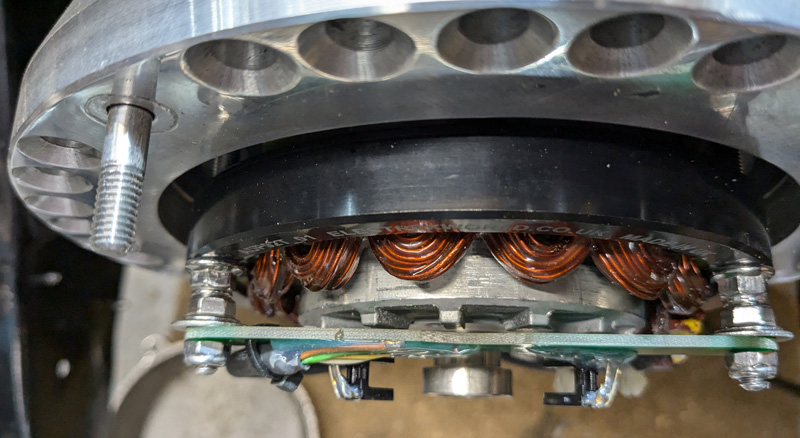

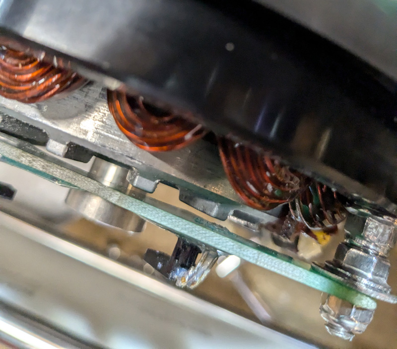

Thanks for the comments about the Dellortos - I have no experience of them on a Guzzi so it's good to hear from someone who has. I did a compression test - all good. Checked for sparks at both plugs and checked the timing which all seemed ok This engine has the Sachs electronic ignition and I suddenly noticed that the pickup sensor PCB was very close to the stator. This guzzi engine has also got an uprated alternator with larger alternator windings with a corresponding longer stator. When mounting the PCB which sits in front of the stator it was necessary to make longer studs for it.
When I took the PCB off I could see that the stator protruding lugs had been rubbing on the board, right where the optical sensors were soldered to the board. They're protected by silicone sealant which had been rubbed away such that the stator could contact the soldered joints with the faintest of pressure on the board. I think the board may warp slightly when the engine is hot so I spaced it out further. I also cleaned up the soldered joints and put araldite over them to provide decent protection.
Once it was retimed and put back together it started up after a couple of goes and ticks over nicely. Another road test tomorrow should confirm if that was the problem.

Just a quick update to say it's running beautifully today so problem fixed. Thanks for the advice.
