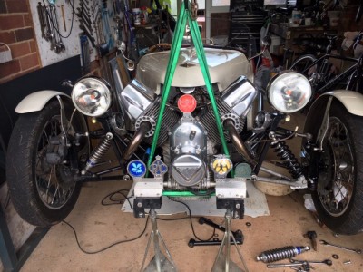

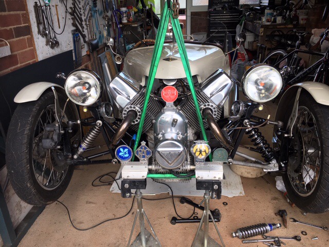

After the work Alan and Tony have done on the upgrade I decided to upgrade my T3. Parts arrived today and got straight onto it, test fit then remove to paint. Picture shows one side with original and the other side with the upgrade. A few mods to try and retain as much of the original parts to try and keep the cost down. More to follow.

Re: COMFORT Front Suspension T2/T3.
Very interesting Richard, watches with baited breath. Looking forward to comparing.

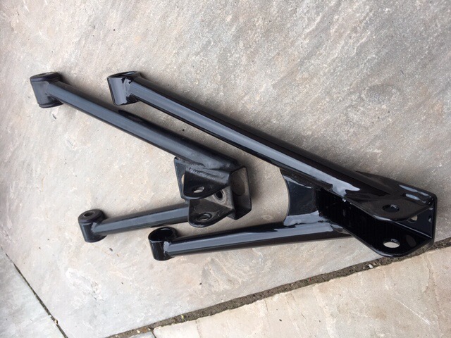

New lower wishbones powder coated today, took them in at 10 this morning and picked up at 3 this afternoon, amazing turnaround.
Picture shows new and old wishbone to give you and idea of change. Now to see if it all goes together without any major problems.

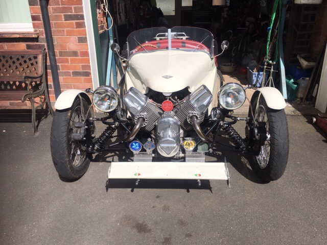

What a transformation, the suspension just mops up the undulations in the road, no rattles or bangs from the front, it was heaven to drive. Ok the ride will never be like a Rolls, but it transforms the little Triking and for touring it’s a must.

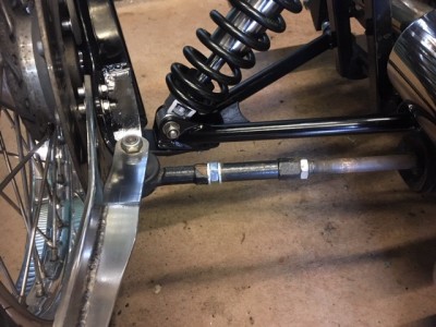

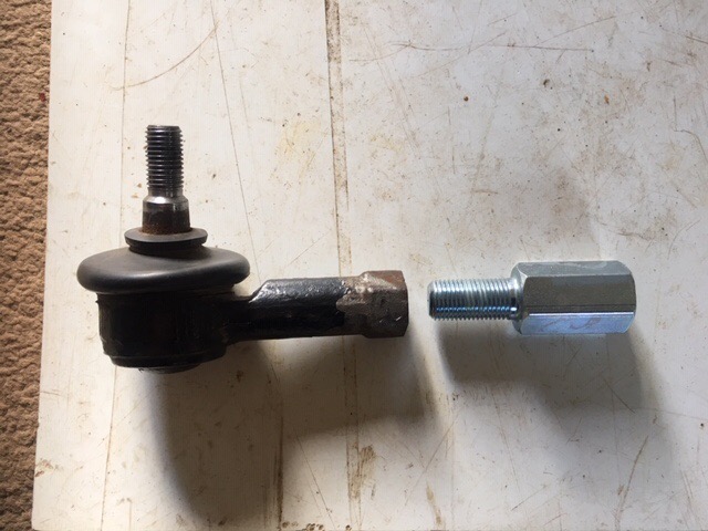

I’ve used my original top wishbone; however, to get enough thread secured on the ball joint the car does resemble Axel’s aggressive camber angle
, I think I will lengthen the threaded tube on the wishbone to allow for more adjustment or maybe go for the fully adjustable wishbone with the rose joints, still not decided; however, I am trying to keep the cost down. I Have lengthened the steering rod by adding a 1/2”unf nut a couple of washers to the joints between the extender and the tie rod ends, again this may have to be modified further if when the top wishbone is lengthened it may require more adjustment that the current thread length will accommodate.

, I think I will lengthen the threaded tube on the wishbone to allow for more adjustment or maybe go for the fully adjustable wishbone with the rose joints, still not decided; however, I am trying to keep the cost down. I Have lengthened the steering rod by adding a 1/2”unf nut a couple of washers to the joints between the extender and the tie rod ends, again this may have to be modified further if when the top wishbone is lengthened it may require more adjustment that the current thread length will accommodate.Re: COMFORT Front Suspension T2/T3.

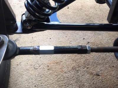

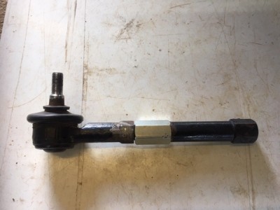

Change of plan on the tie rod extension, I wasn’t happy with the original plan and now have extended with a 1/2” unf wheel space extender stud. This extends the tie rod by 1” and now have plenty of thread in all components and still have plenty of adjustment.
