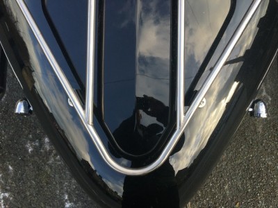

Andy, I fitted blocks to a sheet of hardboard large enough to carry the rear unit, squared it off in measured squares and marked in black fine line marker, kicked up the rear to the point of its actual position on the car and with set square and Height gauge set about marking areas for glassing in the strength and final positions.

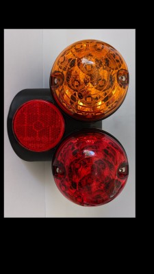

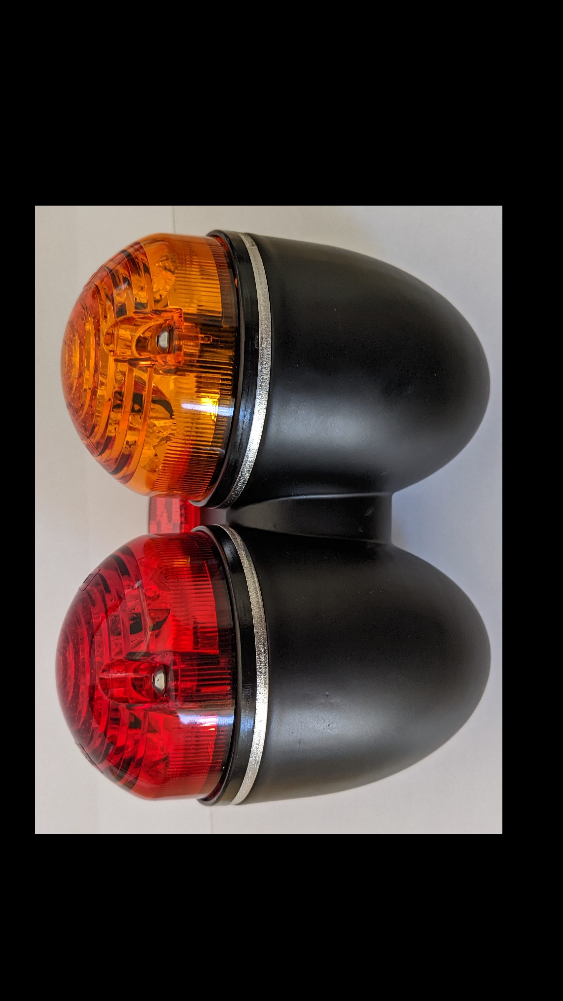

Hi All,
I thought there might be some interest on what I've ended up with for my rear lights and what I've learnt along the way.
Firstly a couple of pictures:
I found that the LEDs run very cool so don't seem to need a heat sink.
As originally planned, I printed this on a 3D printer using PET-G filament as it's a good compromise between robustness and ease of printing. I've discovered that it's not a good idea to print at the best quality as that means lots of thin layers. While this gives the best appearance, this make the print slower and also gives a weaker end product. Obviously thicker layers means more obvious ridges but this is easily solved with sanding reasonably smooth and then coating with epoxy resin. A final sand followed by a few coats of acrylic spray paint gives the finish you can see in the pictures above.
I'm very happy with the end result and am happy to share the CAD file with anyone who might want to use it as starting point for their own design.
Andy.

Excellent development indeed, well done.
Re: Type 3 smooth tail - rear lights
Great job ! Must better than most of the so called "professional" installations I have seen, You won't need a heatsink. There is almost no uninsulated contact / heat sink function in the std installation and they never give an trouble even with std bulbs. If you use LEDs they will be even cooler.
