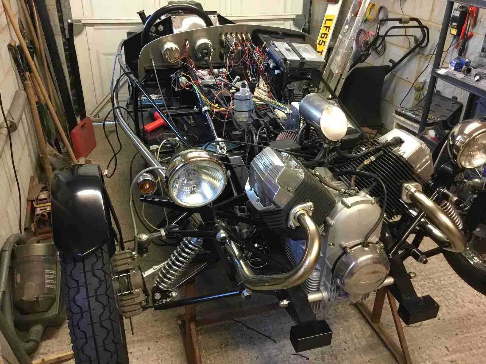

Can’t stand (or understand) wiring so pleased to say have just completed ignition wiring and everything worked first time!! Will have to do some lengthening/shortening and tidy things up once all the rest of the wiring is done.
Can’t try starting engine, lack of exhaust system, but fuel pump works and there is really good spark when engine turned over.
Obviously got loads still to do before fitting body, including fitting front hubs and wheels, front mudguards and stays, all lights and indicators, and the rest of the wiring. Will be nice to see it off the stands and sitting on its wheels.

Fired her up for first time. Started almost immediately and runs well, albeit rather loud with no silencers fitted. Had hoped that getting it running might cure leak from pressure regulator but not the case. No leak whilst engine running so started to celebrate but then noticed very slow drip when switched off. Will have to replace.

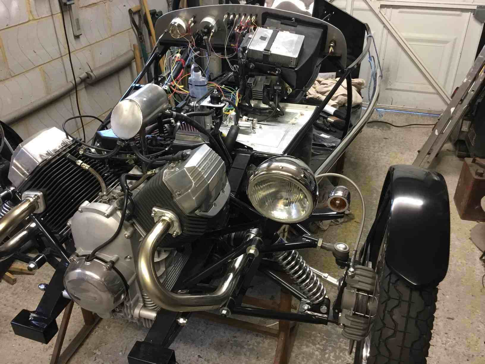

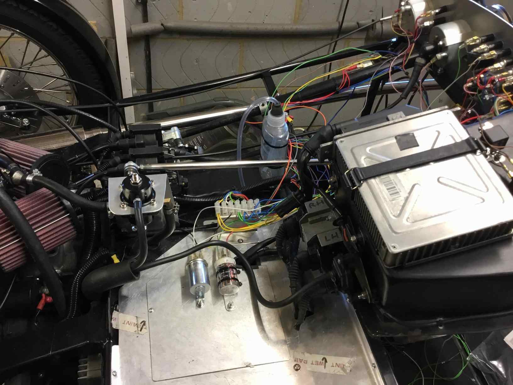

Progress had slowed down but got quite a bit done in last couple of weeks. Replacement fuel pressure regulator fitted and set up (be careful with very cheap Chinese pressure gauges. The one I bought was reading nearly 25% out before filling with petrol and disintegrating!!), mudguards painted and fitted, brake system finished and bled successfully thanks to lots of advice from other members, wiring is almost completed. Not good at wiring but neighbour is pretty good and only have only had a couple of blown fuses, both down to faulty parts. One of the sidelight holders in the headlight was broken and shorted out, Alan supplied a replacement by return post. The indicator relay was also faulty and shorted out - Car Builder Solutions replaced it and said quite a few from the same batch had failed.

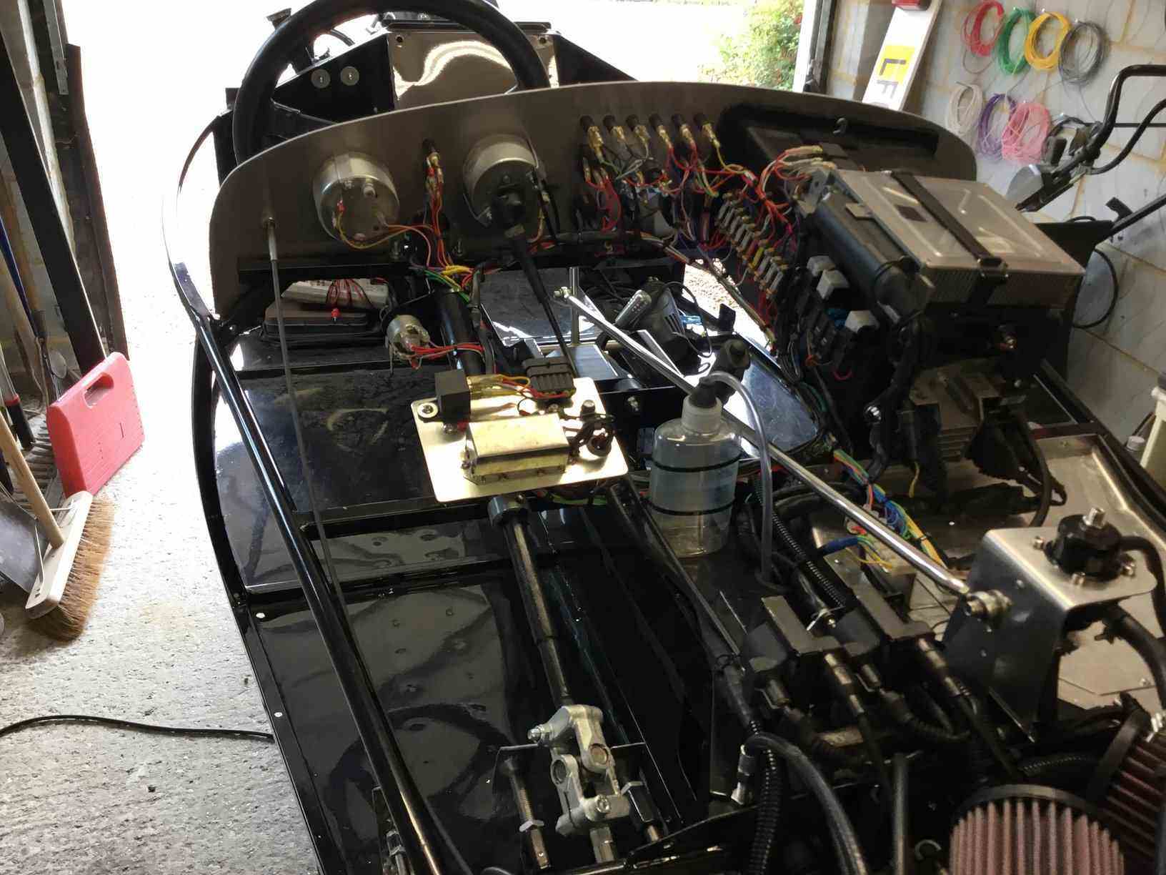

Re: Build progress
Thanks for all responses, including the one from Spaniard. Will check with Alan re position of steering wheel, but had assumed that UK had, as always, got it right.

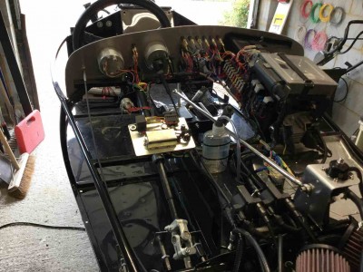

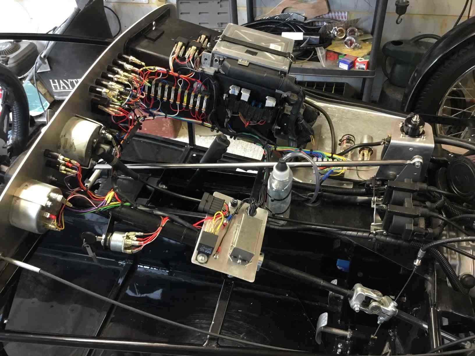

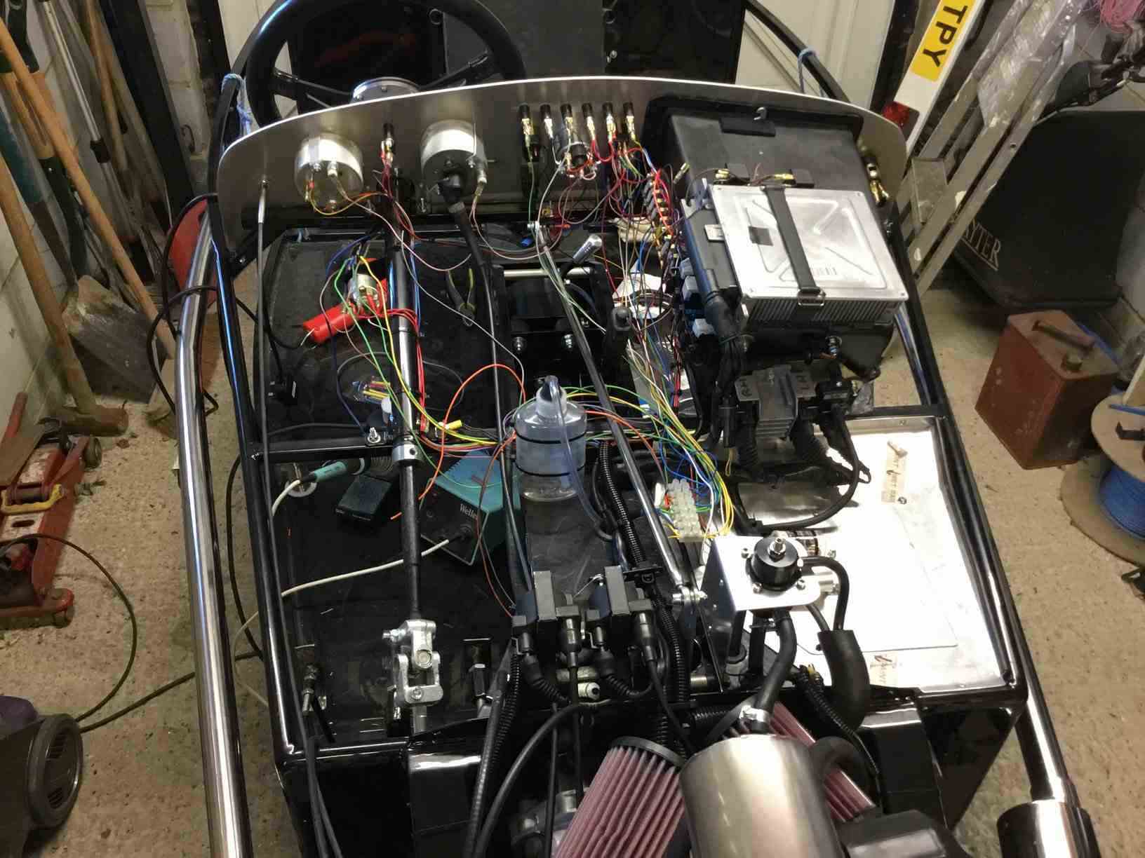

Wiring is now completely finished and everything works, although I do seem to have relays everywhere thanks to my knowledgeable neighbour! Took ages to tidy and clip the wiring in place, end result is far from professional but is reasonably neat - it will do. The plate on top of the steering column holds a wired connector for the wiper motor, and the Cobra immobiliser.
Body next!!
Body next!!
