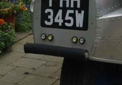

I put one on my Pembleton.
It does bolt through to a chassis hoop so serves as a lifting handle, makes parking in tight spaces easy. Don't think you could lift a Triking by hand though.
It's also a brilliant bump stop for when parking or in garage.
