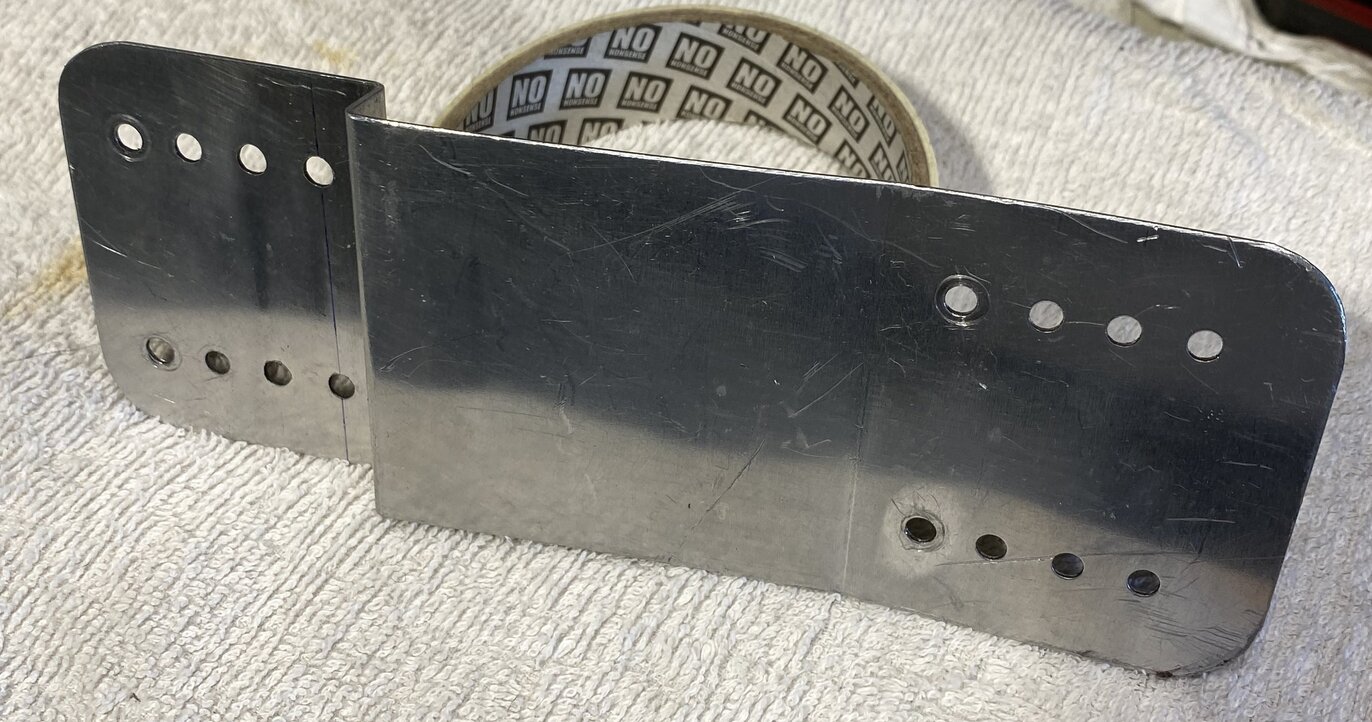

Are you in a left hand drive Triking? If RHD then a small support on the tunnel is a great help. Can send a picture.

Here are the types I have made Large adjustable item on a RHD T3 and the other just a short length of Aluminium angle on a T4
I was thinking for LHD you could stick a couple of lengths of 5mm x 12mm Aluminium strip to the body sides vertically having first countersunk and tapped M4 with the remainder of the M4 bolts sticking out then the Mk 1 style could be bolted on in the suitable position?

Post by Doverhay » Wed Jun 04, 2025 10:34 am
The cheap little mod works a treat👍
