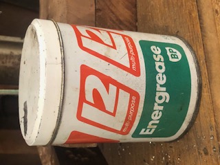

A tub of this goes a long way and lasts a long time.
I have used the 5th wheel grease successfully --- but it is the filthiest of stuff to use.
