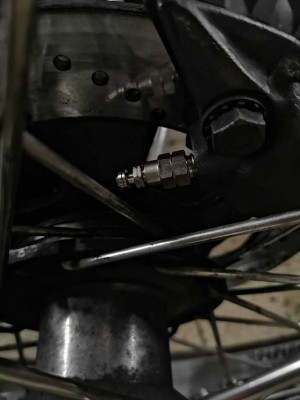

Post by Nr.100 » Wed Jan 08, 2025 4:43 pm
A good help when changing the brake fluid and for bleedigging the steel flex brake lines on the Triking.

Post by Weg » Wed Jan 08, 2025 7:17 pm
Nice tip Hans.
I've found an easy way to bleed front brakes.
Remove the caliper from it's mounting, brake line intact, place a spacer same thickness as disks between the pads.
You then have sensible access to the bleed nipple.
