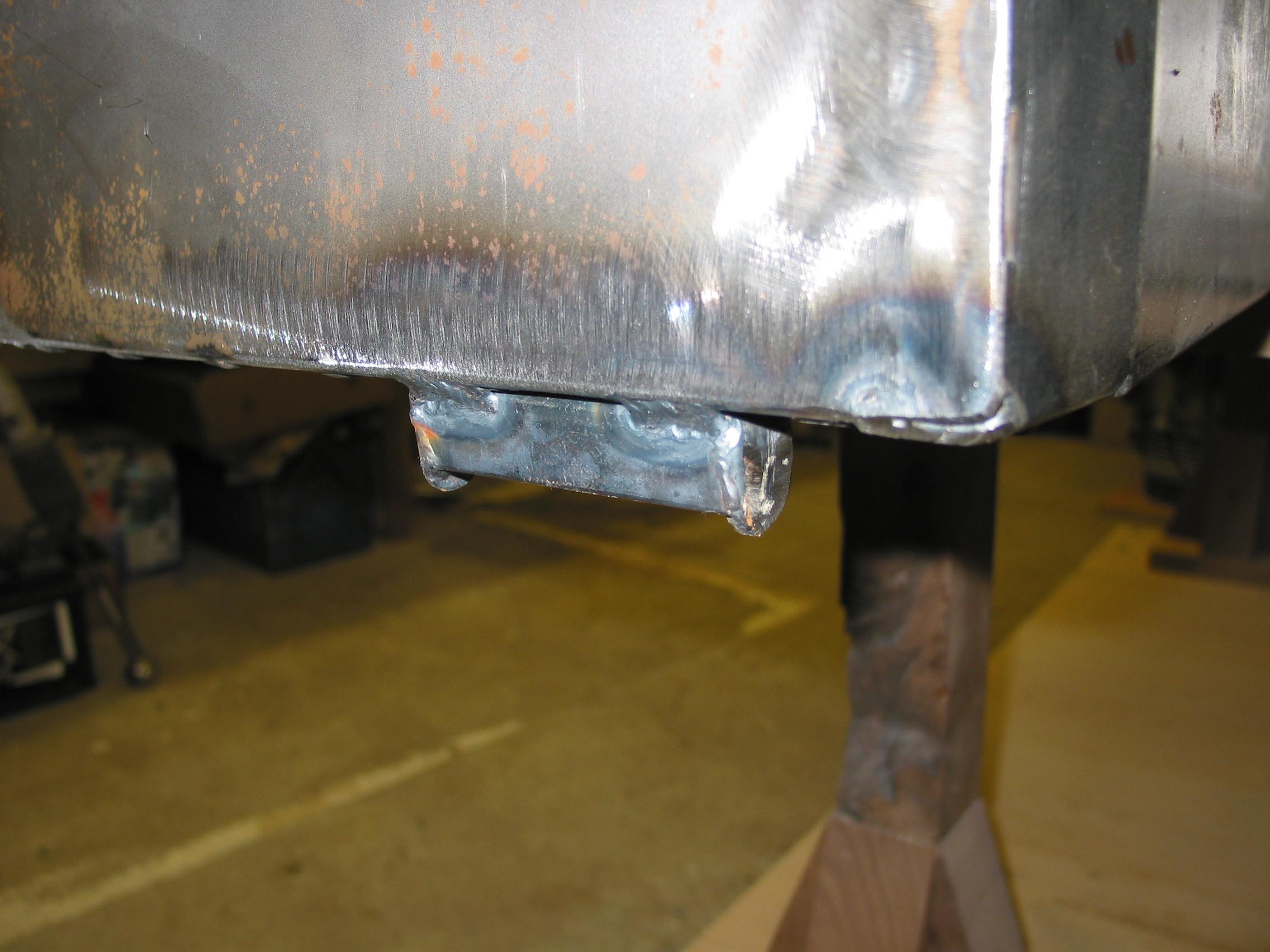

Nothing wrong with jacking/supporting the car on the rear cross rail.
Best use a piece of softwood on the jack or stand to minimise slipping and paint damage.
At the bare metal stage, I welded on a piece of 20x20 to the rear of the chassis to enable safe lifting without slipping using the farm high lift jack. (A few details on viewtopic.php?f=7&t=450&p=2805&hilit=build+stand#p2805' )
