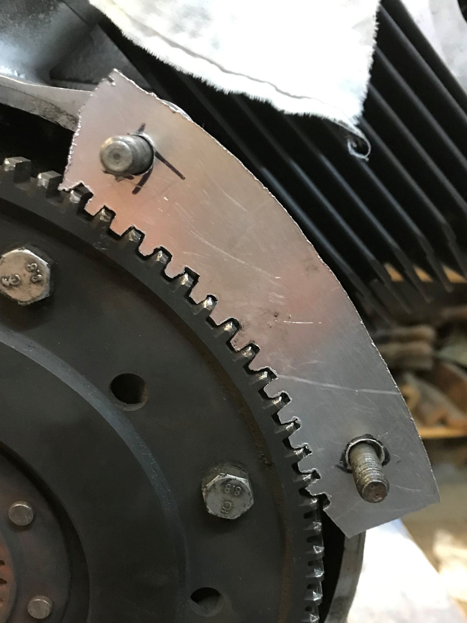

Before stripping the timing gear to remove the camshaft, I made up a flywheel locking toothed plate to set the engine to tdc compression on left cylinder, the cyl used for valve timing. (Also needed to lock engine for torquing crankshaft and camshaft sprocket nuts back on)

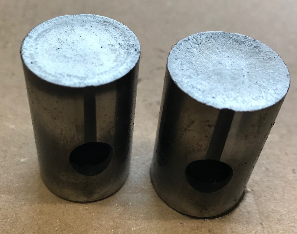

Oil ways in rockers spindles totally blocked.
The amount of oil getting to the rocker spindles was sufficient to keep them lubricated but not enough flow to run down the push rods and lubricate the cam and followers.

Rocker spindles are held in place by M6 x 14 bolts. 3 were 16 long and 1 was 18. The 16s didn’t block the oil way but the 18 was a baddy.
The main reason, I believe, someone had used a sealing compound on the oilway junction between head and rocker assembly casting. This had squeezed into the oilway, enough being flushed through to the smaller holes in the rocker spindle starting the blockage.
Moral here: Don’t use any sealant on metal to metal oilway junction.

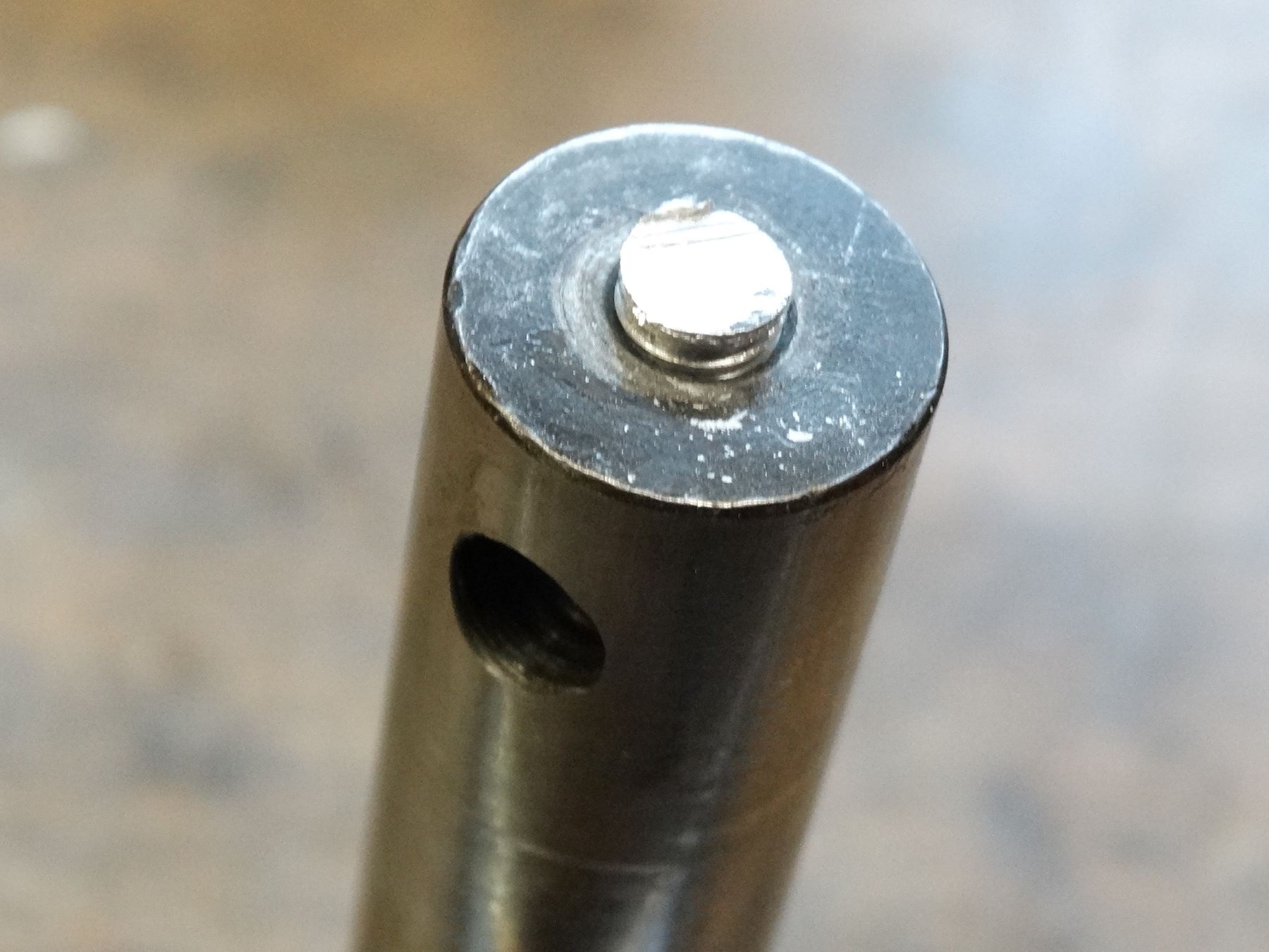

To clear the completely blocked spindle, I drilled out the peened over aluminium end plug, these turned out to me M5 threaded. 2 came out easy with an ‘easy-out’ others had a 4mm drill in them then M5 tap to clear.
Re-plugged with 5mm ally dowel, threaded M5 long enough to bottom out in hole without going too far into the M6 threaded cross hole. Screwed in tight using grips, threadlock used, saw off 1.5mm long then peen over with hammer. Check M6 hole clear and clean up with tap.

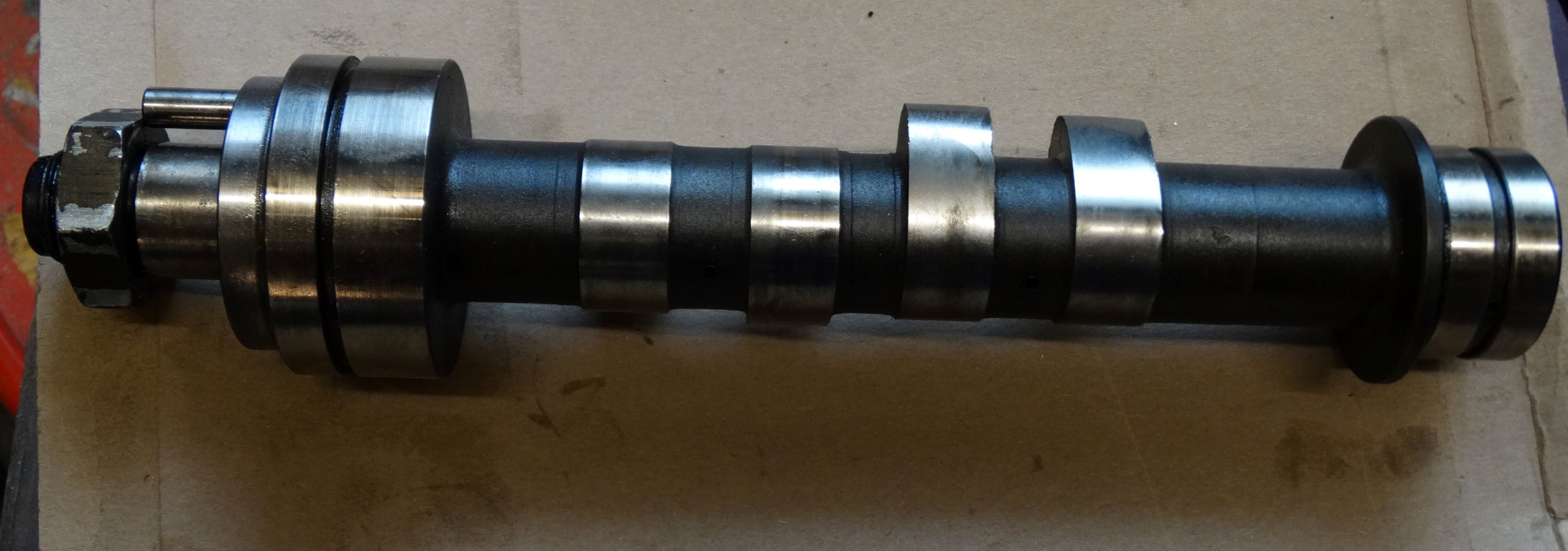

The replacement camshaft was from an earlier engine with tacho drive on the front end. Cut the worm drive off with disk cutter, keeping cool with water to avoid heat damage.
Good set of cam followers acquired.

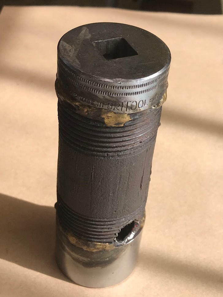

Re-building went ok, only special tools needed is a long 32mm socket for the crankshaft/sprocket nut. Here’s one I made when I was a boy, doubles up as the adaptor for the allen key used to torque the socket head cyl head nut.

With the toothed plate still locating the flywheel, torque the crankshaft and camshaft nuts to 110 ft/lb.

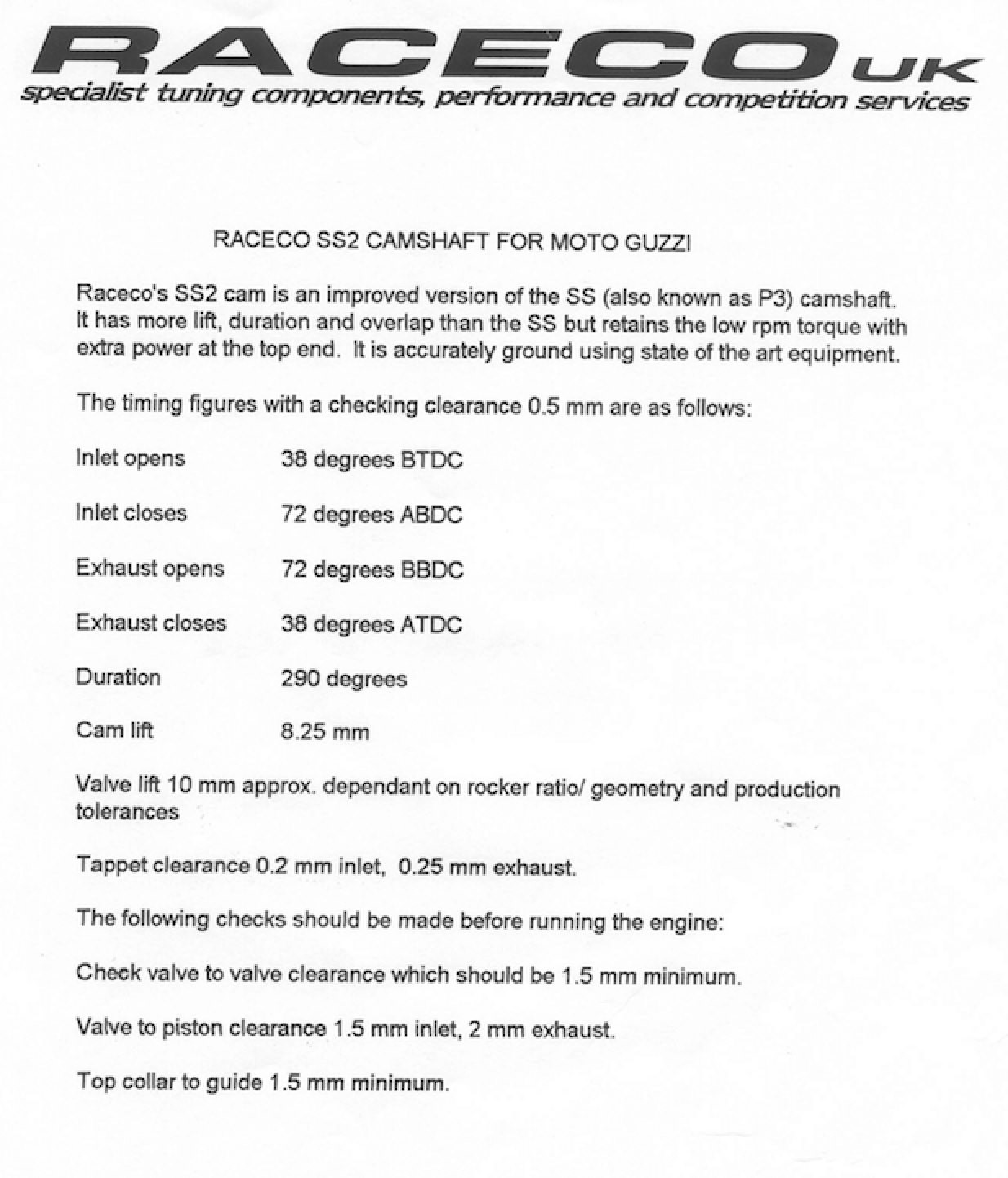

Muzzi Moto sell Raceco SS2 camshafts. This would be a good opportunity/excuse to tweak a bit extra into the mid/upper rev range.

Thank you sir! I have investigated that camshaft and this is what they said:
Hi - as per the attached document, you will not need to make any changes over stock other than timing set-up.
Hope this helps.
Ian
Muzzi Moto

The question is how do I change the timing?
iant-s

On an injected engine I don't think you can change the timing as it is set by the flywheel and / or camshaft pick-up and calculated in the CPU.
Posts: 243
Re: The Noisy Tappet Saga
Post by peakrock » Wed Nov 08, 2023 8:05 pm
Surely you won't need to adjust the valve timing as presumably the cam is profiled to use the standard drive pulley and the ignition timing will just remain as is? Or does it need the ignition advanced/retarded? It looks like you need to check clearances between the mechanical bits but that's all isn't it?
