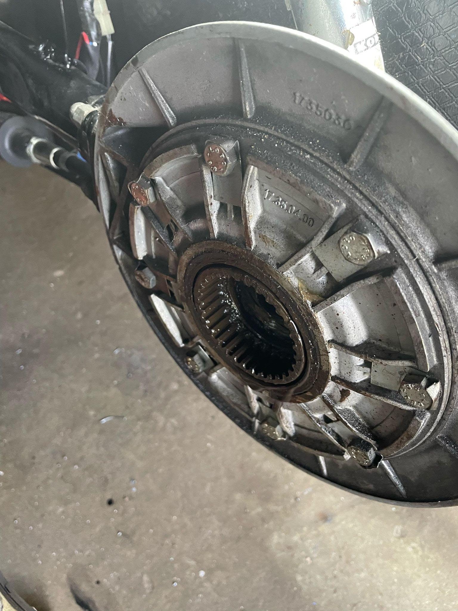

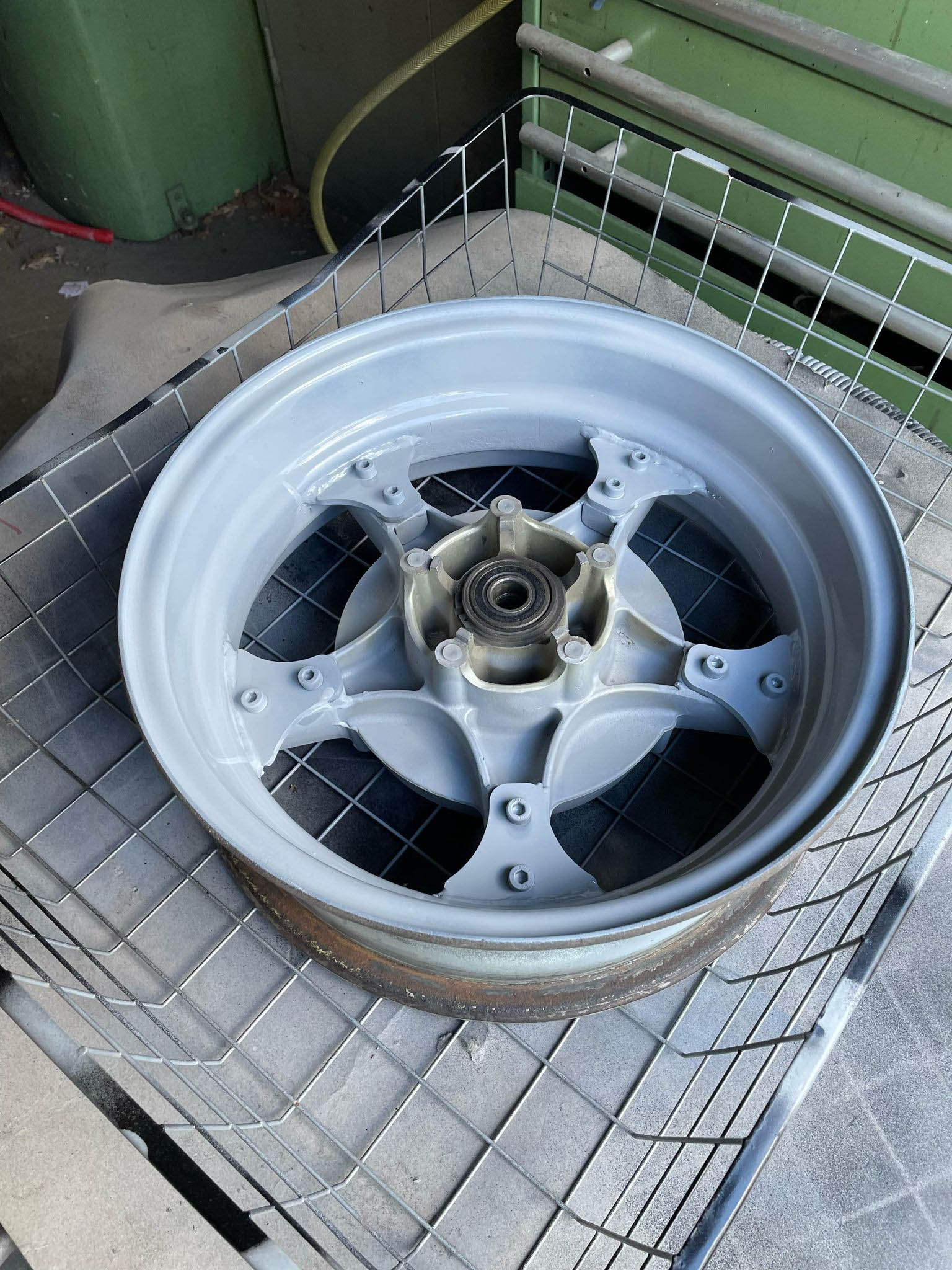

hello, I have plans to make a 15” steel rim wheel for my type 3 , I have a California wirewheel rear swing arm.
I have noticed that the space between the final drive and the swing arm is only 125mm(5”), it is no problem to squeeze the deflated tyre trough this space but the rim will be a problem.
I am using a classic Saab 99 or 96 rim( the 99 has a 5” wide rim and the 96 has a 4” rim)
Has anyone any experience what is the best option.
I think of using a 165/80x15” tyre that will fit with no problem inside the swingarm( with 7,5mm free space)

Henk, I've attached the pictures you sent me, hoping someone can identify what the problem is.

Thanks for posting the pictures I tried it but the file is to big.
It is now converted with a 15” rim that is 5jot wide(5”), but I can’t get it past the final drive and swing arm axle side.
I think a 15” rim with 4jot (4”) wide rim will do the job, please any advice

thanks Alan for your reply, it is certainly what i was thinking of after redesigning the conversion.
I have also noticed that the width of the tyre does no good for this type of swingarm, again i will go for a the 145R 15"tyre and use a 3Jot wide rim.
Henk

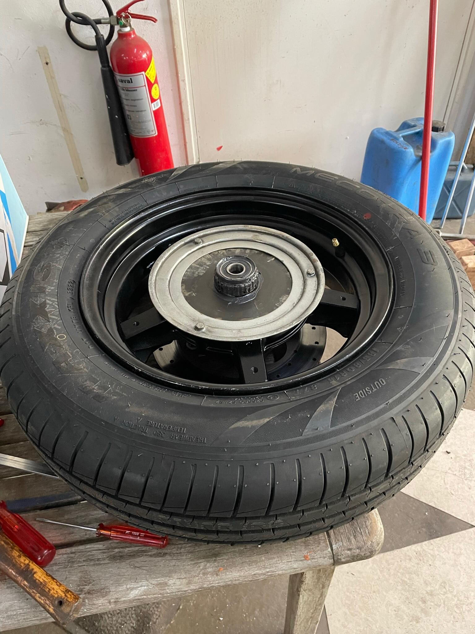

Here a short update on the rear wheel conversion.
The Triking is running beautiful and is nice and steady on the road(the motorcycle tyre felt a bit swaying)
Cornering is giving a solid and good roadholding feel.
All in all a success
Greetings Henk
