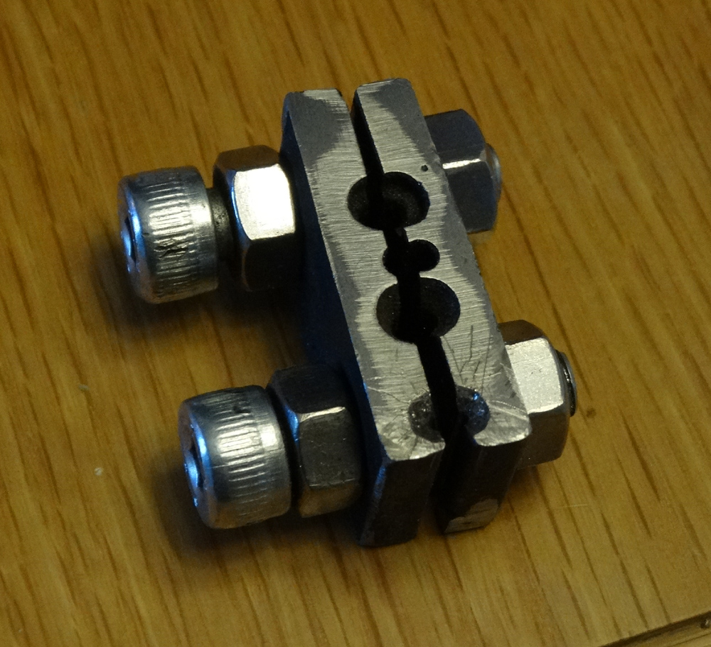

This is my home-made Bowden cable clamp/crimper.
Copes with carb inner wires up to heavy brake cables.
Construction: Bolt 2 pieces of stout m/s plate together with a sheet of not-too-thin paper between. Drill hole on split line same size as inner wire, countersink one end of hole.
When paper is removed, it should grip the wire.
Method:

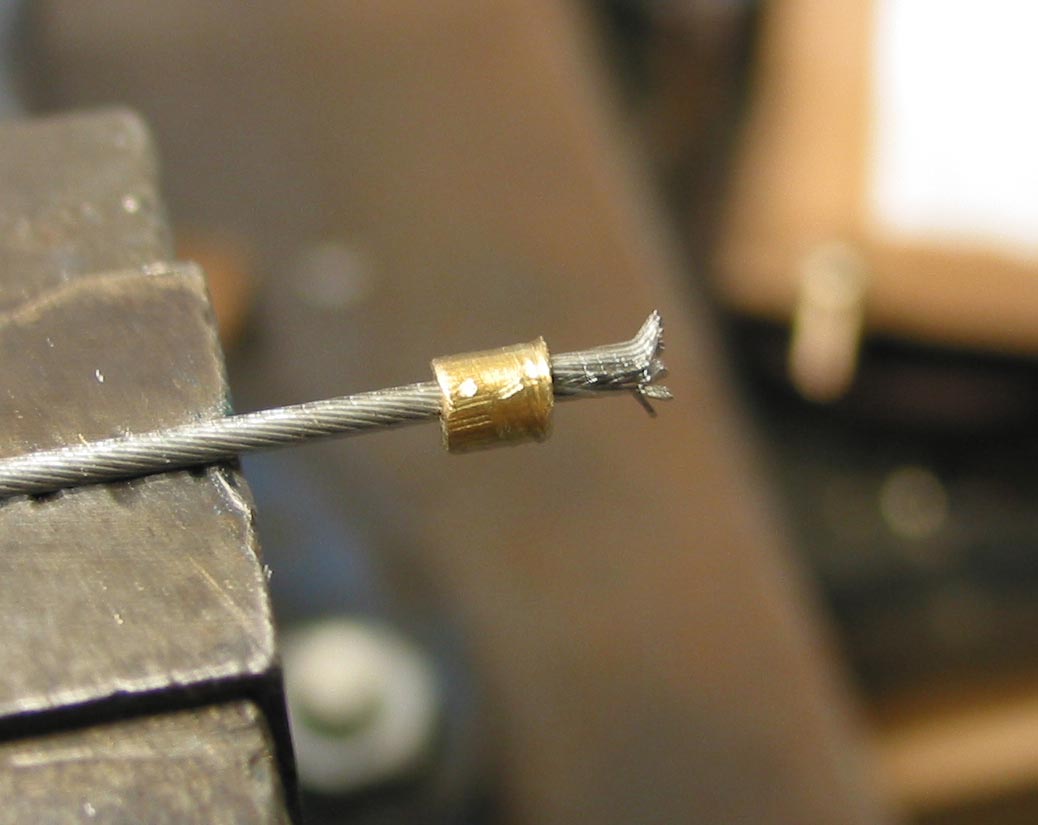

Thread the nipple onto the wire.
Clamp over the wire then cut off to length with a disk cutter. (No fraying.)
Move the cable out of the clamp by a mil or 2, tighten clamp down, then (with clamp in a vice) spread out the strands with a centre punch giving a half ‘birdcage’.
Remove clamp.
Pull nipple into position over spread cable, into the counterbore of the nipple.

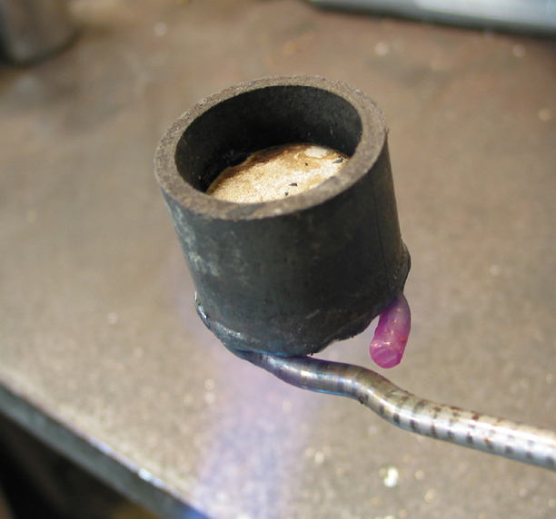

Now to solder.
Don’t use a flame, it will overhead the cable and make it brittle and will break.
Use a solder pot half filled with plumber’s tin/lead solder which you heat up with the flame.
Dip nipple and cable into paste flux then dip into the solder pot. You may need to dip in again till the solder cools down a bit, thus filling the nipple reservoir.
Cool down then file/grind off excess to size.
Or you could use a heavy weight soldering iron. :D
