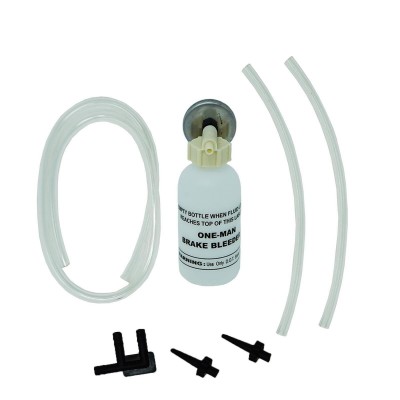

I use one of these [with an additional magnet] and a person to press the pedal.

Archie
Posts: 13
Joined: Sun Sep 30, 2018 9:55 am
Location: UK
Re: Brake bleeding spring maintenance
Post by Archie » Wed Apr 26, 2023 9:27 am
Posts: 870
Post by Richard and Pat » Wed Apr 26, 2023 12:55 pm
Yes, I bought one of these, unfortunately. Badly made most of them. I went back to the bottle on a magnet. Old School it maybe but it is cheap and effective. Beware when choosing one.
