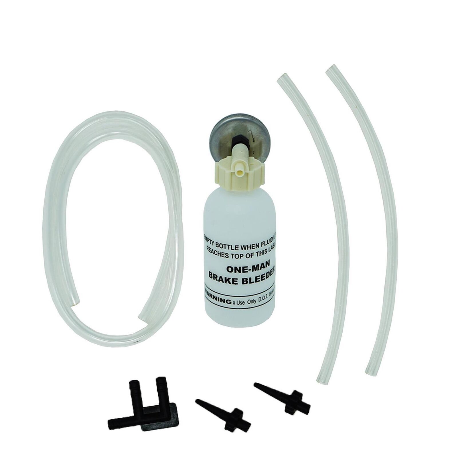

I use one of these [with an additional magnet] and a person to press the pedal.
Yes, if not used through the winter my previous Triking T2 would need a bleed; my pal's T3 needs a bleed after a lay up too. Now I don't know if it is because I have moved the Triking in and out of the garage for various reasons over the winter but I have not yet had to bleed the brakes this year. I did last!

Yes, I bought one of these, unfortunately. Badly made most of them. I went back to the bottle on a magnet. Old School it maybe but it is cheap and effective. Beware when choosing one.
