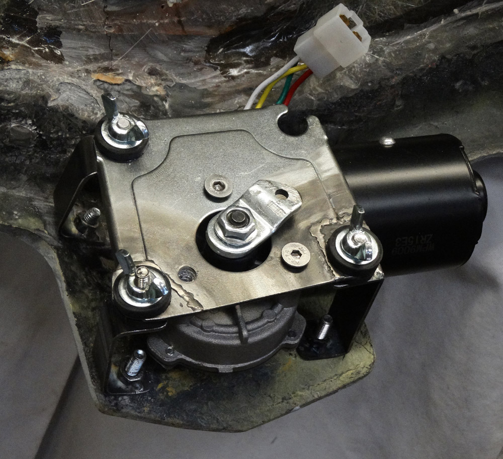

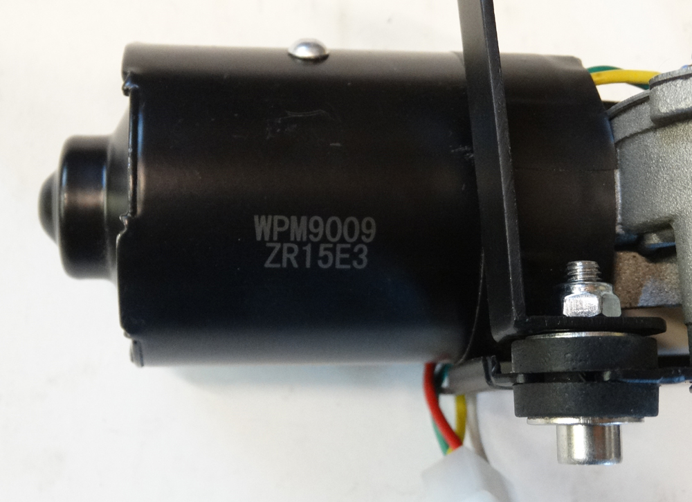

Currently available is a GM model ref WPM9009. 2 speed motor with self-parking circuit.
The basic mounting plate is a bit big for mounting on the available body moulding.
Needed turning 120deg (1 bolt hole).
I reduced the size of the plate, cutting 2 of the cush rubber corners off and welding back in a better position.
This reduced the available mounting points down to 3.
Stand-off brackets (cut from a section of 50mm box steel) provided a good position.

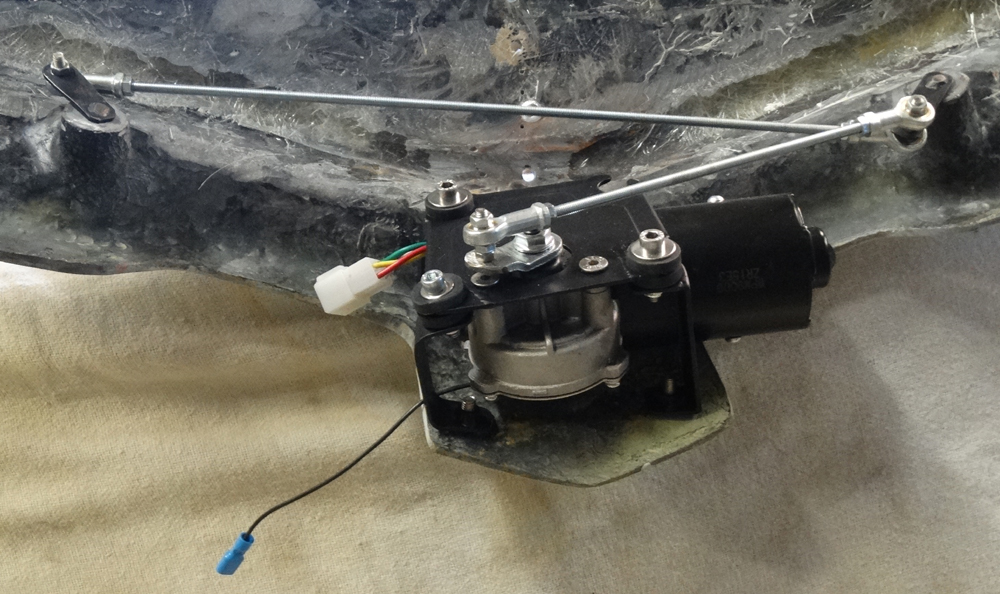

I decided to use 4 rose joints to give a smoother, rattle free operation.
Note position of actuator rods on the motor arm and the wiper spindle levers to avoid fouling on the glovebox and electrics.
It was necessary to put the body in position on the car with the wiper assembly mounted to check for fouling. (Several times)

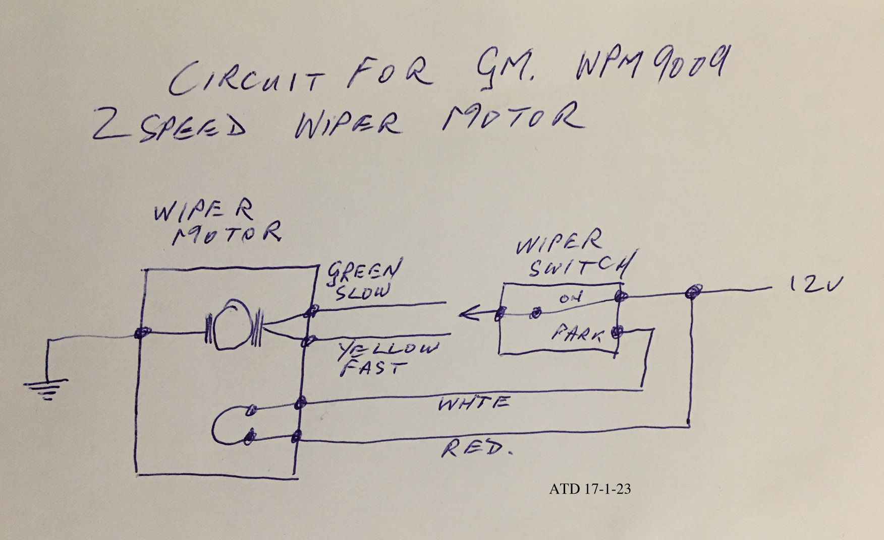

The wiper switch needs to be a change over type.
On gives supply to motor, off gives park supply through the in-built switch.
This could also be achieved with a standard on/off switch and a change-over relay.
I decided not to bother with the 2 speeds, plugging into the fast socket.
Wire connections.
Yellow (fast circuit)
Green (slow circuit)
Red (permanent live to park switch)
White (from internal park switch to on/off switch)

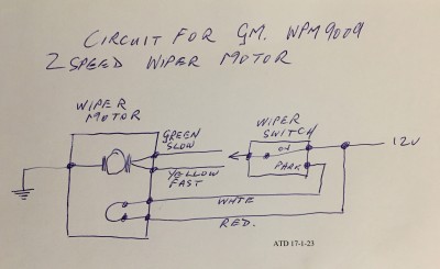

May help to clarify wiring, here is the basic circuit.
When the motor gets to the park position, it turns off the feed to the white wire and
earths the motor causing an instant brake, avoiding overrunning to the next wipe command.
