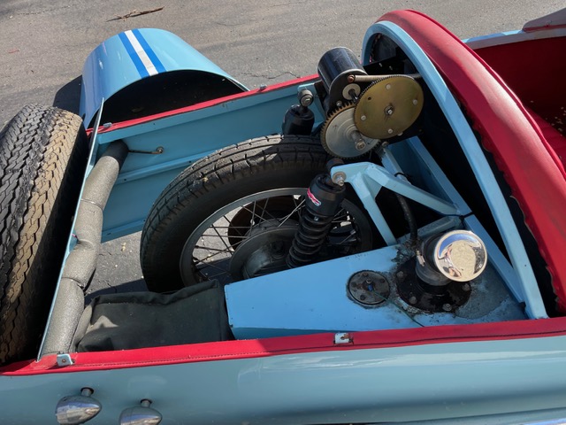

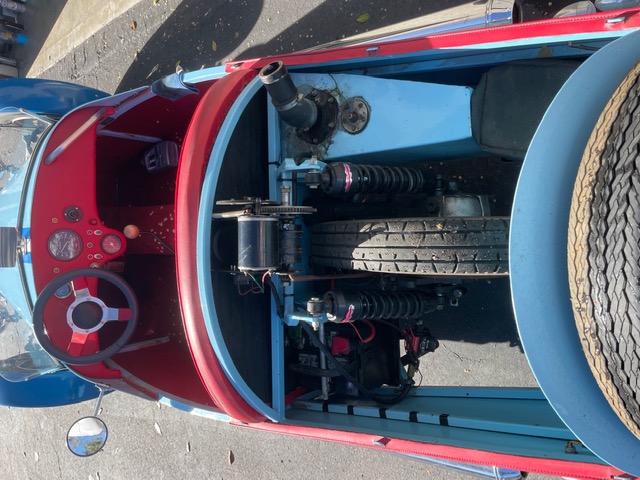

The JZR impemetation I have seen had the starter motor mounted above the rear wheel with a lever actuated friction roller to transmit the motor torque to the rear wheel. A home built caravan mover if you will. A bit crude but I am told effective, as long as the grade is more than the friction coupling can handle. Here are some pictures. I also have a hobby machine shop so would be interested in trying

That's interesting as it takes no account of suspension movement being frame mounted, but in hindsight probably is not that big of an issue.
It looks as if just a gear is driving the tire whereas a wider "wheel" would provide more friction.
There is space above the rear wheel on a Triking with minor structural mods.
I did think about a modified 1,000# winch in similar location.

No direct experience with this arrangement, but it is less intrusive than some of the other designs. It uses a lever to push the friction wheel against the tire (if you zoom in I think you will see a black friction wheel which runs the full width of the tire) with push button/relay to provide voltage to the motor. When not engaged via the lever, the friction wheel is not in contact with the tire. Crude, but no drag on the rest of the system while not in use. Not clear from the pictures whether they just the friction wheel or the whole starter/ geartrain/friction wheel assembly is levered against the tire. Could be done either way I suppose , but just the friction wheel would seem to make more sense and if located at the rear of the tire could provide some cam action to keep things engaged.
