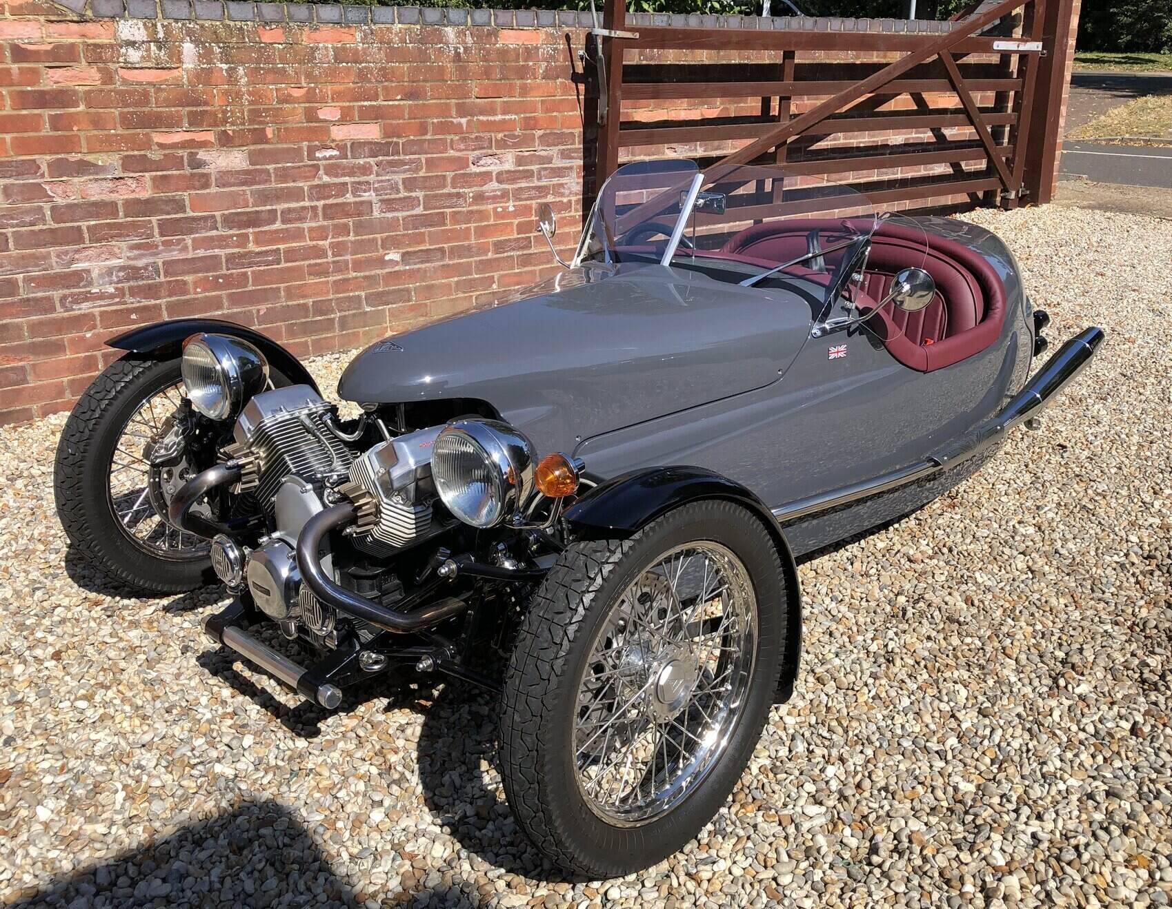

We are done!
The new Triking runs and boy does it run.
The problem was solved by an old email from a good friend. I had noted that the fuel pressure was around the twenty PSI mark and thought no more about it. I understood when replacing the standard, bike Fuel Pressure Switch [FPS] it was used straight out of the box and did not need adjusting. Also that the adjustment was through the hole in the top should it be necessary.
Searching through the old mails to find the one recommending the tappet sizes for inlet and exhaust just to check, as I started yet again to go through a set up, I came across a mail answering a question in 2017 [!] It mentioned a requirement of 40 to 42 PSI from the FPS in the return line. A light bulb moment, a little checking, and looking at pictures of the FPS and sure enough a long grub screw is fitted in the 'adjustment hole' previously spotted. Now I look closely it has a thread in it. Fitted screw and nut adjusted to give 42PSI at the FPS and start him up. WOW! We are on a winner.

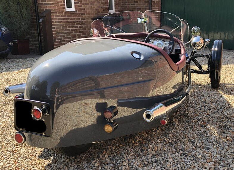

Re: Guzzi Diag
Good to know you found the culprit. The Triking looks good. I had to do a double take as i thought it was mine. Very similar colors.
