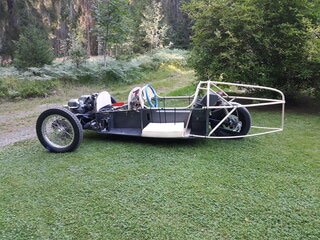

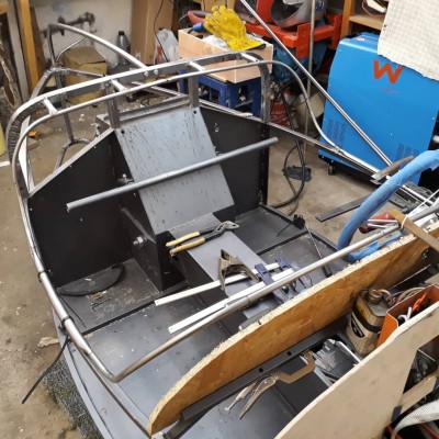

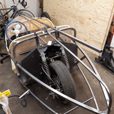

A small step forvard and one backward. Took some electrical tubes and made a sketch of how the frame could be made.
It definetly needs some adjustments before i am satisfied with the lines but it feels like a good start.

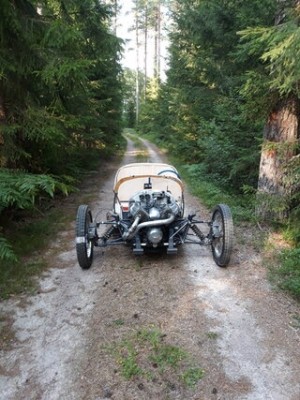

I could not resist a little test drive. Lets say the gravel road at home is not optimal, all wheels loose grip all the time. :D
There is sadly a terrible knocking from the engine, probably the valves. Anybody got similar noices?

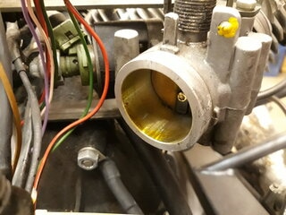

I also found some oily residue in the injectors, is this normal?

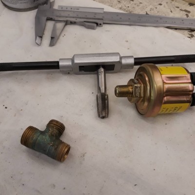

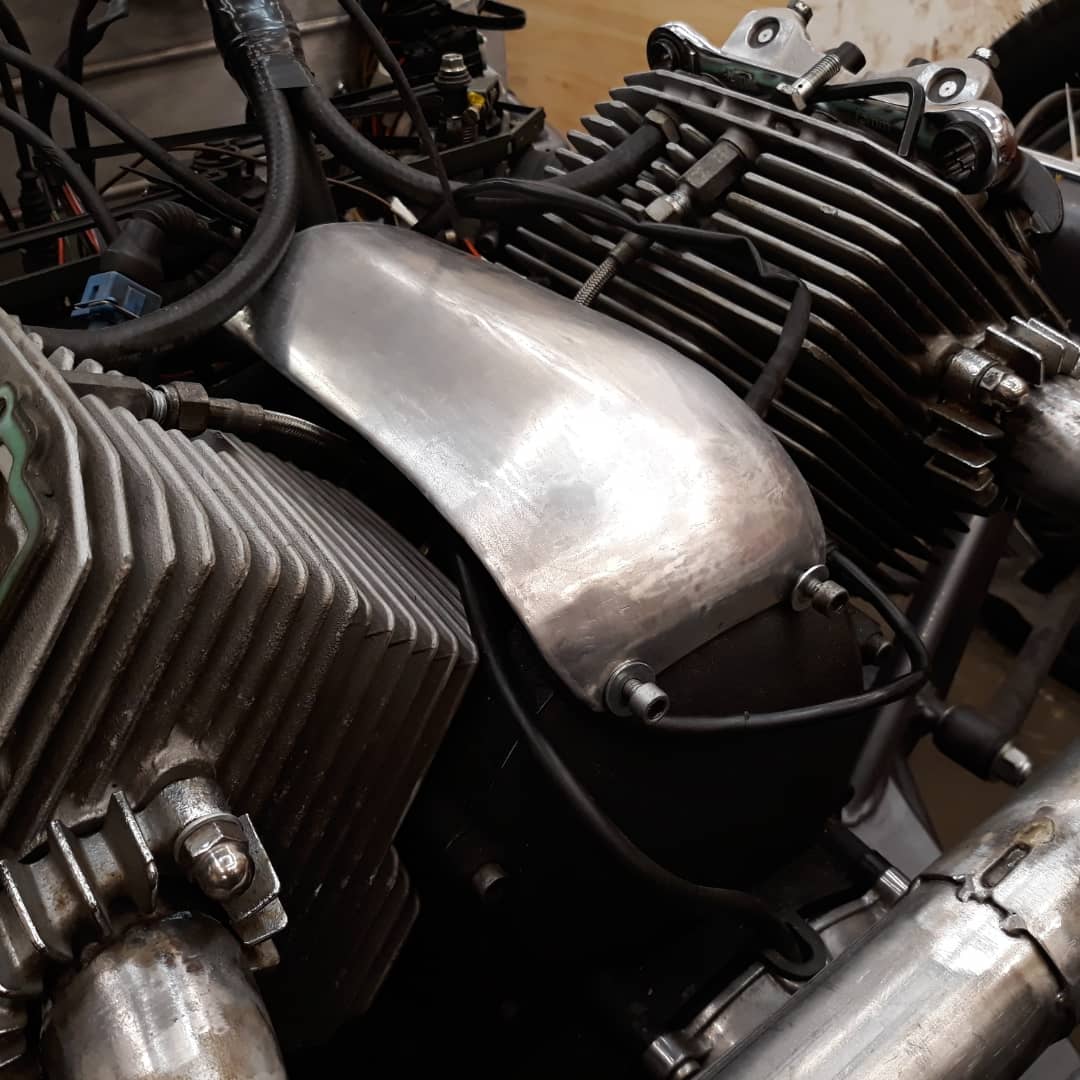

I wanted a oil pressure meter but i'm too cheap to buy the kit from Stein dinse (14 e! for a banjo bolt) so i made my own as usual. Started with a left over coupling, brazed on a bit and threaded with 1/8 npt.

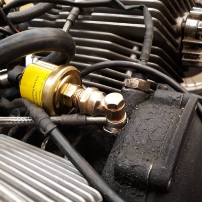

Fitted.
And then covered it all up.
I finally took curage to open up the oil sump but there was none of the glitter of sadness that i feared. Will change the oil filter even if it looked new and has ordered a recall kit that will come in a month.

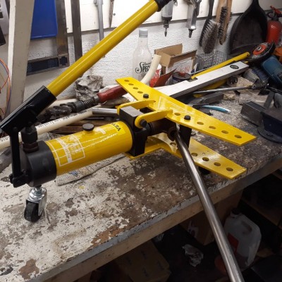

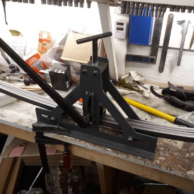

Got two new favorite tools. And a new welder too.
And has finally started replacing the electrical piping with proper steel. A lot of measuring, cutting and some words i wont translate :D but at least its going in the right direction again.
We bought a new old house without a proper garage so now i have a real deadline, it got to be ready before midsummer. With two parallel house restorations it will be a buzy but fun sping.
