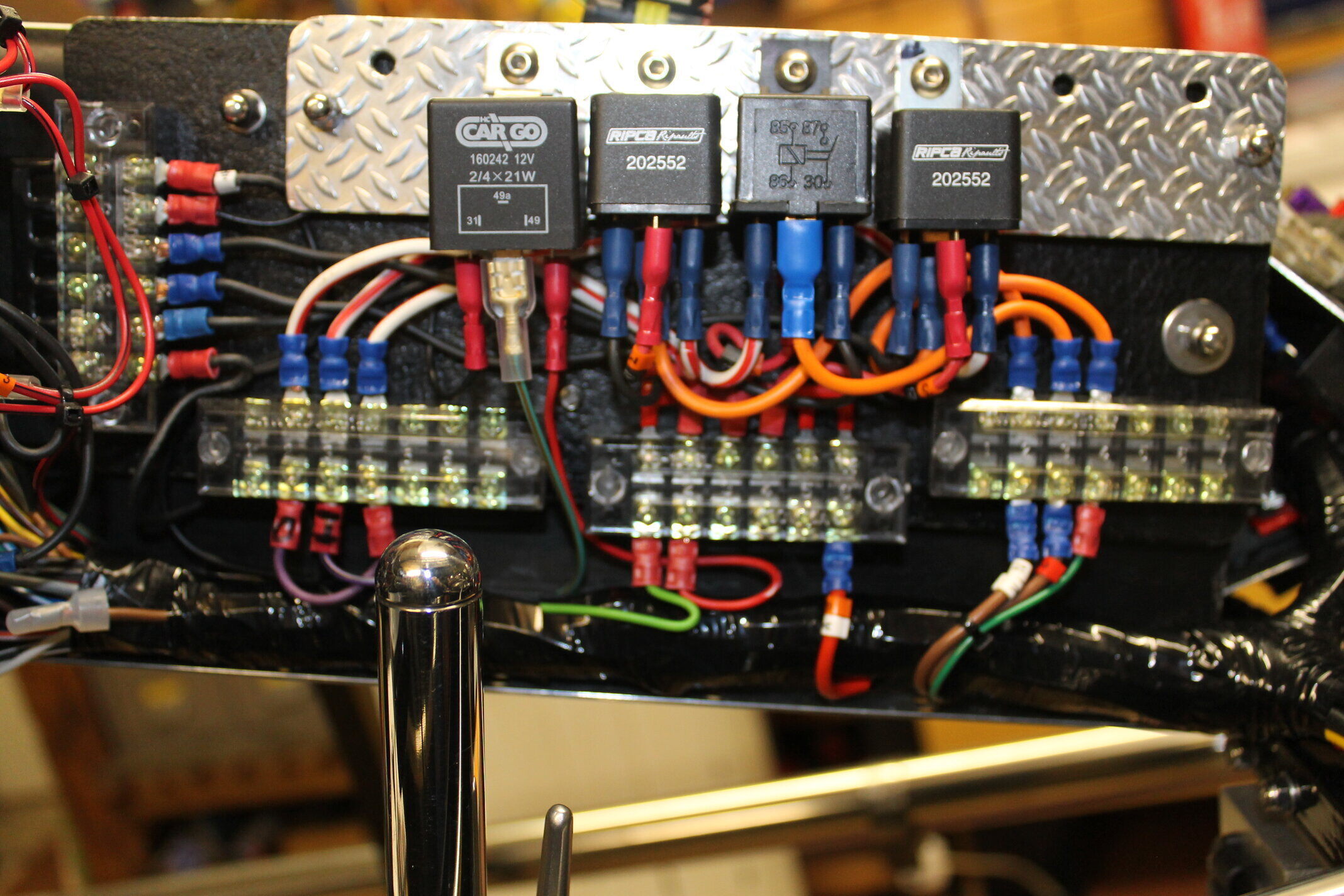

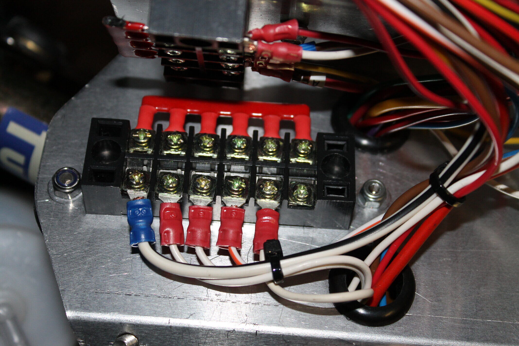

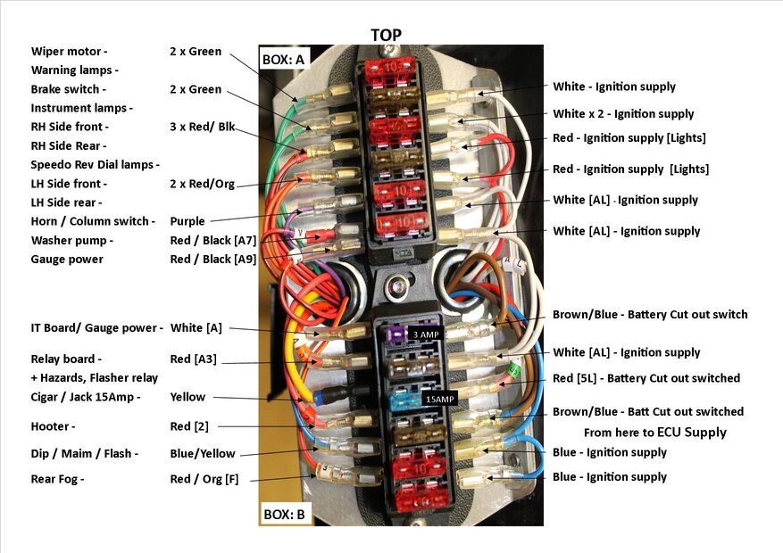

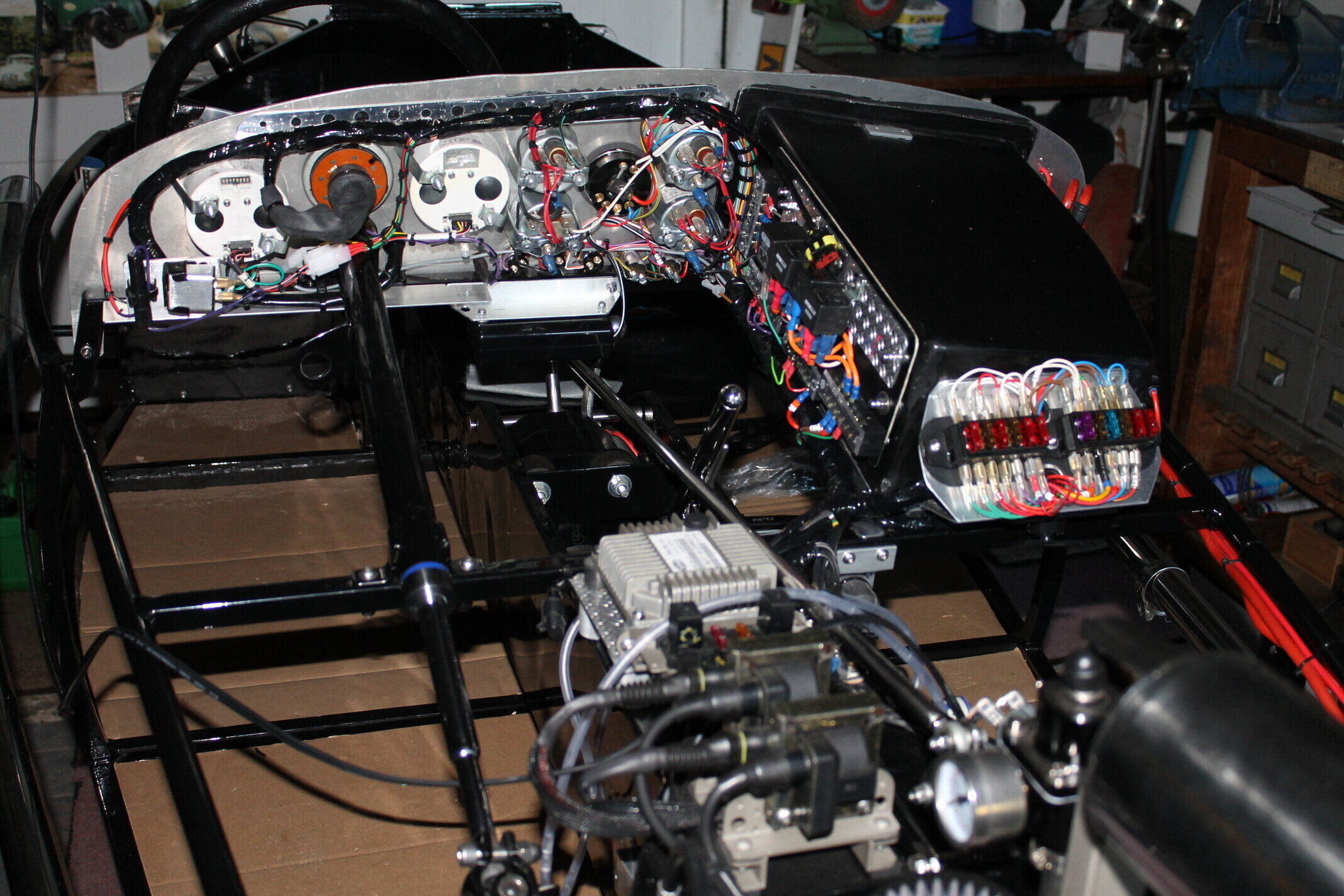

Several of the larger boxes bought and tested for size and convenience but this is what I decided upon [there are other options]
- Posts: 927
Re: Fuse box
Picture one underside of fuse box
Pic 2 Fuses
Pic 3 Position of relay board alongside glove box and fuse box on the front.
Pic 4 Relay board. I could have used smaller gang blocks.
Relays: Flasher, Twin horns, Hooter and Brake light switch. Been through three in eleven years on Squeaker one answer is to put a relay in.
Silver shaft showing is a Trigger hand brake which is the dog's biscuits and makes the hand brake most effective, easier to operate for a taller person and no need close enough to get thumb on the end to press a button. Magnificent quality too. Designed by the second best three-wheeler designer Richard Oakes. [Al number one].
Pic 2 Fuses
