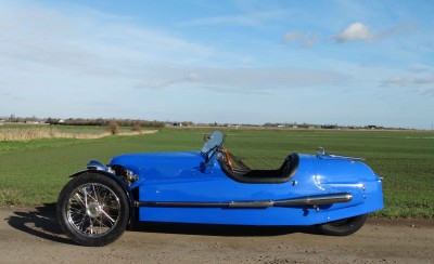

It was photo-shoot time today (for insurance agreed valuation) after fitting new tyres all round.

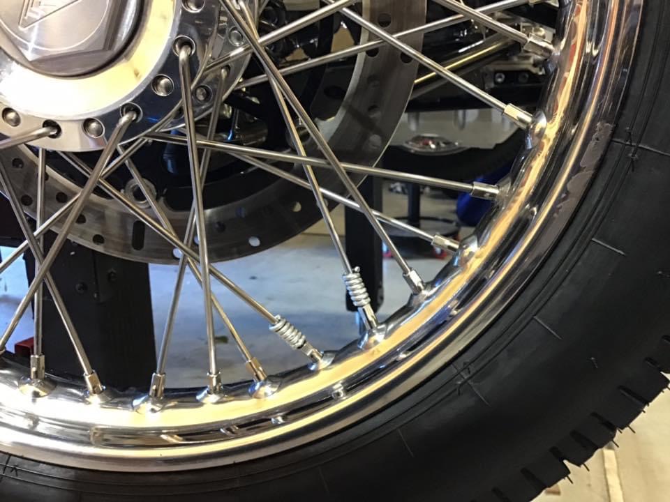

Fronts were mounted and spin blanced by the same place, but the only weights they had were big lead squares stuck to the rim. Didnt matter in back being unseeable, but were an eyesore on the gorgeous lace fronts.
My solution was an old school harley racer’s tip to wind the spokes with equivalent weight of heavy solder wrapped around the spoke, splitting the coil if the weight landed between nipples They’re on for good but just to be sure i put a drop of super glue at the “top” so no chance of them sliding around.
