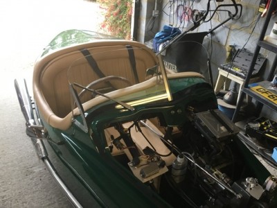

Big thanks to John, Richard, and Mark, for the info that stopped me cocking up my registration application. I do think the Gov websites are very misleading but I was about to submit form V55/4 and it needed to be V55/5 as I am applying for an age related registration. Have spent most of the day sorting this out but am fairly confident that it is now correct. In between sorting this out I have started fitting the windscreen following some good guidance from Alan. Tomorrow should see black goo everywhere but hopefully not on paintwork.

Good to see you're almost on the road with the Triking Tony. I used plenty of masking tape when I did mine, hardest job was getting the right amount of sealant on the flange - enough to avoid air pockets but not too much so it squidges out everywhere - it's awkward to clean off any excess once the screen is in position due to the narrow angle between it and the body. Good luck!

Carefully followed Alan’s guidance and screen went on with no dramas, and more importantly no black goo on paintwork. The only cleaning up to be done is on the glass and the metal brackets, once the goo is fully dry. Once that is done it just leaves getting my “cheapo” windscreen wiper working - I am using a Landrover type wiper motor (approx £25 on eBay) with a simple linkage driving a wiper on driver’s side only, although it would not be too difficult to make it drive two wipers.

Quite pleased with the finished windscreen, and have now fully fitted the single wiper. Wasn’t quite straight forward as I had set it up to park to the centre of the screen, so had to reverse the arms on the motor and wiper spindles and it then parked correctly.
