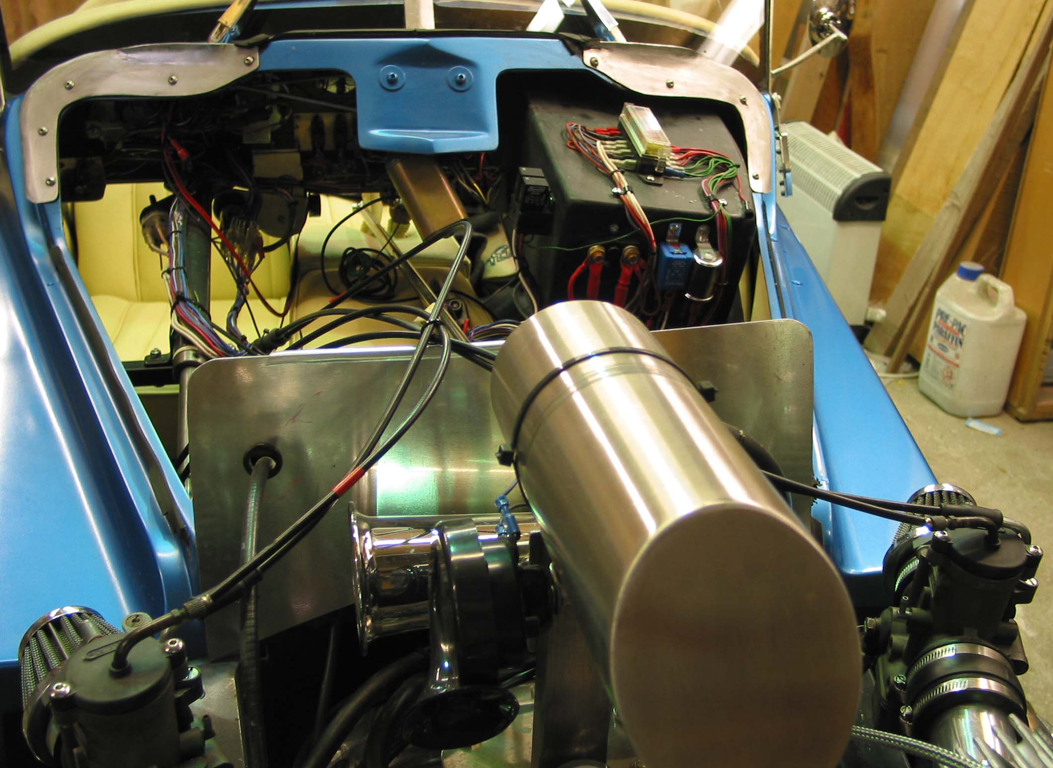

Very early on in my Triking ownership, I discovered that when it rains, water drains off the back of the bonnet, onto the rebated section of body just in front of the windscreen, and then drips/runs onto the legs. Not good.
Managed to overcome the problem by diverting the water with a piece of aluminium riveted and sealed to the body, forming a gutter taking the water down the side of the body.
Doverhay has a drawing of the component that can be printed out on A4 paper and used as a template. More details to follow! May help someone.

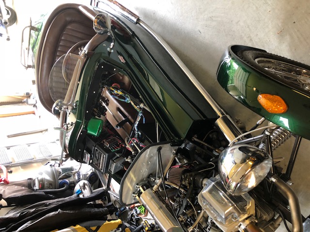

I developed a set of those, too, with my own template. You can seen them in the attached photo.
