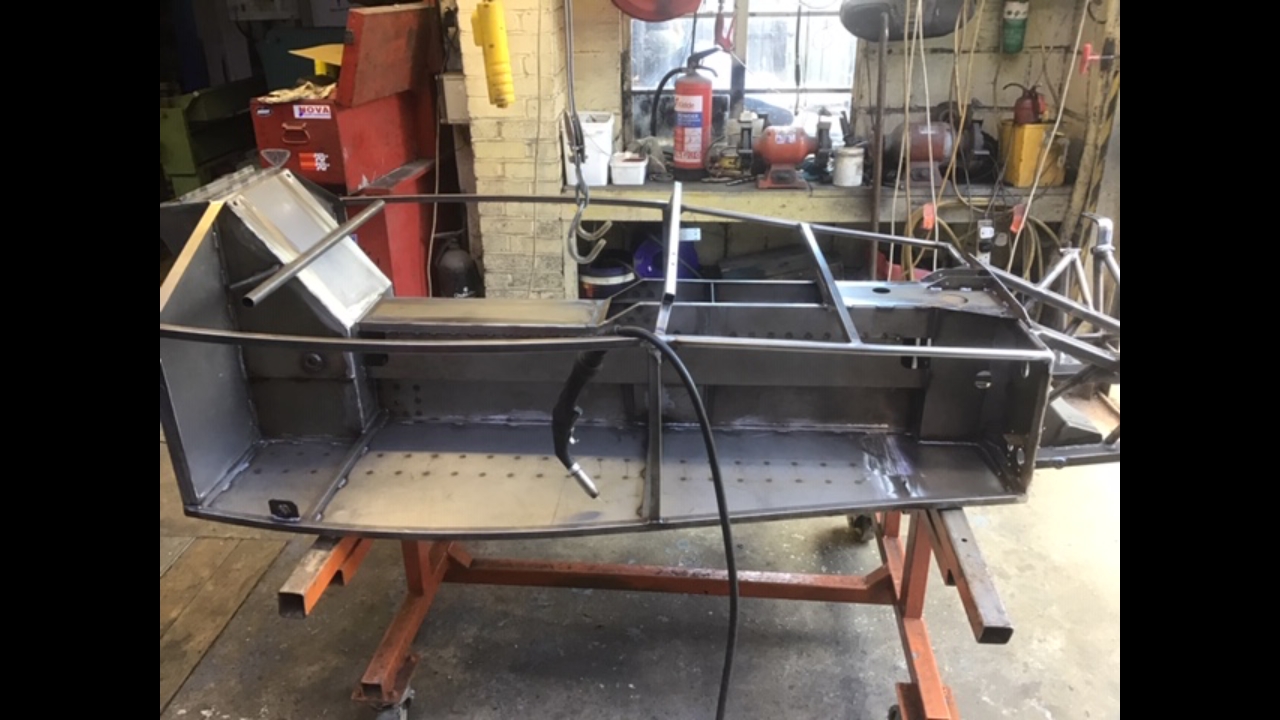

Got än email last night that the frame is being bulit. On the outside my beard may be getting more gray but on the inside im am a twelve year old boy getting the best christmas present ever.

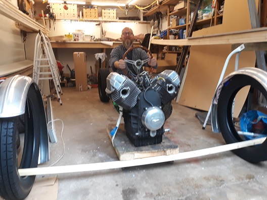

Finally all four wheels have arrived and i'am just waiting for the parts in between.
Recommended Metzeler in the front and Continental for the rear. The fourth wheel was sold as "brushed aluminium" but i would more call it whipped. Hopefully it can be polished to a nicer finish.
The fenders needs som adjusting but will probably fit fine.

Excellent news! Where did you find the mudguards [fenders]? I have just fitted some similar but shorter length so will need some mudflaps added. I had to pack out the mounting and on the ones I found cut out the sides a little to allow the wheel to slide on / off.
