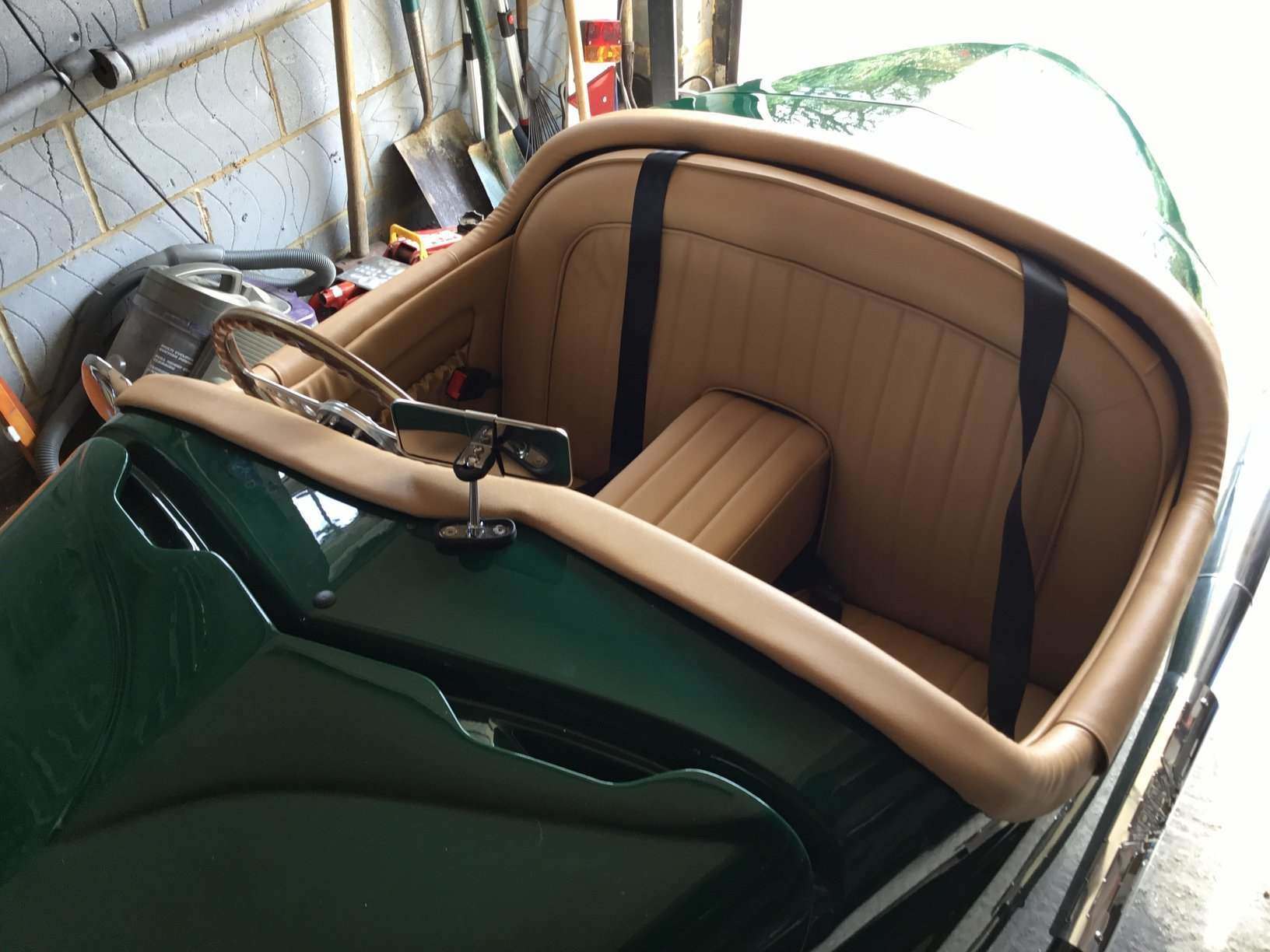

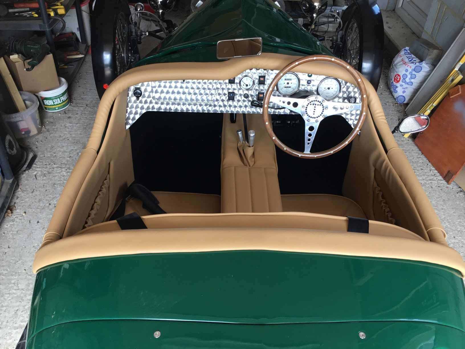

Post by Tamos » Wed Apr 08, 2020 2:41 pm
Build nearing completion. Have glued the vinyl to the f/glass cockpit roll but have not yet fixed roll to body, probably will glue in place. Took 2 days to get satisfactory result stretching vinyl over roll and minimising creases on corners, end result acceptable but not perfect.
Could not resist fitting rest of upholstery to see what it looks like, and I think it looks absolutely frigging gorgeous. The colours go together really well - thanks to Nicki for help and quality workmanship.
Just got carpets to sort out, then have to wait to book MSVA.

Post by Richard and Pat » Wed Apr 08, 2020 4:09 pm
Looking the Dog's biscuits Tony.
Well done.
Re: Build progress
Post by EricStarmer » Wed Apr 08, 2020 4:49 pm
Looks great, Tony - the green and tan go really well together !

Dreamer
Posts: 31
Joined: Tue Mar 10, 2020 7:54 pm
Location: Malta
Re: Build progress
Post by Dreamer » Wed Apr 08, 2020 8:37 pm
Congrats. Very good result and a nice colour combination. When I upholstered something for my car in vinyl and got creases on the corners I removed them by using my wife's hairdryer, not heat gun. It's amazing how it stretches
