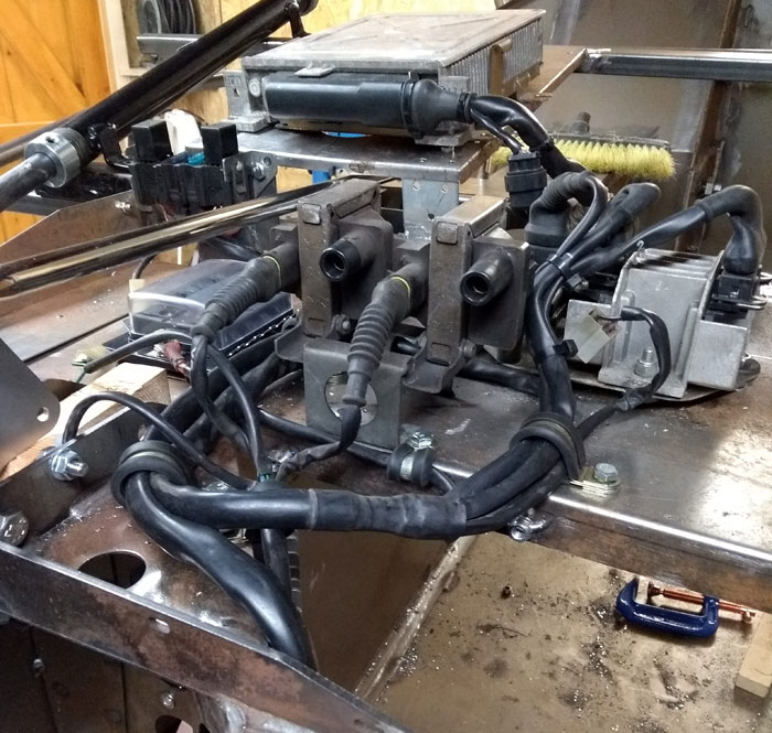

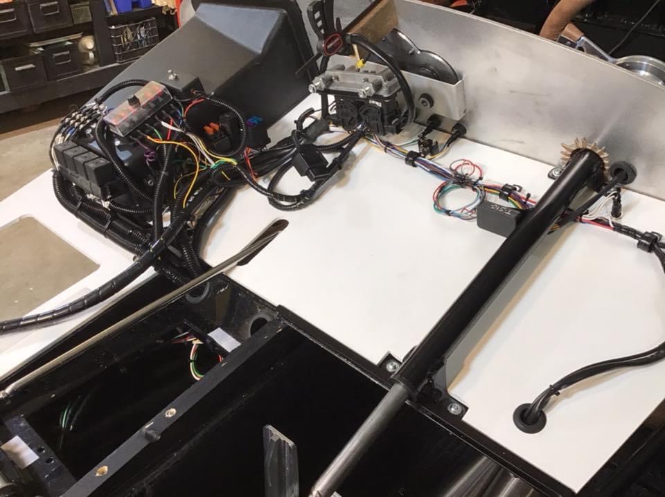

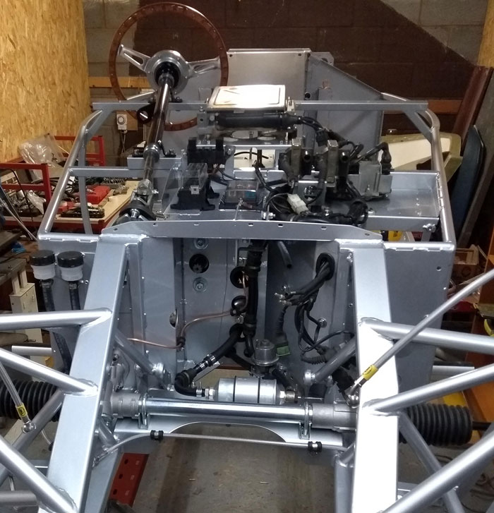

One of the challenges of building the Triking is finding a way to mount all the various electrical components in a tidy and methodical way particularly within the constraints of the engine harness. I think this is harder with the older Californias (like mine) which have a large ECU and other components that the later Guzzi engined bikes don't have. On both my Triking builds I fabricated a tray above the passenger footwell to mount these components on as well as a new fusebox and relay box. The ECU in both cases is mounted above the tunnel on a small tray. I've attached a couple of photos of my current build, one before the chassis went to the powder coaters and then afterwards with it coated. There is really no right or wrong way of doing it provided one mounts things like the ECU on rubbers mounts (as it was on the bike) the cables are properly clipped down and not made to go through severe angles and they can't rub together. If you look under the bonnets of the Trikings at a meet you'll probably see many different ways people have mounted their components!
