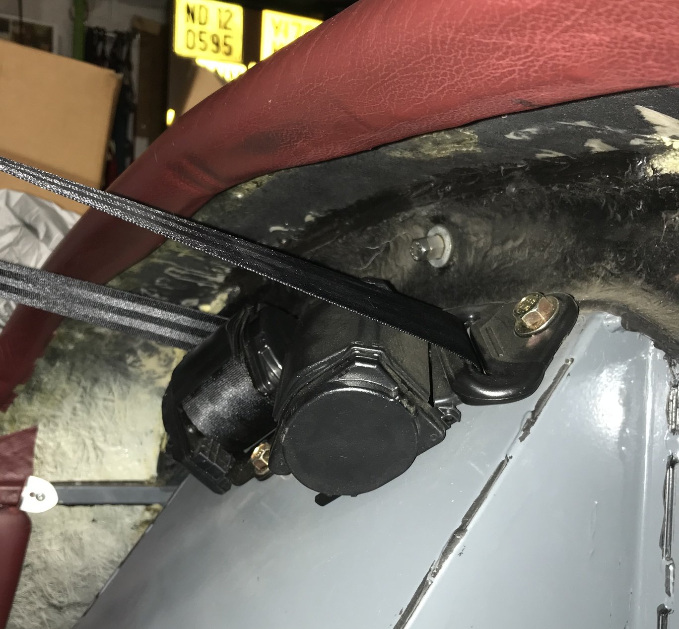

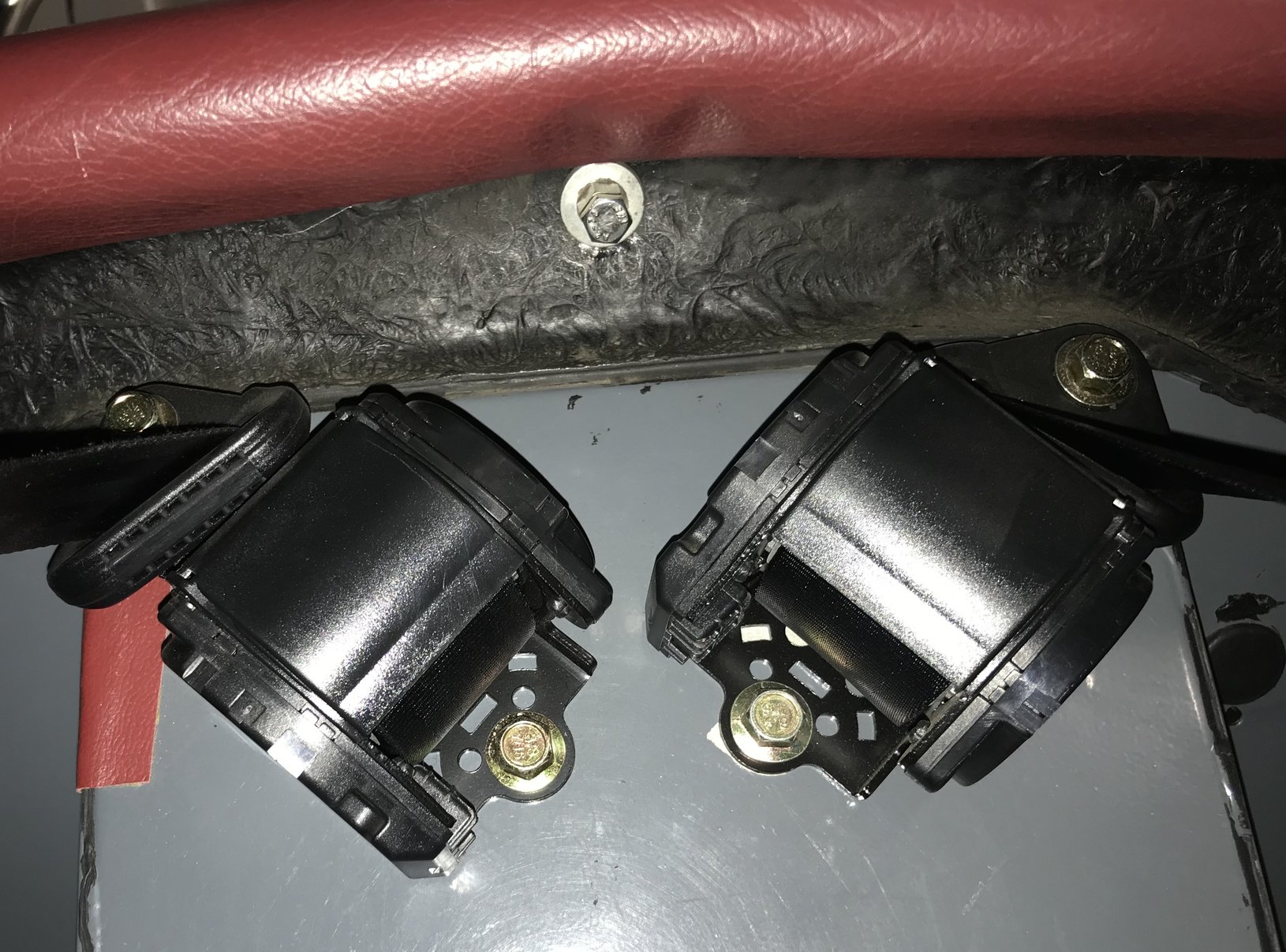

Good morning JFerg,
I used these belts as they can be mounted at an angle:
2x Universal Inertia 3 Point Seat Belt 3m Length 44cm Wire Buckle Ends E4 UK VAT
In the UK: https://www.ebay.co.uk/itm/2x-Universal ... SwPH9ZgKYq
The static end is fitted to a steel bar in order to be able to reach the buckle.
As you will see they are mounted in dead space behind the seat and the belts come through the gap between seat top and body. Pat's side we sometimes have to inch the seat back forward a tad to allow her belt to retract.
Any more info let me know.

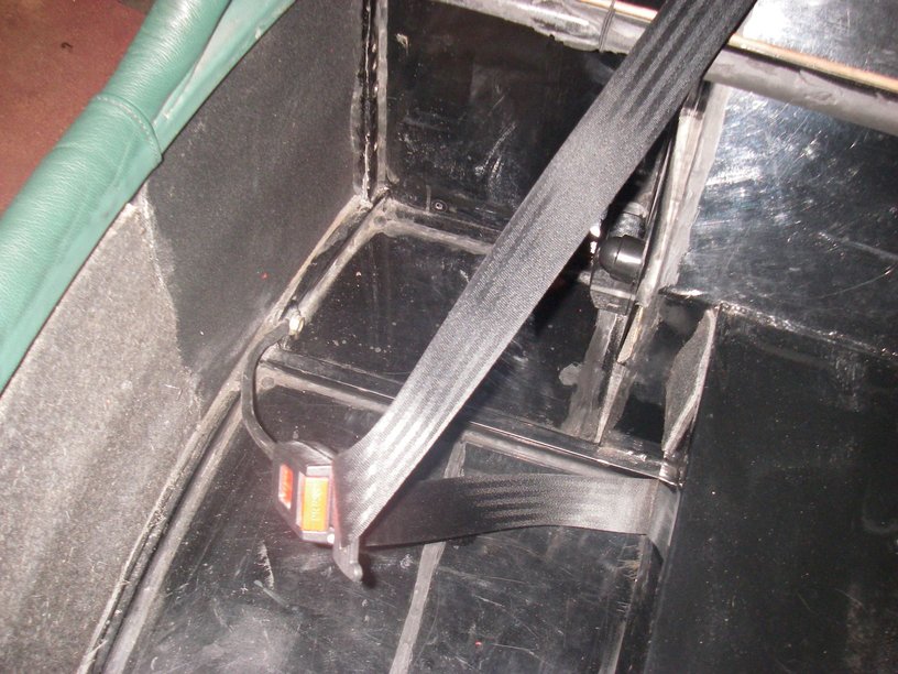

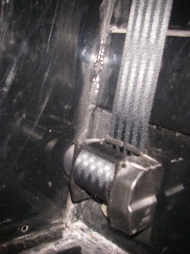

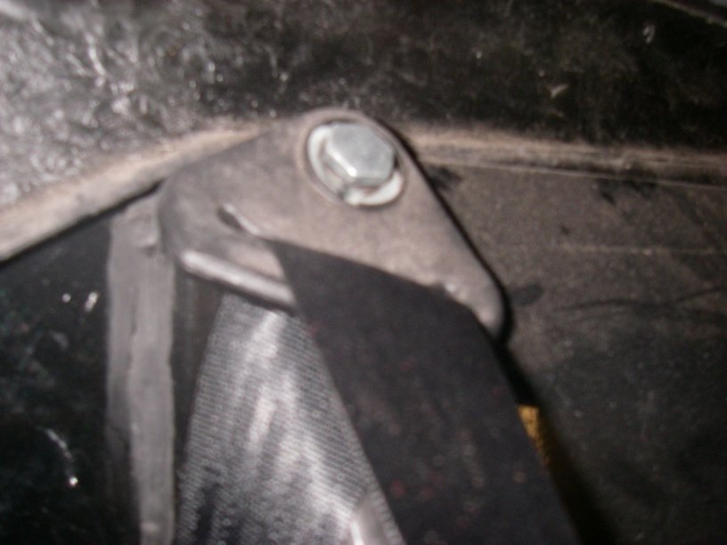

Hi JFerg
A different way with the straight pull reel mounted low down and the belts being turned in the dead space behind and as near as is possible to the top of the seat back.
Works well although care is needed in loading luggage behind the seat so not to trap the belt recoil.
However Richards compact system looks to be very good.
Apology for the very poor picture quality
