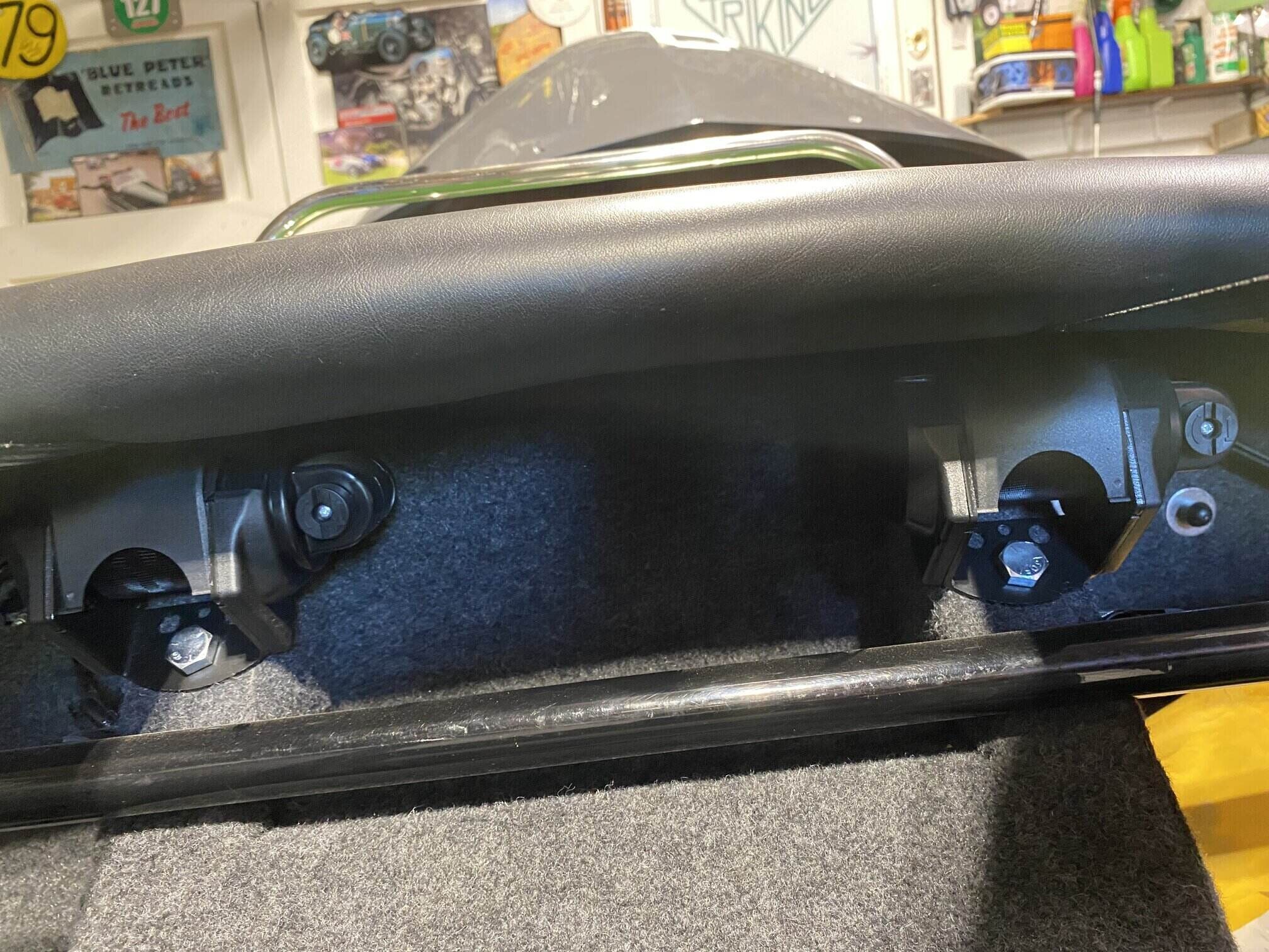

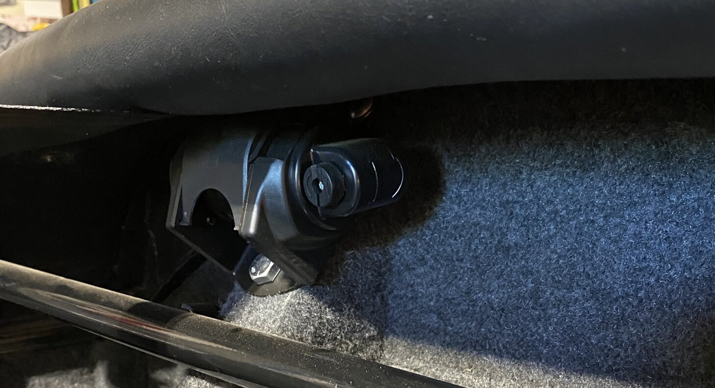

Post by Richard and Pat » Mon Jun 23, 2025 7:51 am
This is how I have done it.

Thank all of you for the help and pics on mounting the seat belts.
