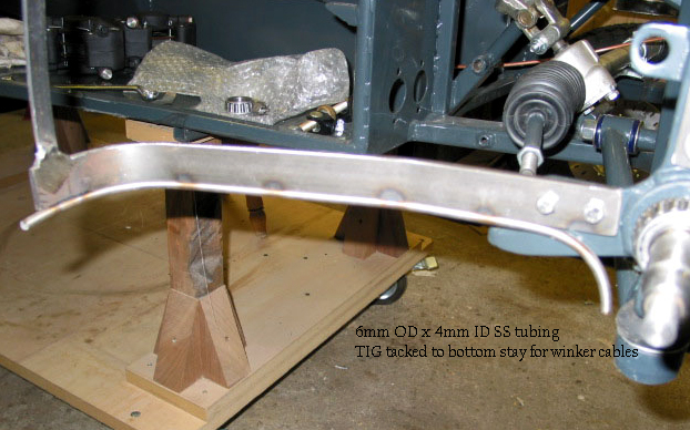

I've put indicators on the mudguards, hid the wires in a stainless tube tacked to the under edge of the mudguard bracket then up the underside of the guard. 2 wires needed.

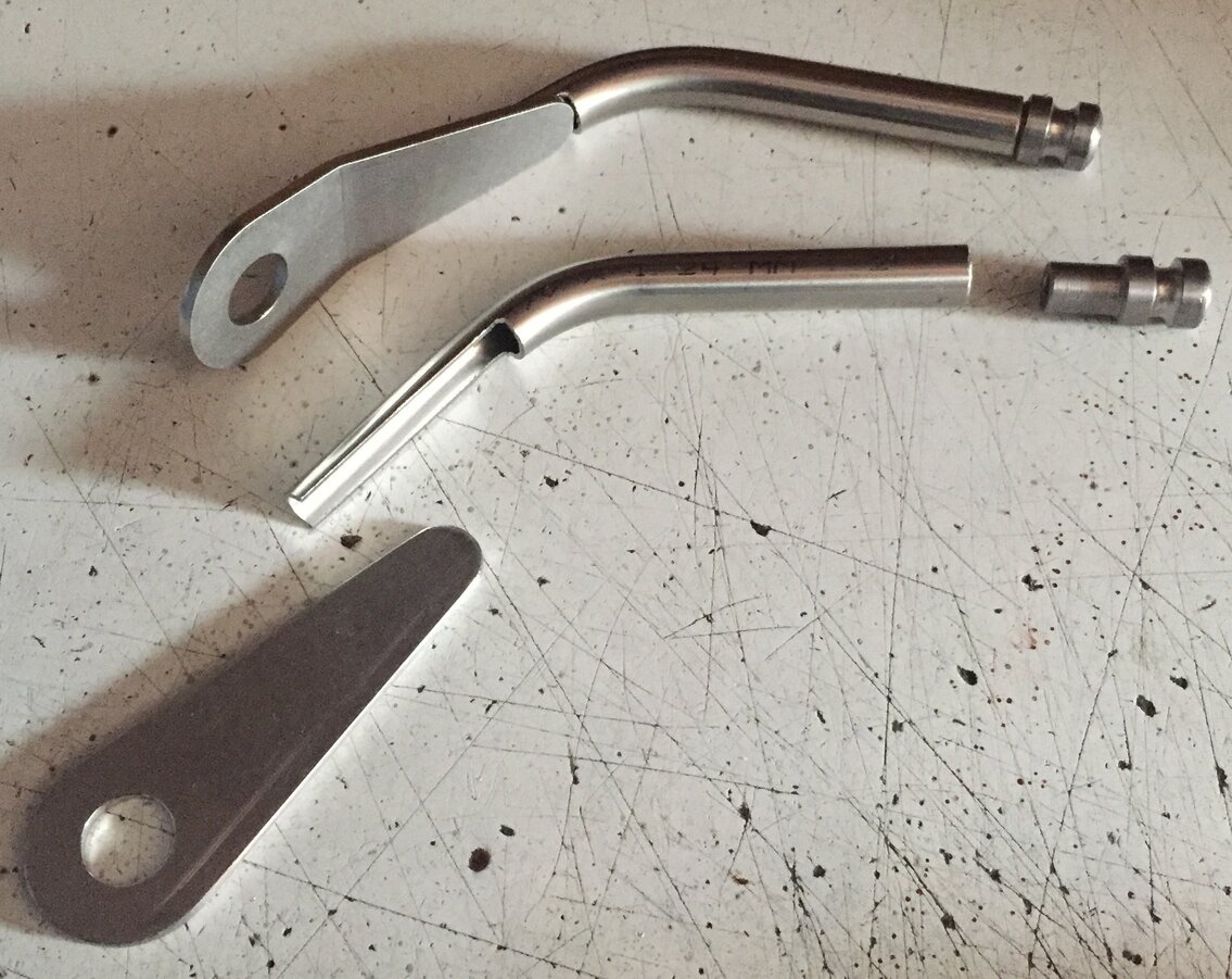

The magic tube.
Cable then glued with black stuff to mudguard and up to light.

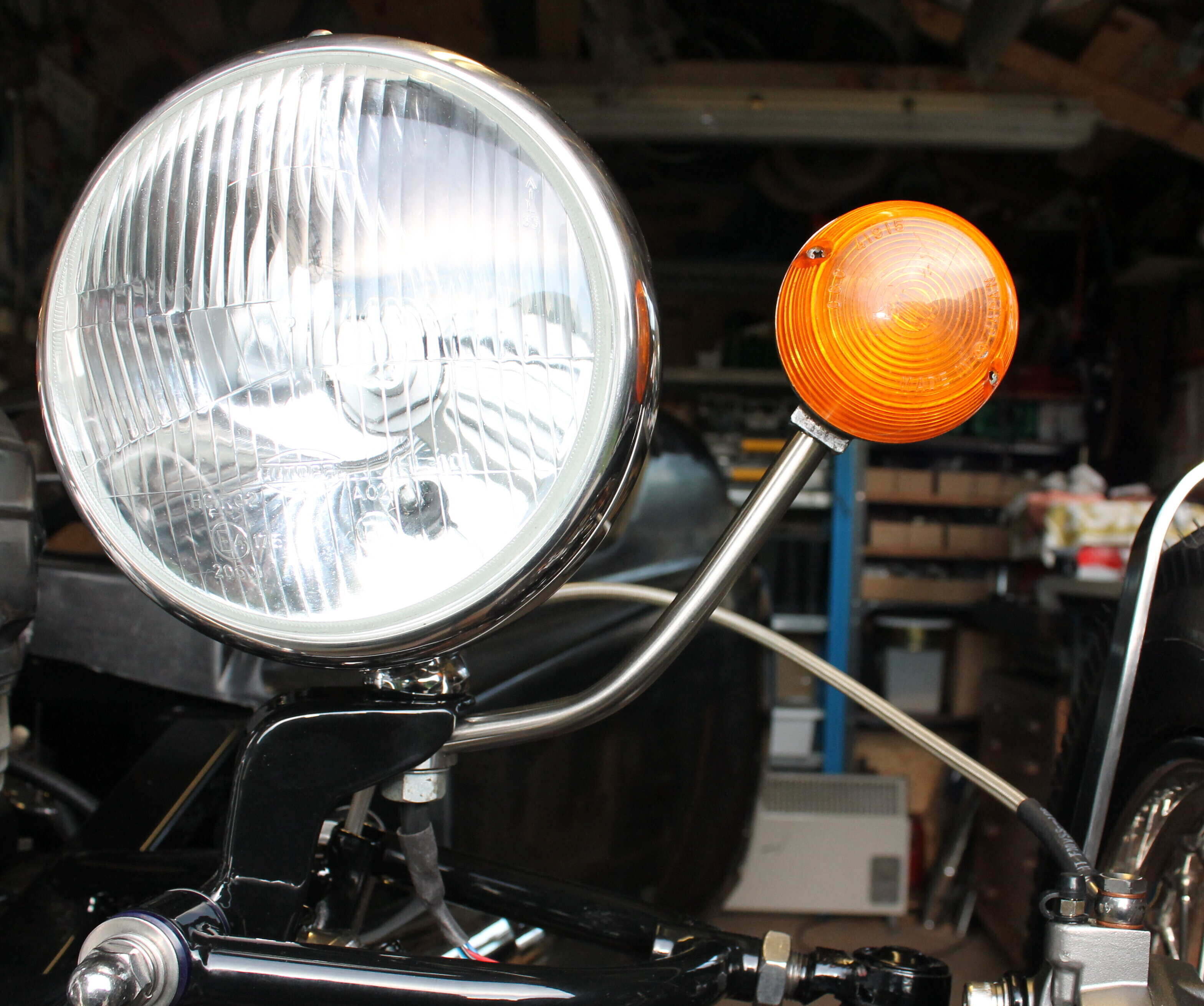

This was my solution using the same lamps as the Type 1's and giving a good clear signal.

I shortened the Headlamp mounting post too so no threads showing below nut.

My picture of 30 sep shows a s/s tube to tale 2 thin wall cables, indicator and ground. Don't rely on chassis / suspension for earth.
I then glued the cables to the outer edge inside the mudguard with black PE adhesive, not in direct path of debrit from tyre.
