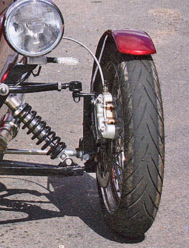

Post by frederick » Fri Nov 02, 2018 11:06 pm
front rim size is not listed on any of the spec lists and the parts link on the home page is el morte.
I'm guessing 18" dia? what's the width and recommended tire profile. I notice the demo T4's fronts appear more rounded and motorcycle-ish...you can tell by the dirt and wear pattern in the T4's front view in that kit car's article (attached).
Is that for easier/quicker steering? I note in pics of the M3 the front tires are more flattish like you'd see on a sidecar.
Tacking this question on for convenience...what is the actual benefit of those oversize rocker box covers besides appearance.

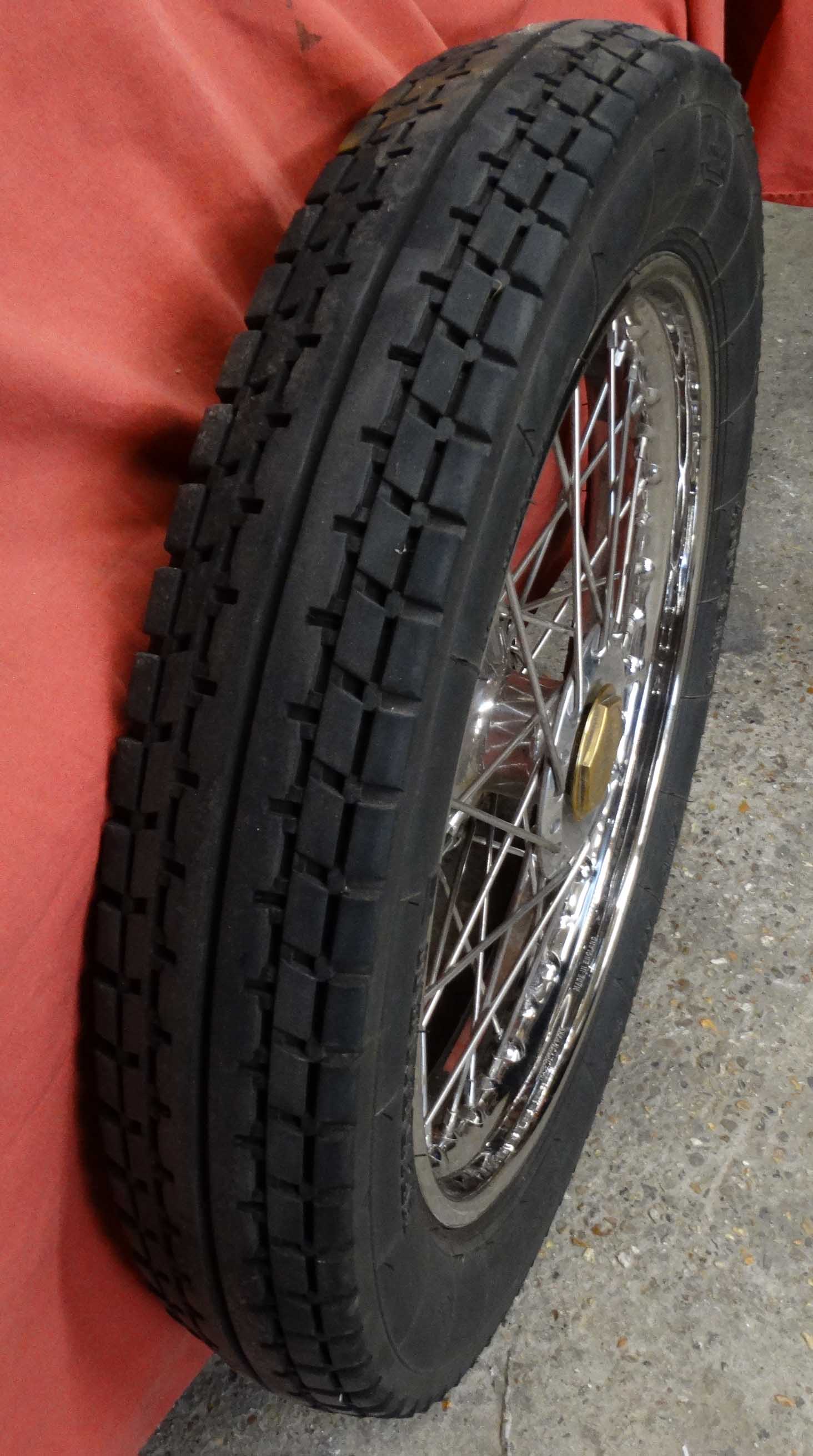

Well Fred, I never looked at the tyre size, but I can't see Al deviating from the standard Triking 18".
I'm running 400 x 18 MC Heidenau sidecar type tyres, designed for an upright position as opposed to bike tyres that lean over. Makes sence to me.
They give excellent grip wet or dry, you do have to read the road surface with any 3 wheeler and drive accordingly. Just saying!
Mine have done 9000mls so far and still have 2mm to go before the wear indicator strips.
