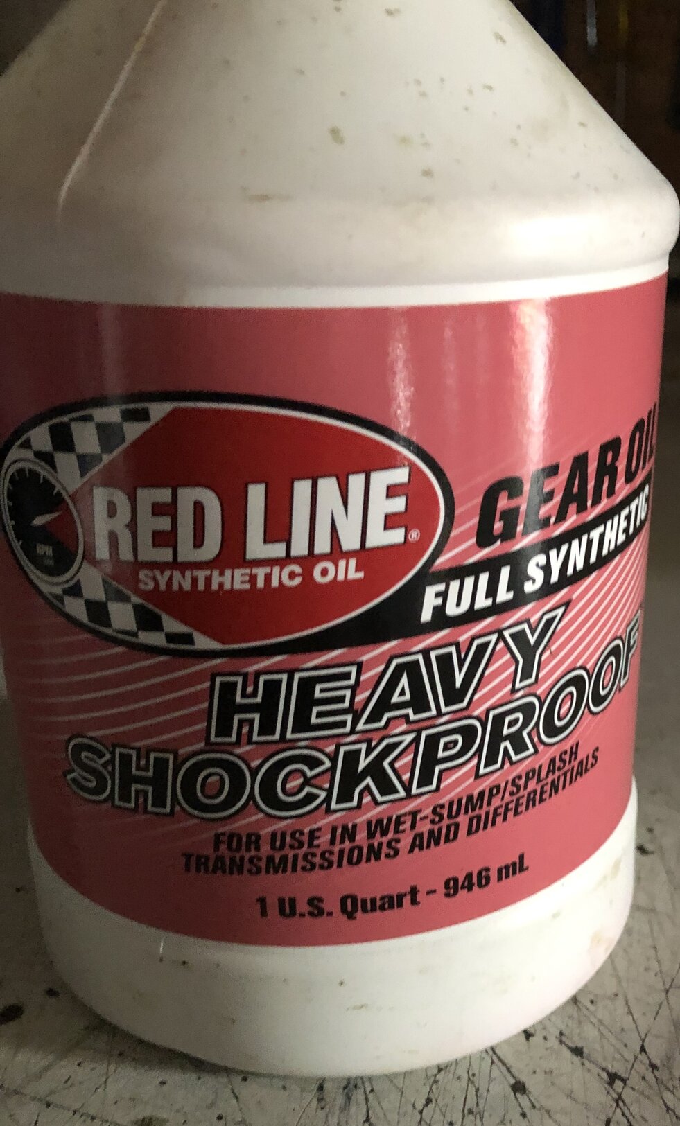

For the rear unit I use RedLine Heavy as picture.
Hope this helps
