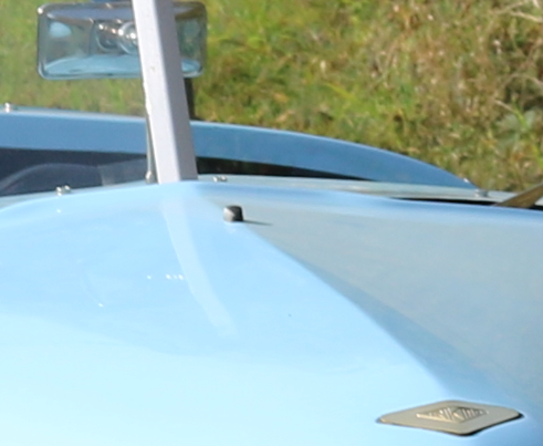

You'll need washers for the MOT. I've done mine with an electric pump and long hose to a nozzle on the bonnet. The long hose enables you to lift the bonnet up and detach the hose from the nozzle - it's a plastic hose so easily pushed on and off. I set mine some distance along the bonnet as I used a single fitting with two outlets. Close up below to show the nozzle on my old Triking.

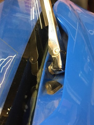

Post by Robmason » Mon Sep 05, 2022 4:16 pm
If anyone was interested, attached photo shows screen washer fitted to T4. Works reasonably well and the washer design allows lots of adjustment to the jets. Thanks Tony for the idea.

Post by Weg » Tue Sep 06, 2022 8:09 am
Where is the picture Rob?
Email it to me if you are struggling to attach.
