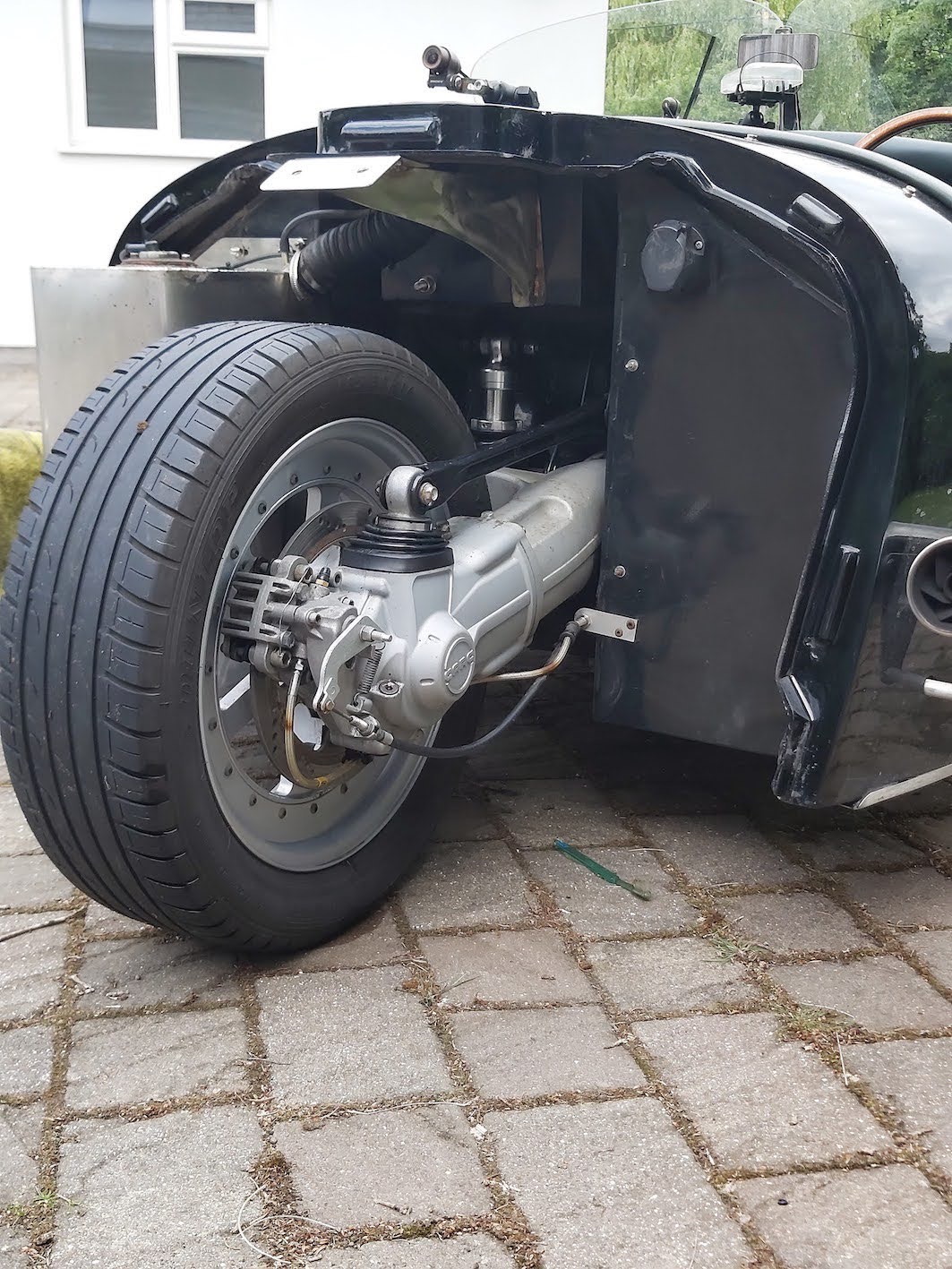

I can't say anything constructive about tyres for the carc models.
But, I am really impressed with that really clean, tidy rear end.
There are others that would claim the top accolade.
You must have a closely fitting innner rear mudguard.
Stay safe.
Stay safe.

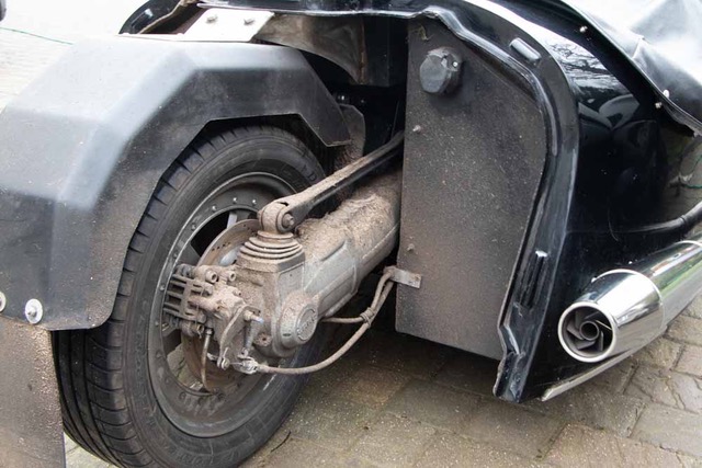

Thanks John, appreciate your thoughts. I have considered a Primacy, but am leaning towards a Conti UltraConnect to try, as it has A grade wet weather, but I will advise. Meantime Tony, my CARC back is protected by my factory fitted optional extra, see pic, which Alan fitted. It is a cheapo trailer guard with mudflaps front (to protect Hagon) and back. It hangs from two 17mm bolts on a small stainless subframe and works brilliantly. That said I am quite upset that you might consider my car clean so picture shows its normal state ready for potato planting!
Re: CARC rear tyre choice
Should add on the mudguard that I have very bad experiences with 'hugger' types mounted on swinging arm, when the CARC was in the original Norge donor. I have had at least four mounting brackets fail, the last and most dramatic went as the bike was accelerating hard up a hill in the Highlands and the hugger went around the wheel and ended up 100 yards back the way I had come. The scrape on the swinging arm is still there and luckily nobody was following. I did well to stay onboard. So the current mudguard arrangement allows suspension travel and fouls nothing. The mudguard plastic is soft and pliable too, so it should protect and break/bend if something bad happens.
