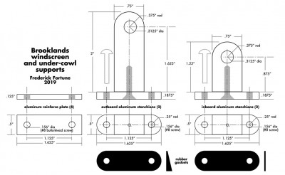

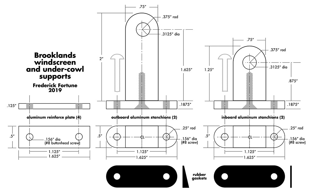

Post by frederick » Mon Jan 25, 2021 12:17 am
Out of the box they look a little flimsy so I came up with these.

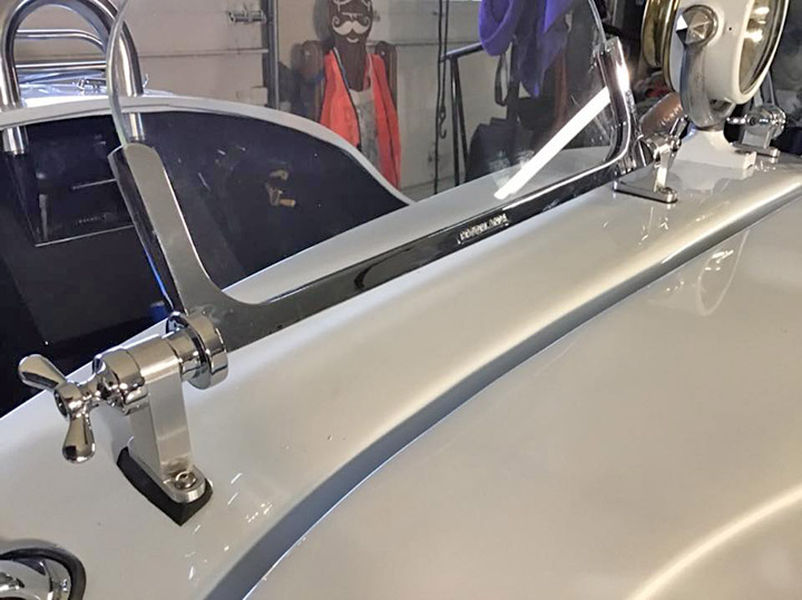

I’ve always like the look of Brookland screens and what you’ve done looks really great, I did think about going down that road when I was building my T3; however, because I like to do a lot of touring (sadly not at the moment) I I went the touring screen route, especially as the wife wanted a hood fitted😉. There’s been plenty of times when I’ve been happy that I did😀

Thanks! Another benefit is that the higher outboard pedestals help level out the windscreens a bit since the cowl is so curved.
