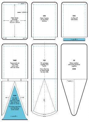

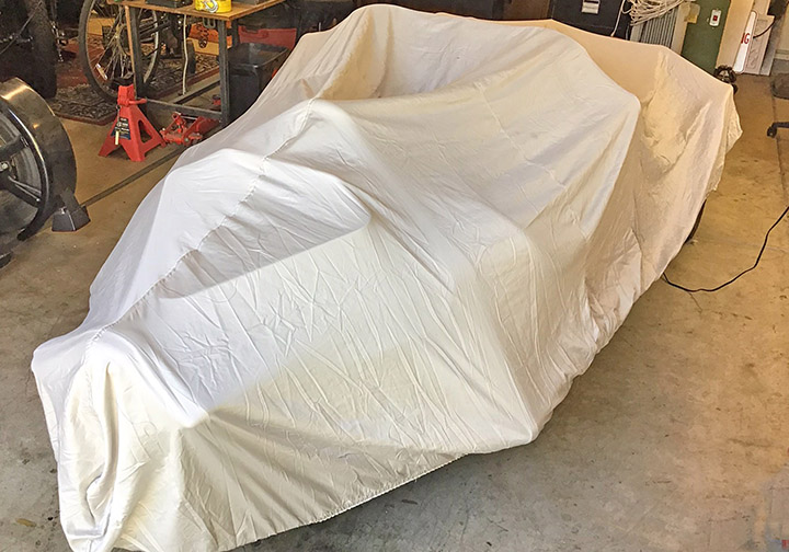

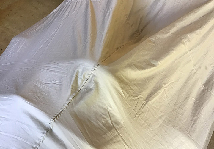

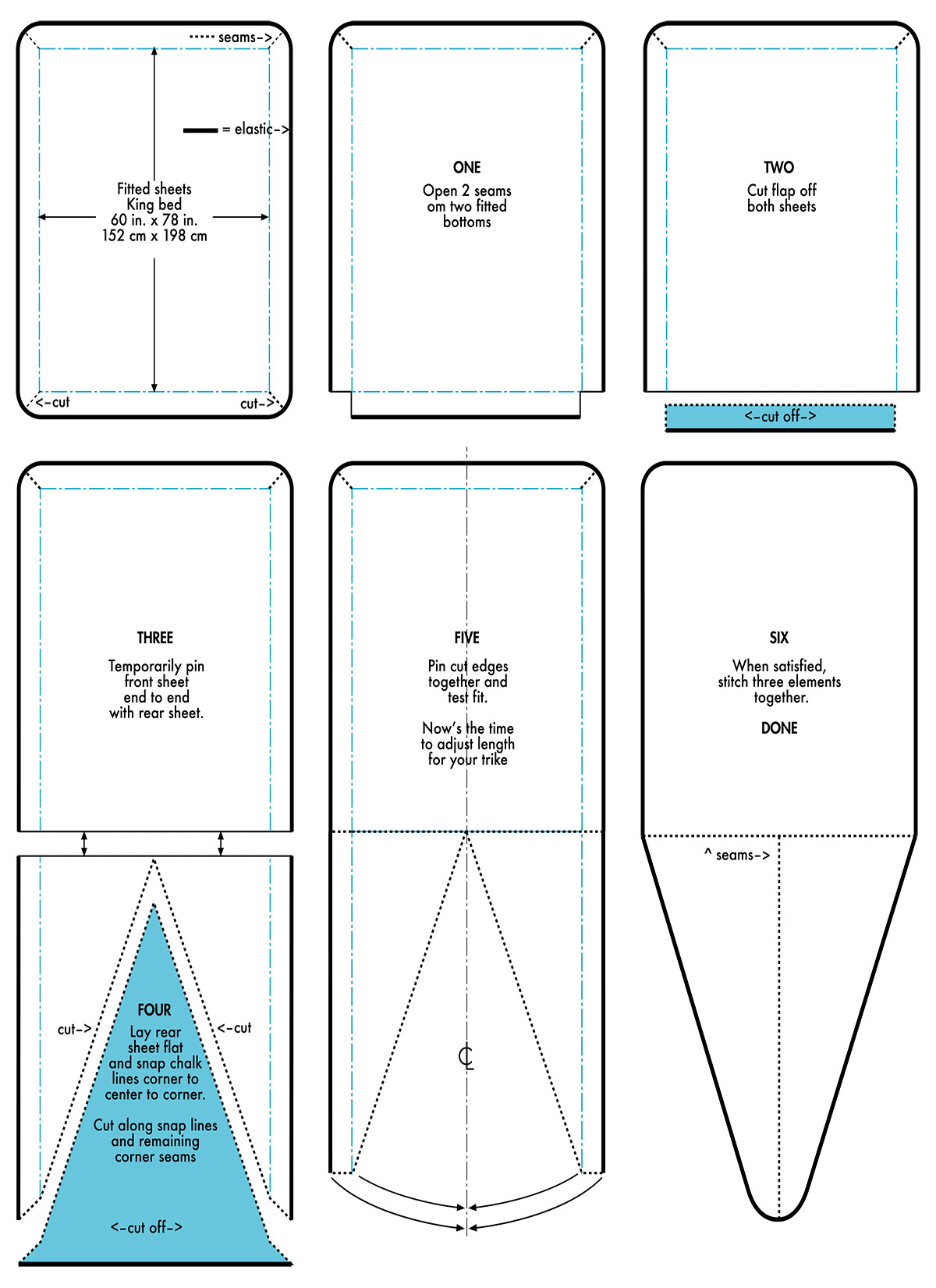

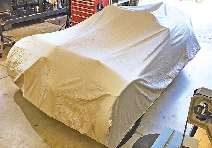

Dust covers for garaged trikes are hard to come by, when I first asked about one, someone suggested tossing a couple sheets over it.
Going one better I (with significant other's skillset) came up with the attached, combining 2 "King" (60 in. x 78 in. / 152 cm x 198 cm) fitted elastic bottom sheets.
You may wish to do yours more tailored, and out of different material (mink, leopard, etc.), but this is a place to start.
