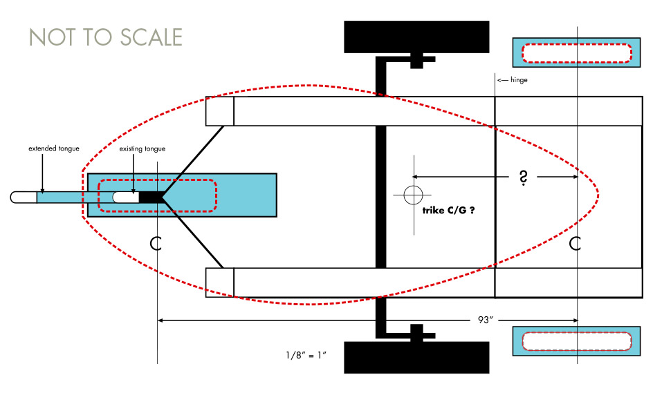

Not exactly custom, rather considering modifying a Kendon 2-rail fold-up.
the trike's CG over the centerline of the axle
Has anybody calculated the front/back balance point of a finished T4?
I thought there was some discussion on this but couldn't find it.
But where to position the cradles for the front wheels depends on gettingTriking CG/balance point for custom trailer

Re: Triking CG/balance point for custom trailer
From the old forum, based on measurements that Mark (archie) and I took :-
"Based on the average weight of the factory Type 4 cars built to date the empty centre of gravity point is. 1261 mm Aft of datum. The datum point is the front chassis cross rail tube.
With an “ average “ weight driver of 90 kg and 25 litre of fuel it is 1422 mm aft of datum.
With an average driver and passenger of 90 kg each and 25 litre of fuel it is 1501 mm aft of datum."

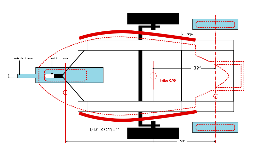

Turns out my guesstimate was close...here is a revised sketch: https://www.kendonusa.com/ so your mileage may very.
Kendon's specs list the 2-rail trailer's tongue weight 10-15% of the total loaded weight...so assuming the trike CG is over the trailer axle CG, tongue weight when loaded should be (400lbs trailer + 900-ish lbs trike = 1300lbs) 130-195lbs.
I do have two loading/tie-down questions...first: what is the height from the ground to the very rearmost underside of the tailpiece (to clear a bump-stop/wheel chock)?
Second: where on the T4 chassis rear underside left and right are the beefiest places to fasten permanent tiedown eyebolts?
thanks in advance!
Note I'm adapting an early rectangular tube fold-up model, later fold-up versions are round tube and expanded steel mesh deck: Kendon's specs list the 2-rail trailer's tongue weight 10-15% of the total loaded weight...so assuming the trike CG is over the trailer axle CG, tongue weight when loaded should be (400lbs trailer + 900-ish lbs trike = 1300lbs) 130-195lbs.
