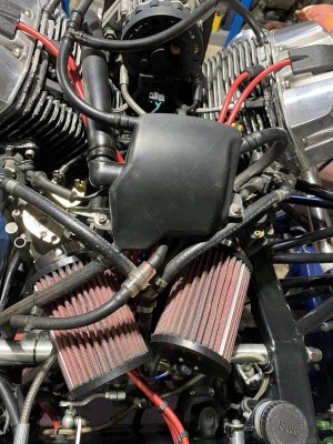

Has anybody made up new fuel lines to the injectors, I have a 1200 sport 2V engine ? The stiff plastic lines are bent to suit the fuel tank. I'd be interested to see what anybody else has done to their fuel supply lines.
The ideal would be lines to the injector, a tee piece and straight back for the line to the pump. with no stress in the line.
Photos would be appreciated. Thanks.

Post by Richard and Pat » Sun Apr 20, 2025 10:06 am
Hope this helps, if you need more let me know.

Re: Fuel lines to the injectors
Post by gogboy » Sun Apr 20, 2025 10:25 pm
That's great thanks.
Just one question. How did you manage to cut the plastic pipe off the injector fittings and tee piece without damaging the barbs?

Post by gogboy » Mon Apr 21, 2025 11:17 am
Hi again,
You'll be pleased to hear that I have managed to get the caps off the plastic pipe without any damage to the barbs.
I wrapped the heads in Al foil then heated them up very carefully with a small kitchen blowtorch until soft and the plastic pipe just fell off! Ill replace the tee with a metal one. Im also thinking of fitting a quick release fitting after the tee.
Onwards and upwards as they say.
