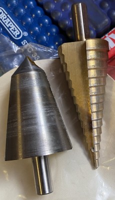

It is a good idea to put masking tape over the area you want to work on and always start with a small pilot hole. I have found the muti-drill specials very useful.
If you cover oversize the area you want to drill then use a compass and create the outside diameter required followed by a second circle inside leaving the gap the size of the drill in use for the chain drilling [e.g. 3mm] once complete use an Abrafile or coarse round/ rat tail file to join all the holes and finish as Tony says.
