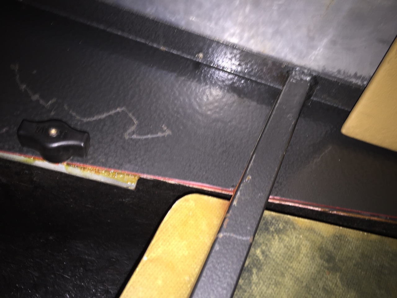

Who can advise good alternative to the long winded screws holding bonnet on?
Dzus would probably look best but seem problematic to install. There appear to be loads of alternatives available, so what have owners fitted and which ones work best?

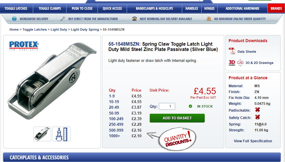

I used over-centre clamps on the Pembleton but don’t think they would look so good on the T4, unless you could mount them inside.
As the under-bonnet area is used for spares/tools stowage, the set screws seem reasonably secure. Would probably be even better with torx heads.

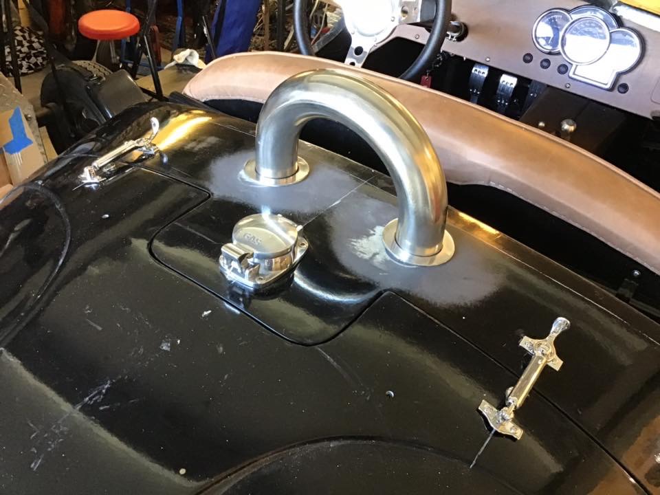

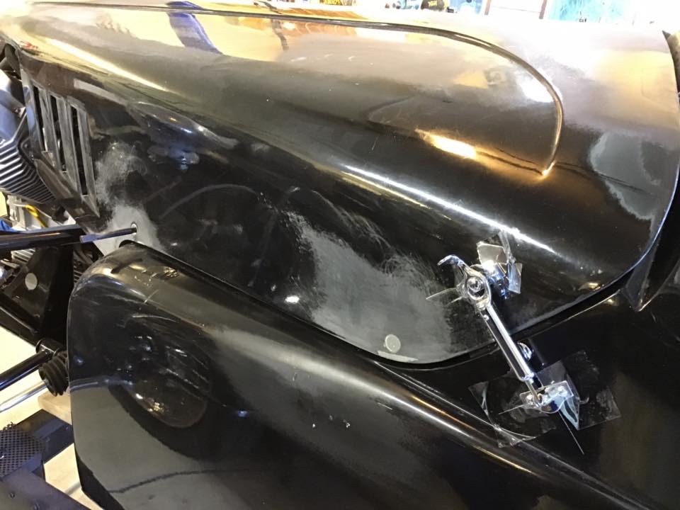

For a vintage look I’m using spring loaded hold downs...two bonnet rear, two deck lid top. Bonnet front and deck bottom I’m planning long threaded wing screws.

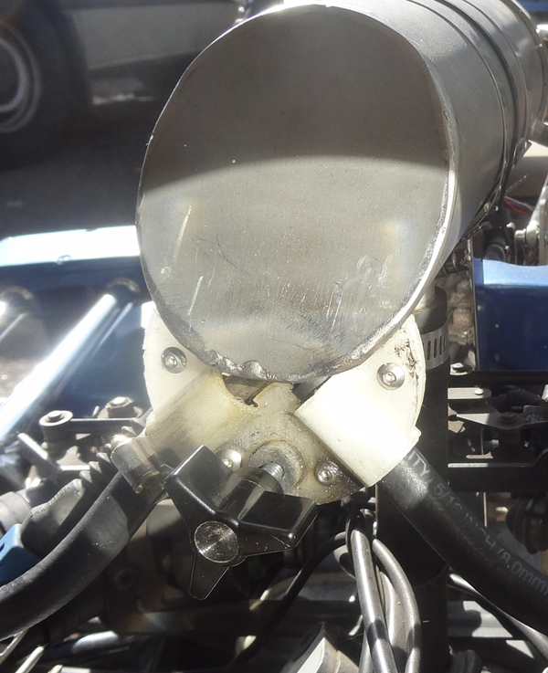

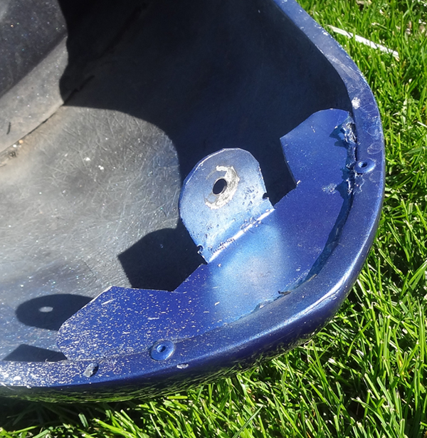

I didn't like the idea of the screws holding the bonnet down either, so at one point I came up with a complicated system whereby the bonnet opened up, rather than having to take it completely off, and it didn't involve screws at the rear, just metal tabs that slid under the fibreglass where the wipers are. The problem with this turned out to be that without the screws at the rear, the bonnet wouldn't stay flush at the sides without something physically forcing the sides in . Now I've gone the usual screws at the back, but at the front I made a bracket that attaches to the oil breather, and a bracket inside the bonnet nose, so that the front can be quickly undone by unscrewing a knob.
Having recently had various minor problems with blown fuses and suchlike, where I've had to remove the bonnet and find somewhere to put it without chipping paint off, I'm thinking of going back to the cantilever system, but also with the screws at the rear, although maybe some more metal tabs will be enough to keep the sides of the bonnet in at the back- we'll see.......
