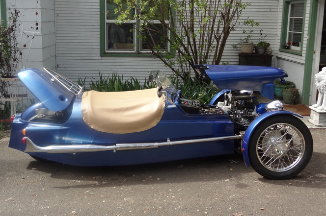

I didn't like the idea of the screws holding the bonnet down either, so at one point I came up with a complicated system whereby the bonnet opened up, rather than having to take it completely off, and it didn't involve screws at the rear, just metal tabs that slid under the fibreglass where the wipers are. The problem with this turned out to be that without the screws at the rear, the bonnet wouldn't stay flush at the sides without something physically forcing the sides in . Now I've gone the usual screws at the back, but at the front I made a bracket that attaches to the oil breather, and a bracket inside the bonnet nose, so that the front can be quickly undone by unscrewing a knob.
Having recently had various minor problems with blown fuses and suchlike, where I've had to remove the bonnet and find somewhere to put it without chipping paint off, I'm thinking of going back to the cantilever system, but also with the screws at the rear, although maybe some more metal tabs will be enough to keep the sides of the bonnet in at the back- we'll see.......

Slick! Solves where to put the “bonnet” when you take it off. How’s access to the motor’s fiddly bits?

Frederick - access to the engine is good, although so far, fortunately I've had zero problems with it (I've put 2500 miles on a donor that had 21000 miles )
