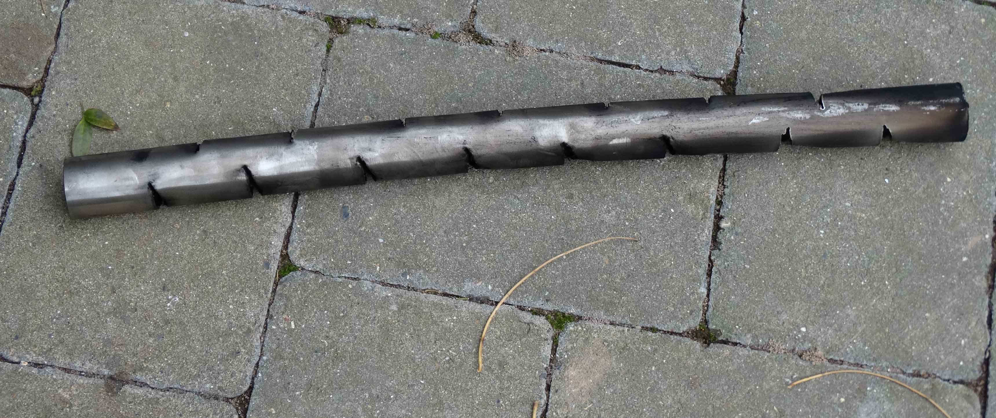

I had a problem with my exhausts, you may care to read through the topic I just copied from the old site entitles Back to Dellorto carbs.

thanks for that...unfortunately the pics didn't stick with your text.
You spliced in a baffle at the head end of each pipe? That's a trick we Harley guys use to put some back pressure in for straight pipes, but the motor is still trying push out that long column of gasses each exhaust stroke. I'm just wondering if a shorter "tuned' pipe is going to help the stock motor breathe better. For kicks I just wrote these guys: http://www.ghezzi-brian.com/en/tuning-m ... t-systems/ asking the optimum length for a 1200 Guzzi 1.75" dia header and silencer. We'll see if they answer.

Found a picture of the home made baffle.
