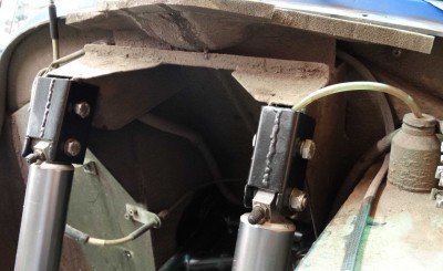

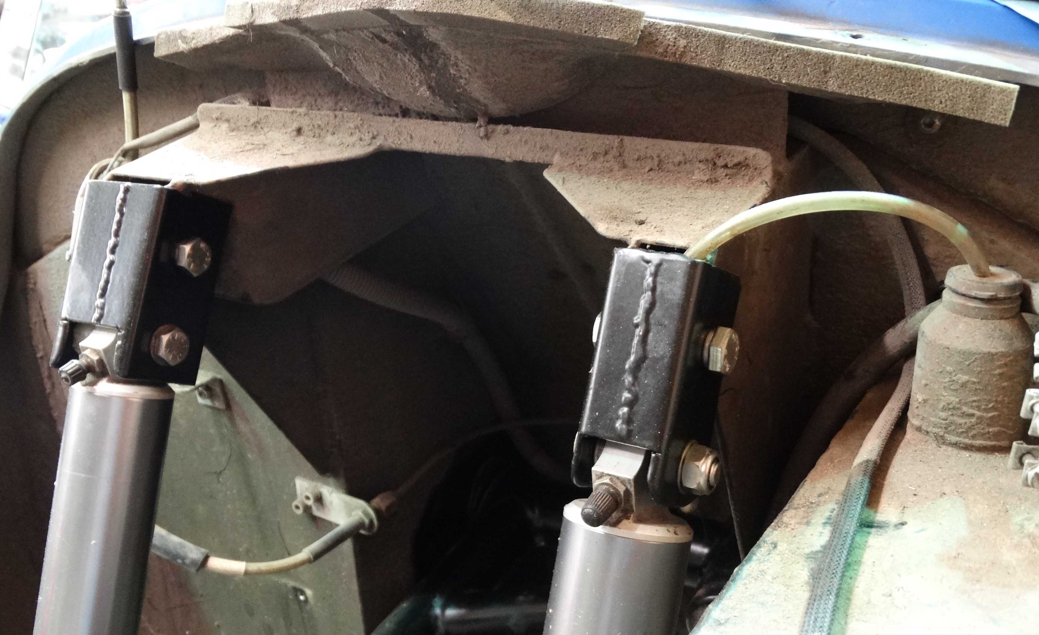

Looking back to 2013 on my first build, the rear shockers were Hagon 340 long, which I believe was the standard kit issue from Triking. (Also standard on the Calli). I had the same problem, grounding at the rear.
As mentioned by Peakrock Dave, the ‘comford upgrade’ has 400 long.
My solution to raise the rear with the 340’s is the freshly painted bracket in the picture.
(Shockers fitted in picture are Fornales.)

Post by Dave » Wed Oct 25, 2023 1:20 pm
Many thanks for the fix , will try that first. Dave.
