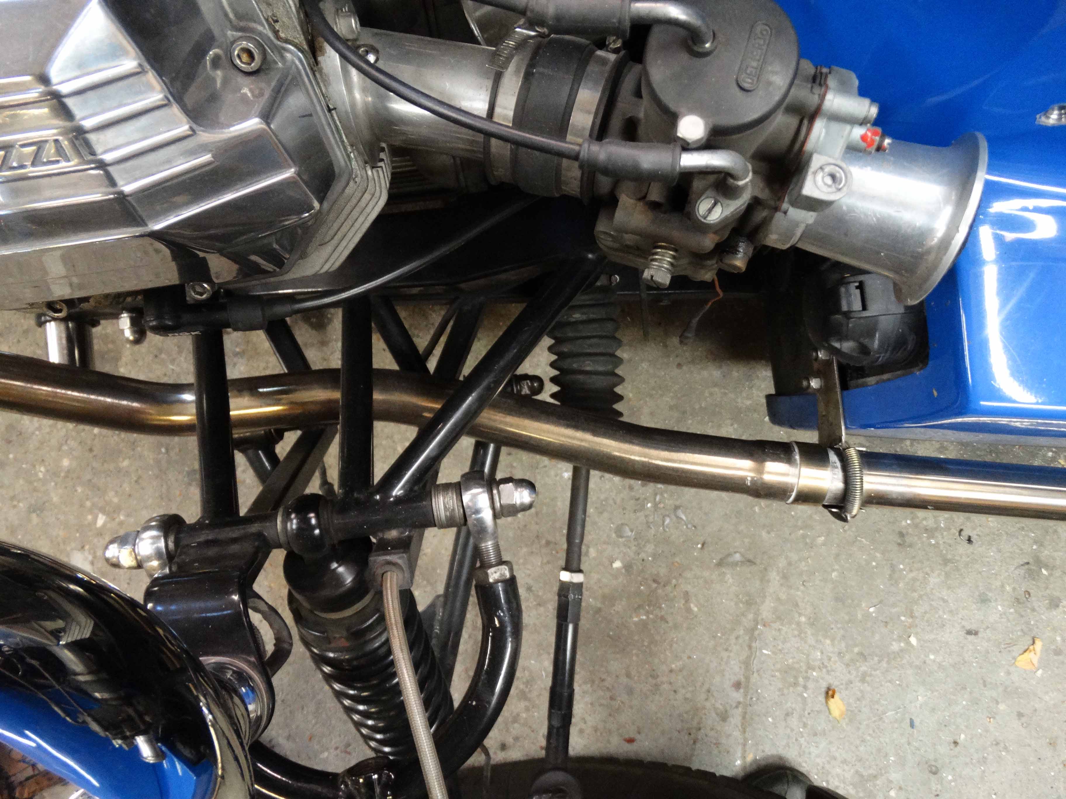

I did away with the balance pipe as it was the first thing to hit the ground going out of my driveway.
That also got rid of the expansion boxes, bit of a problem area anyway!

I don't know how Tony/WEG gets his motor running so well without a balance pipe! I've found Guzzis to be a bit harsh and stumbly in the midrange and at idle without the balance pipe and have been unable to tune this out. And equally as bad with a Jota-style large diameter balance pipe. Clearly I don't have Tony's skills :-(
Incidentally, older flat twins are even worse without the balance, and are also improved by using a balance pipe across the intakes.
