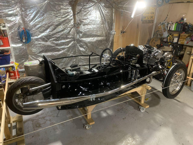

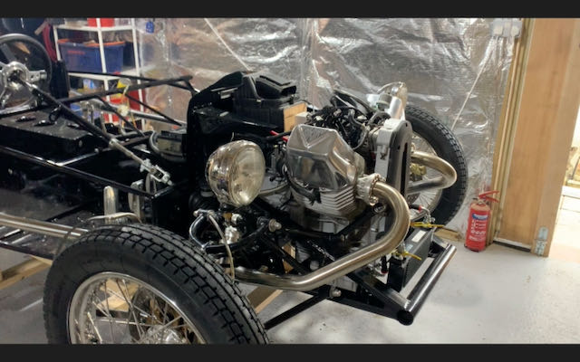

Here you go, if you want anything specific just let me know.
One was when I set up the suspension (just a rough setup prior to putting on the ground to do it properly with body / interior etc, in).
The other was when I started the engine today. If you look closely at the front of the engine you'll see an oil pressure sensor. Thats not its final location!!
