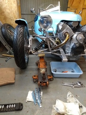

Post by peakrock » Sun Apr 11, 2021 11:27 am
I bought a pair of 130/70 x 18 Michelin Road Classic from MyTires in the end and fitted them to the rims. These replace the Michelin Pilots. A bit of a job when they're cold and stiff but they went on ok. Here's a pic during the balancing process, I think I have enough wheel weights don't you... :lol:
Driving report will follow once they're worn in...
